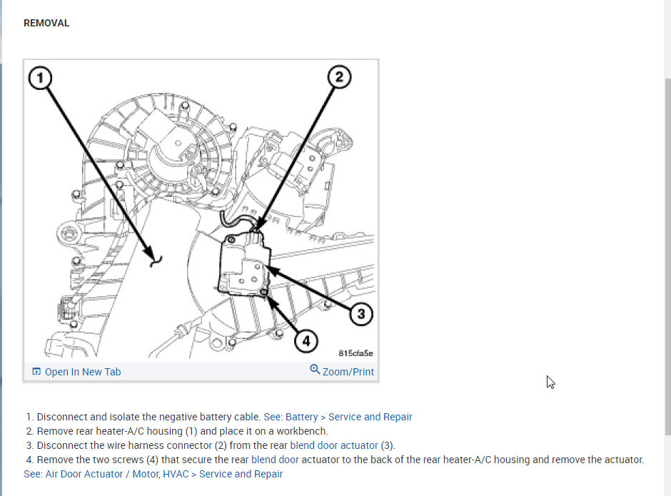

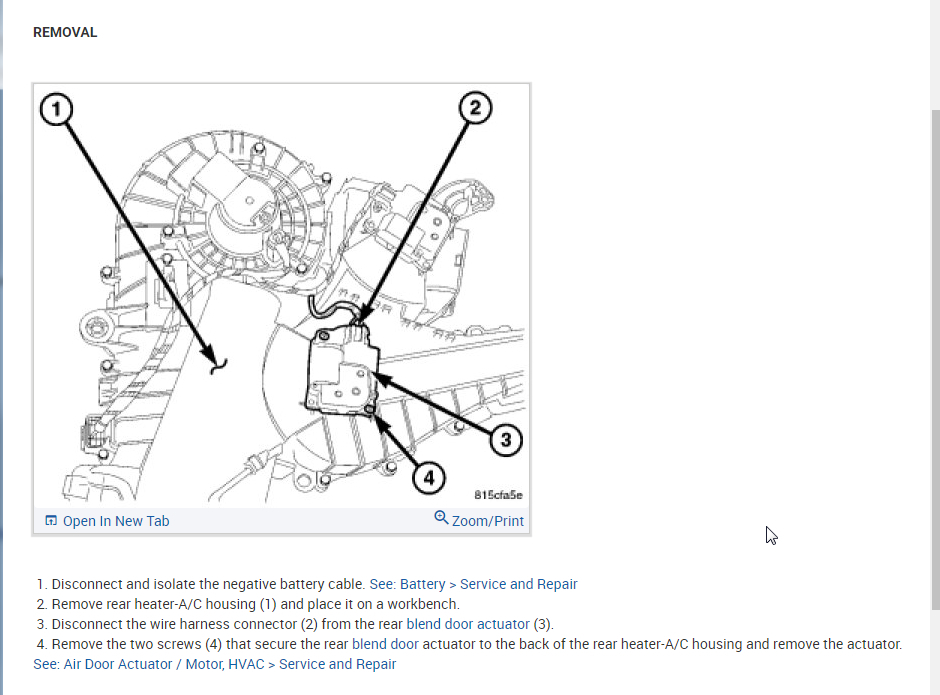

I want to ask you about my car I have the van listed above and the car not warming the back. Can you help me with a recommendation that I can use or do to fix it ?
I had changed the motor and all off the cooling system.
Feb 4, 2021 at 10:14 AM

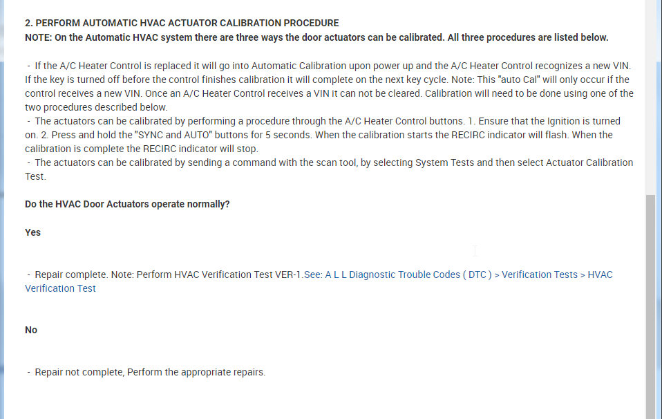

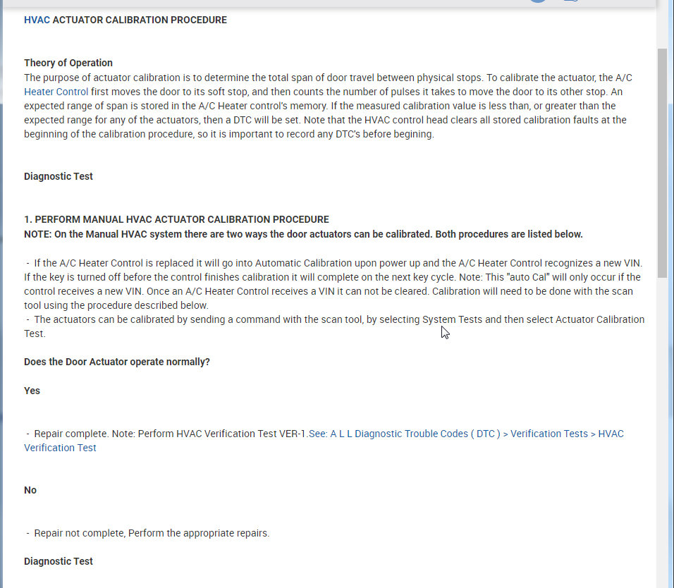

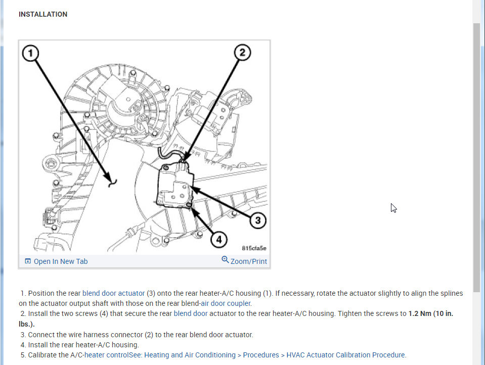

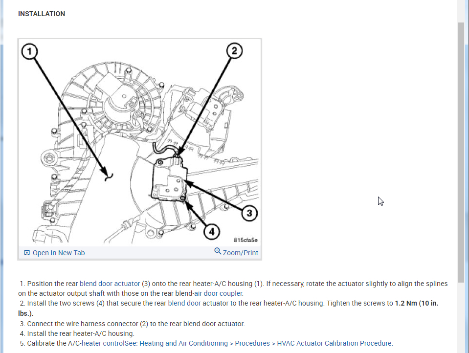

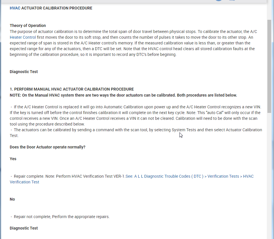

You are most likely correct that the blend door for the rear system is not operating.
Here are some guides that will help with this issue. They are centered around the front controls but the idea is the same.
https://youtu.be/SNRb6pSwYuU
https://youtu.be/Eqf-H3COtSo
Below you will find the detail on how to remove, install, and calibrate the actuator. Let's run through this and let us know if you have questions. Thanks
