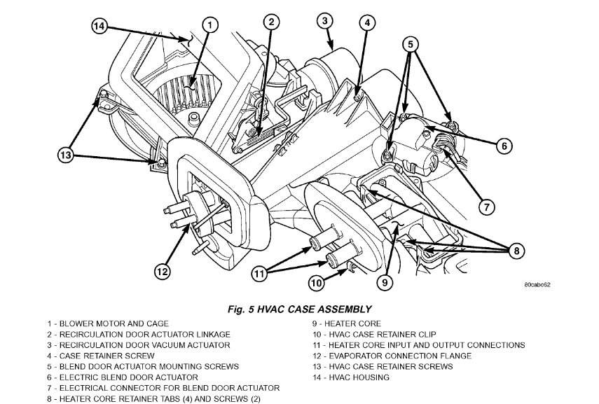

Heat blows warm after engine is warm but only for a few seconds then cold. However, if you move the temperature knob to cold it will blow hot for a few seconds. So to have heat you have to constantly move the temperature knob back and forth.

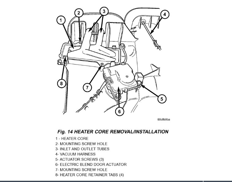

It sounds like the blend door actuator is trying to move but is not responding to your commands. The actuator is a very common failure for this issue.
The dash board has to be removed to gain access to the motor. It is on top of the heater case. Once the dash is removed, it can be changed.
You should have someone confirm this before assuming it is the issue but from your description, it sounds like this may be your issue.

Fig.14 Heater Core Removal/Installation
3. Remove the screws that secure the blend door actuator to the top of the HVAC housing.
4. Remove the blend door actuator.
INSTALLATION
1. Install the blend door actuator in place.
2. Install and tighten the screws that secure the blend door actuator to the housing. Tighten the mounting screws to 2.4 (± 0.34) Nm (21 (± 3) in. Lbs.).
3. Install the HVAC housing into the vehicle.
4. Install the blend door actuator electrical connector from the wiring harness through the glove box.
5. Connect the battery negative cable.
REMOVAL
Warning: on vehicles equipped with airbags, disable the airbag system before attempting any steering wheel, steering column, or instrument panel component diagnosis or service. Disconnect and isolate the battery negative (ground) cable, then wait two minutes for the airbag system capacitor to discharge before performing further diagnosis or service. This is the only sure way to disable the airbag system. Failure to take the proper precautions could result in an accidental airbag deployment and possible personal injury.
1. Disconnect and isolate the battery negative cable.
2. Remove the instrument panel from the vehicle. Refer to: Body and Frame, Interior Trim, Dashboard/Instrument Panel, Service and Repair, Instrument Panel Assembly Replacement, See: Dashboard / Instrument Panel > Removal and Replacement > Instrument Panel Assembly
3. If the vehicle is not equipped with air conditioning, go to Step 6. If the vehicle is equipped with air conditioning, recover the refrigerant from the refrigerant system. Refer to Heating and Air Conditioning/Service and Repair/Procedures See: Heating and Air Conditioning > Procedures
Fig.5 HVAC Case Assembly
4. Disconnect the liquid line refrigerant line fitting from the evaporator inlet tube. Refer to Hose/Line HVAC/Service and Repair/Procedures See: Hose/Line HVAC > Procedures
5. Disconnect the accumulator inlet tube refrigerant line fitting from the evaporator outlet tube. Refer to Hose/Line HVAC/Service and Repair/Procedures See: Hose/Line HVAC > Procedures. Install plugs in, or tape over all of the opened refrigerant line fittings.
6. Drain the engine cooling system.
7. Disconnect the heater hoses from the heater core tubes. Install plugs in, or tape over the opened heater core tubes.
8. Unplug the HVAC system vacuum supply line connector from the engine side harness.
9. Remove the nuts from the HVAC housing mounting studs.
10. Remove the HVAC housing from inside the vehicle taking care not to allow any remaining coolant to drain on the vehicles interior.
