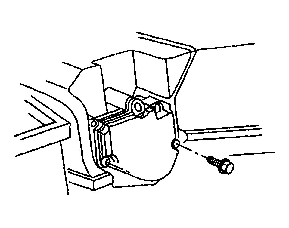

heater blend door actuator location
1998 GMC TRUCK
115,369 MILES • V8 • 4WD • AUTOMATIC
AOVINC
this one's location at the blower motor on the passenger side.

Here are the directions for the air temp actuator. The attached pic correlates with the directions. If this isn't what you needed, let me know. Also, here is a link showing in general how one is replaced:
1998 GMC Truck K 1500 Truck 4WD V8-5.7L VIN R
Vehicle Heating and Air Conditioning Air Door Actuator / Motor Service and Repair Procedures Temperature Actuator Primary A/C System
pic 1
Remove or Disconnect
1. Negative battery cable.
2. Roll instrument panel forward.
3. Electrical connector.
4. Screws.
5. Actuator.
Adjust
A. Electrical connector to the actuator.
B. Turn the ignition key to the run position and let the actuator position itself.
C. Turn off the ignition key.
D. Remove the actuator from the electrical connector.
Install or Connect
1. Actuator.
2. Screws.
3. Electrical connectors.
4. Instrument panel compartment.
5. Negative battery cable.
- Check circuit operation.
