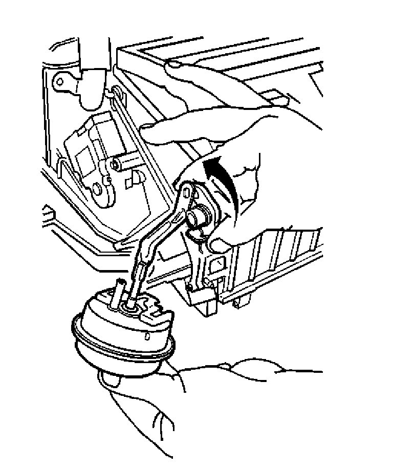

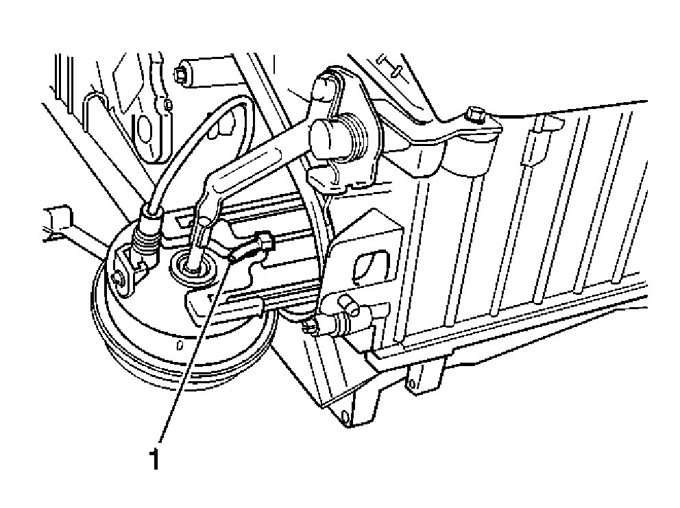

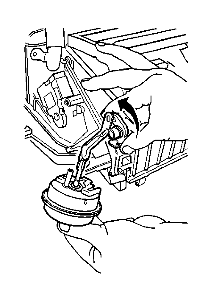

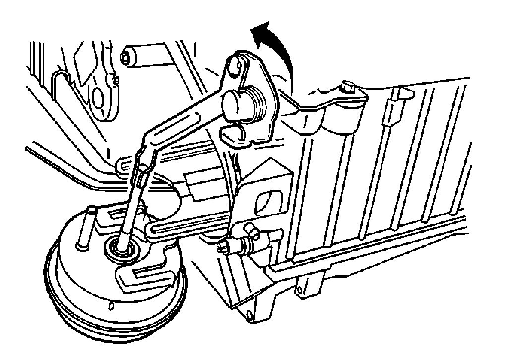

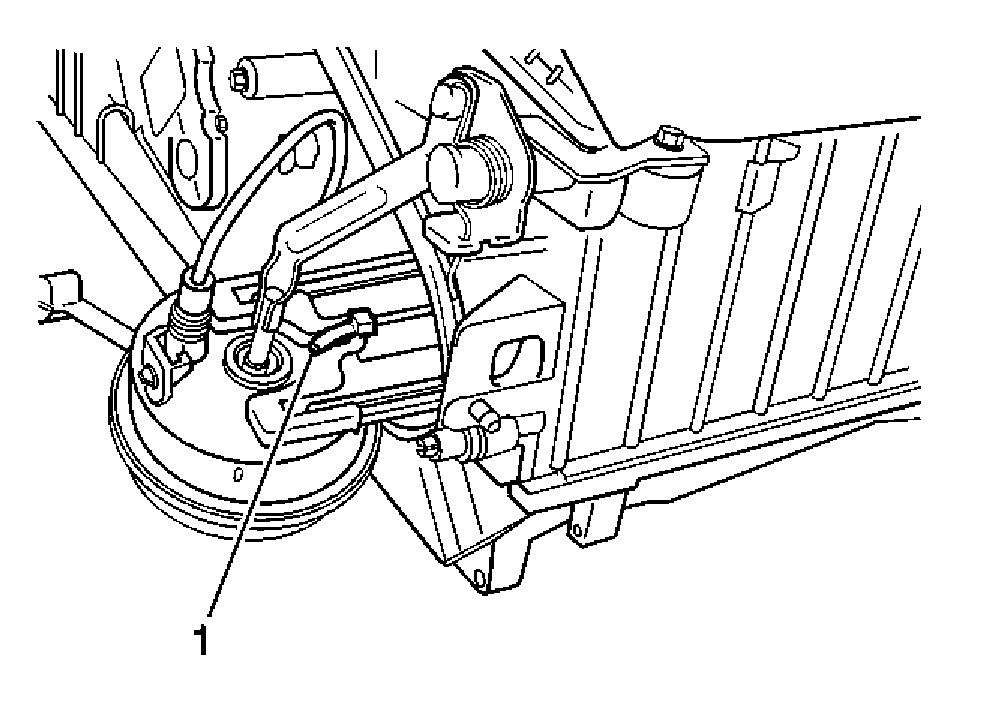

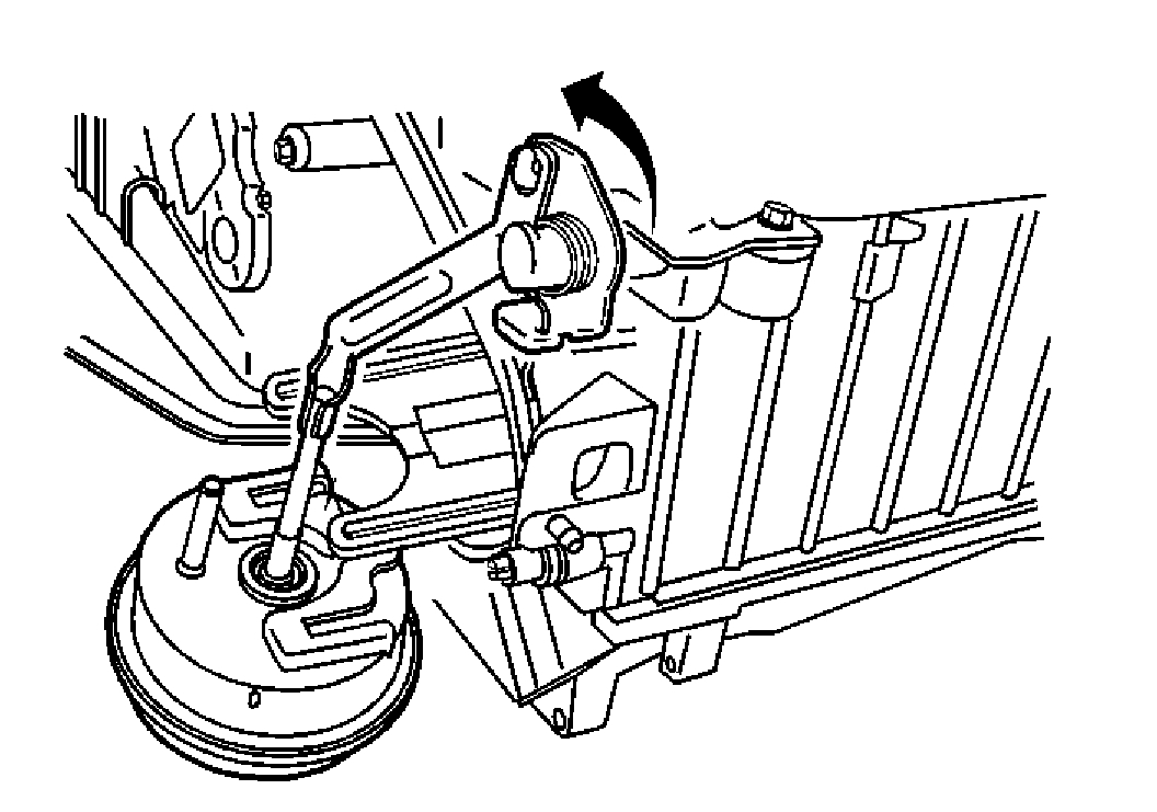

I have heat and blower motor is working but heat is coming straight out at me and will not shift to the defrost or the floor.

It sounds like the mode door actuator has failed. The actuator in this vehicle is vacuum operated, so before replacing the actuator, make sure vacuum is getting to it. The actuator is responsible for air flow direction.
Here are the directions for replacing the actuator. Again, that is the first thing I recommend checking. Make sure vacuum is available to it. The vacuum comes from the engine to the panel and then the actuator, so there could be an issue at a different location. The attached pictures correlate with these directions.
______________________________
MODE ACTUATOR
REMOVAL PROCEDURE
1. Remove the left instrument panel (IP) insulator.
2. Remove the IP knee bolster bracket.
3. Disconnect the support clip for the ignition switch harness.
4. Disconnect the vacuum line from the mode actuator.
5. Lift the lock tab up (1) to remove the actuator.
6. Remove the mode actuator off the slides of the HVAC module assembly.
7. Disconnect the actuator pushrod from the mode door lever and remove the actuator.
