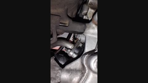

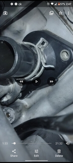

Is this the heater tube? Does it need a new gasket? Do I need to replace the thermostat? I'm losing coolant somewhere and this looks like it might be it.

Did you mean to attach a picture? I'm not sure what pipe it is you are referring to. As far as the heater is concerned, there are heater hoses that attach at the firewall, under the hood. There are two, a supply and a return.
As far as a leak, if you are unsure where it is coming from, the system should be pressure tested. You will need a tester, but most parts stores will lend one to you.
Here is a link that explains how it's done:
https://www.2carpros.com/articles/radiator-pressure-test
Let me know where you are seeing the leak, how much is leaking, and if you meant to attach a picture.

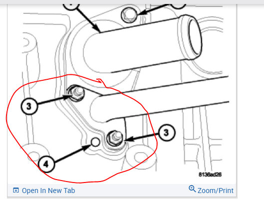

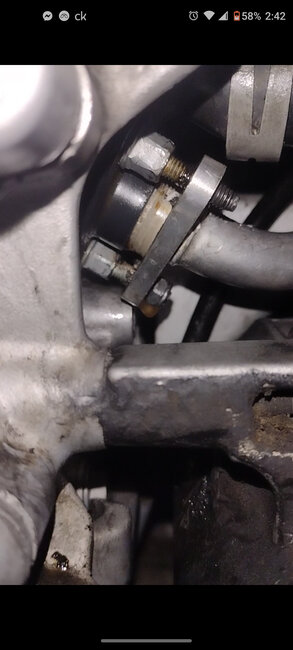

I can't seem to get the right bolt out. I can't even get the right angle to even loosen it. Is it normal to be leaking where it is or is there another issue I haven't found yet?

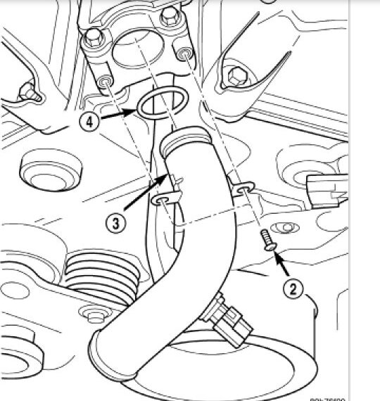

That appears to be the leak. There is an O-ring in there that has likely failed. That is referred to as the coolant outlet tube.
Looking at the video, the nuts appear to be accessible. What are you using to remove them?
See pic below.

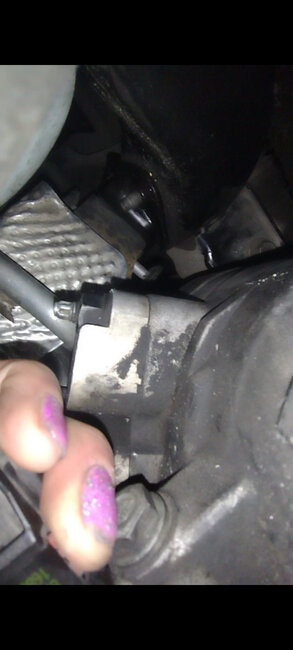

I finally got it loose, but it won't cover completely off. Maybe it's not supposed to. But I can't get the thermostat out now.

It should be removable. The problem is there is little room to work. Have you been able to identify if the gasket/o-ring is damaged?
As far as the thermostat goes, you need to remove the heater tube. Have you done that?
See pic below.

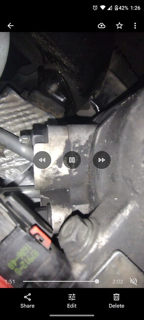

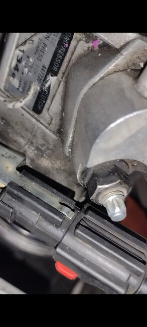

It definitely discharged from the top connectors. Maybe they loosened when I was lowering it. I don't know but A lot of Freon came out. Should I be worried?

Don't be worried. However, I do need to know which connectors. If they leaked, they would likely need to be replaced. This will require the AC system to be vacuumed and recharged. Based on the connectors, we may also need to add PAG oil to the system.
Take a pic of where you saw the leak and upload it for me to see.

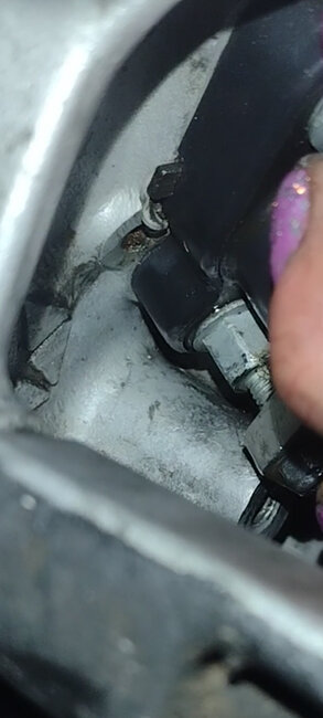

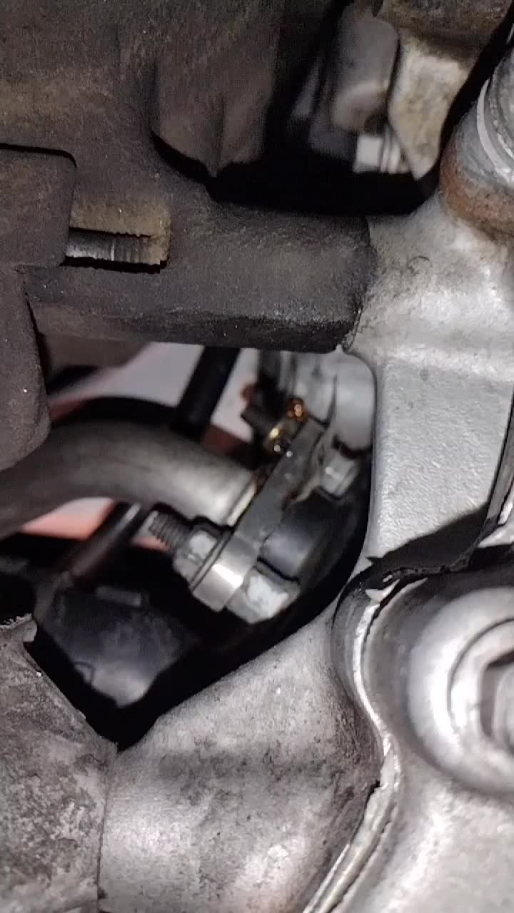

They are the two on the top of the unit. See pics

That appears to be right at the compressor. The second pic above is a video, but I'm unable to play it.
If the two connectors you indicated leaked, first make sure the steel tubing wasn't damaged. If they are good, then there is an o-ring on each one that will need to be replaced.
Once that is done, you will need to vacuum and recharge the system. While the system is vacuumed, you can turn off the vacuum pump and allow the vehicle to sit. If there is a leak in the system, you will lose the vacuum.
