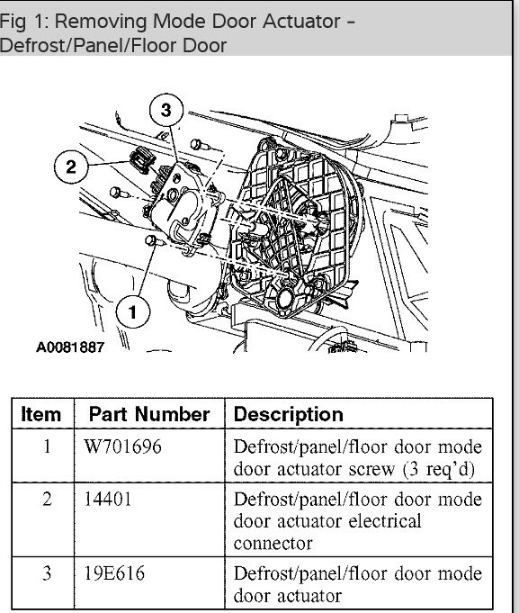

I have a 2005 Ford free star van the AC is coming up threw the defrost and not the dashboard vents
Thursday, June 15th, 2017 AT 11:09 AM
HMAC300
  • 48,601 POSTS
Y pulling hvac fuse inside car with key on for 60 seconds it may reset the actuator. If not you'll have to check for a bad actuator which is in center of dash. However if auto temp control a mechanic should scan this to see if something else. See piic
