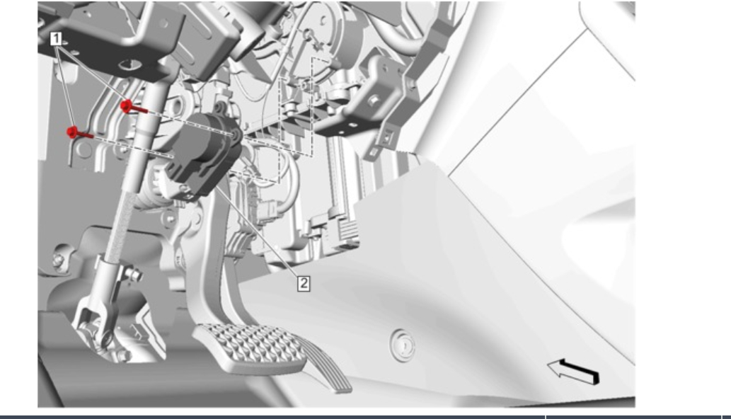

There is a mode door actuator that controls the blend door. That may be the issue but with it being new it must be a defective part. Here is a guide to walk you through the steps and a diagram below to show you on your car.
This guide can help as well
I attached a picture of the location and the procedure. Please get back to me.
Dec 24, 2018 at 9:05 AM
Any update? I attached some information for you.
