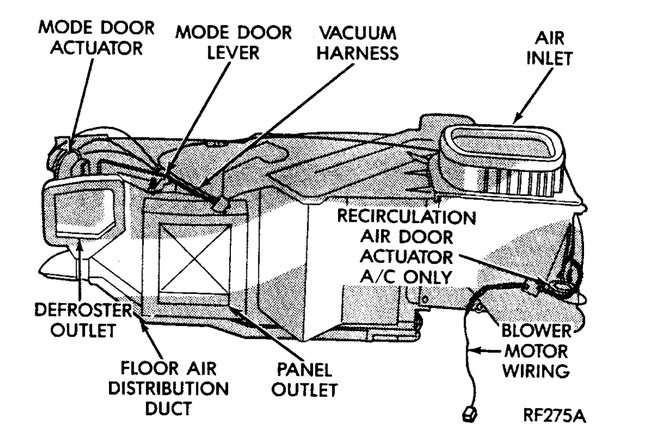

Good morning,
This requires a full dash removal to access the heater housing to remove it just to get to the heater core itself.
https://www.2carpros.com/articles/replace-heater-core
It is an involved job and there are no real short cuts for making the job easier.

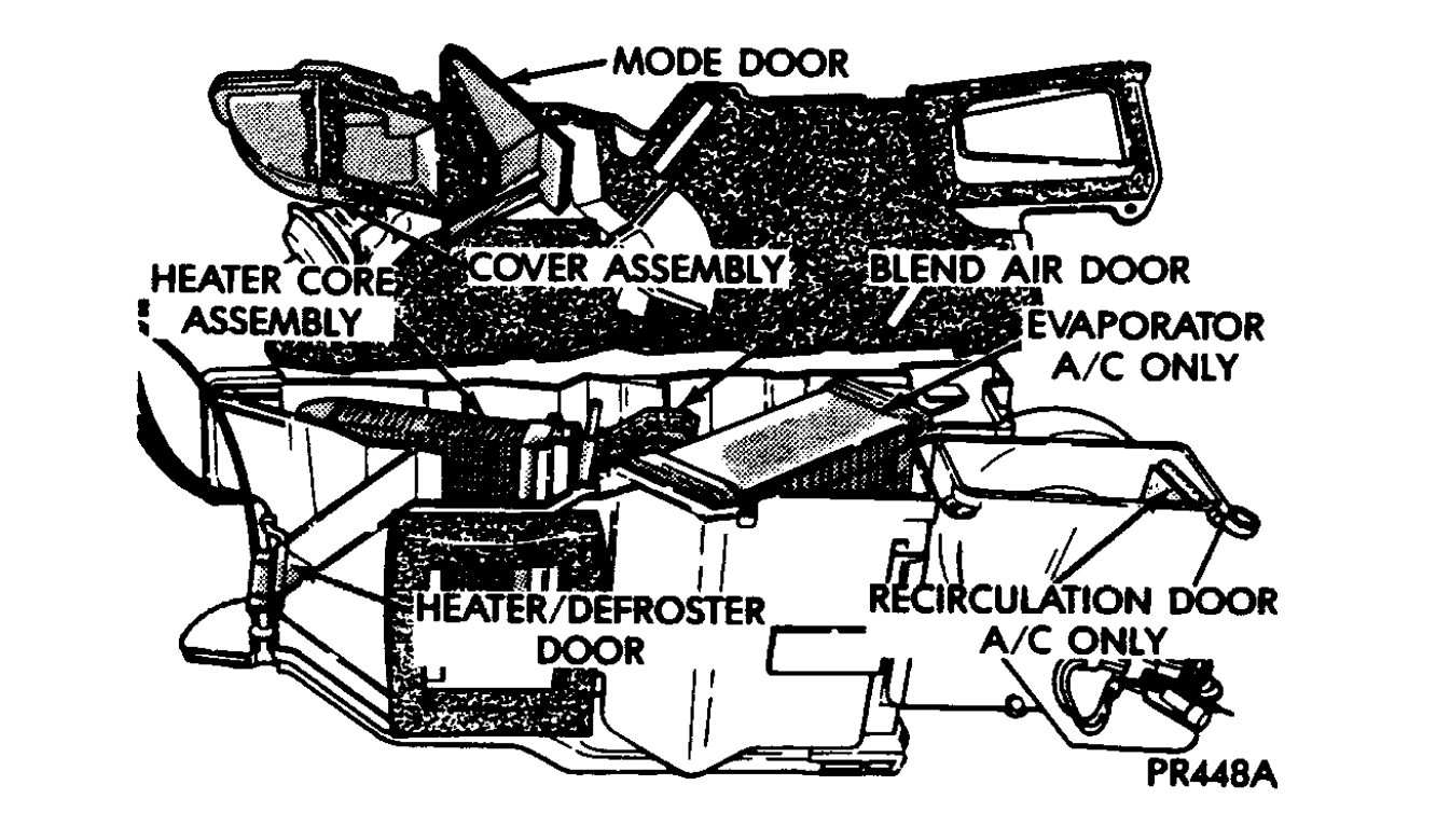

REMOVAL
1. Remove the heater-A/C housing. Refer to: "Housing Assembly HVAC : Service and Repair" See: Housing Assembly HVAC > Service and Repair
2. Place the unit on a work bench and remove the housing top cover.
3. Remove the attaching screw from the heater core retaining bracket and lift the heater core from the housing.
INSTALLATION
1. Position the heater core in the heater-A/C housing.
2. Install and tighten the attaching screw to the heater core retaining bracket.
3. Install the housing top cover.
4. Install the heater-A/C housing. Refer to: "Housing Assembly HVAC : Service and Repair" See: Housing Assembly HVAC > Service and Repair

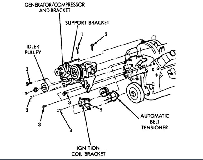

Thermostat
1. Disconnect battery ground cable, then drain coolant to below thermostat level.
Fig. 22 Alternator Support Bracket
2. On models with A/C, remove alternator support bracket, then partially remove alternator for access to thermostat.
3. Remove upper radiator hose at thermostat housing.
4. Move wiring harness behind thermostat housing out of the way.
5. Remove thermostat housing bolts, then housing, thermostat and gasket.
6. Reverse procedure to install with housing FRONT stamp pointed toward vehicle front. Tighten all bolts to specifications.
