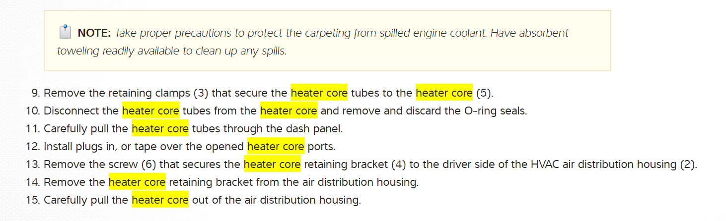

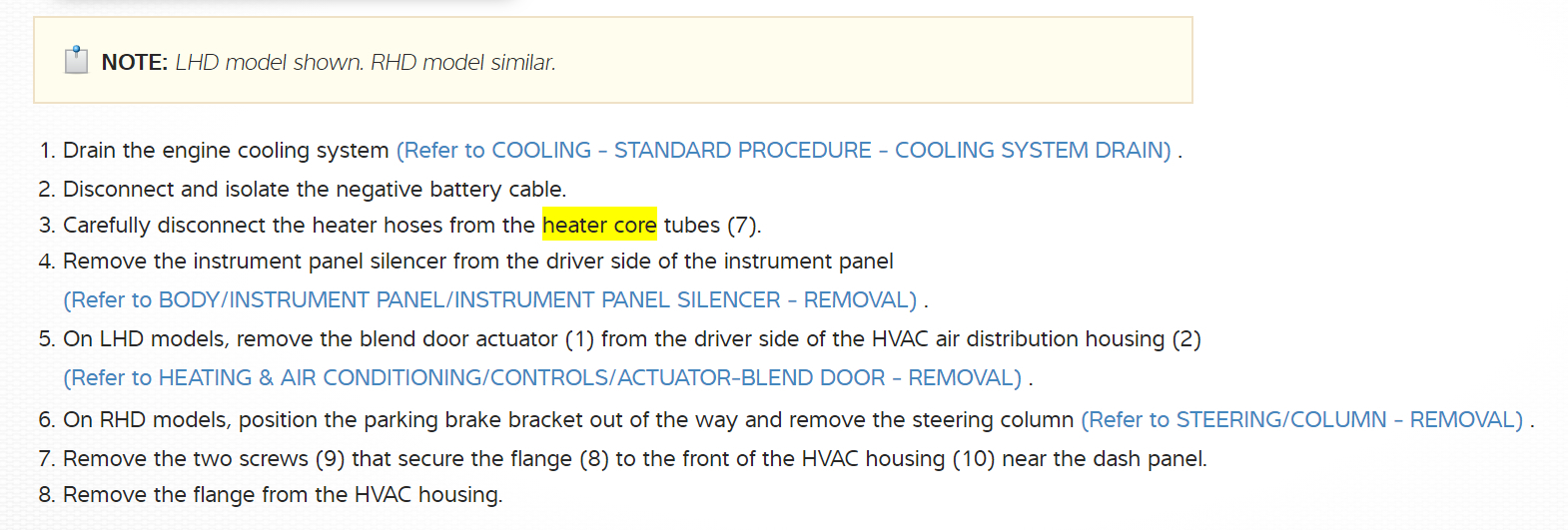

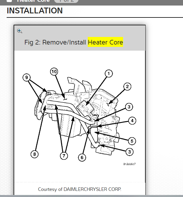

Getting two different answers online so far. End the debate? 2006 Chrysler 300c Hemi 5.6L - Where is the heater core? No, the question is, does the dash need to come out to replace the heater core? I've read that this model 2006 and up, that the dash does not need to be removed. However, dash needs removal for the evaporator. Please and thank you.

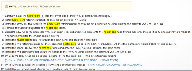

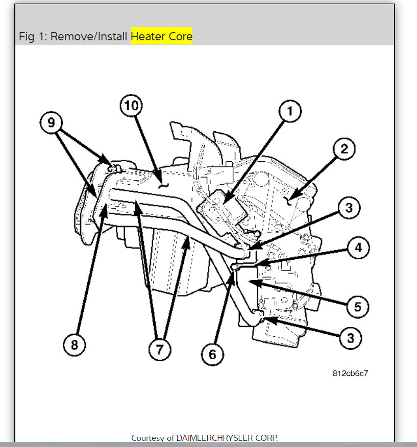

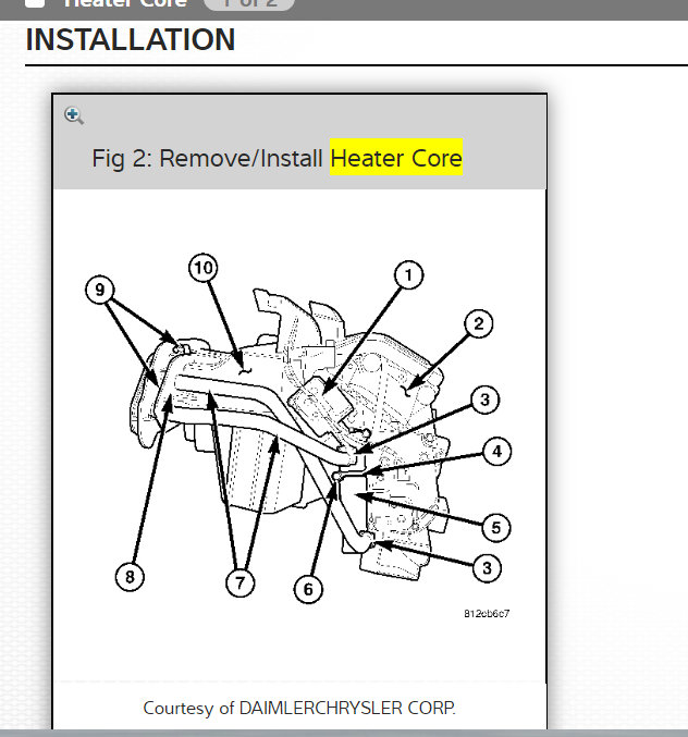

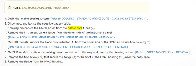

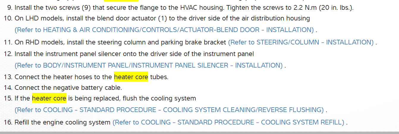

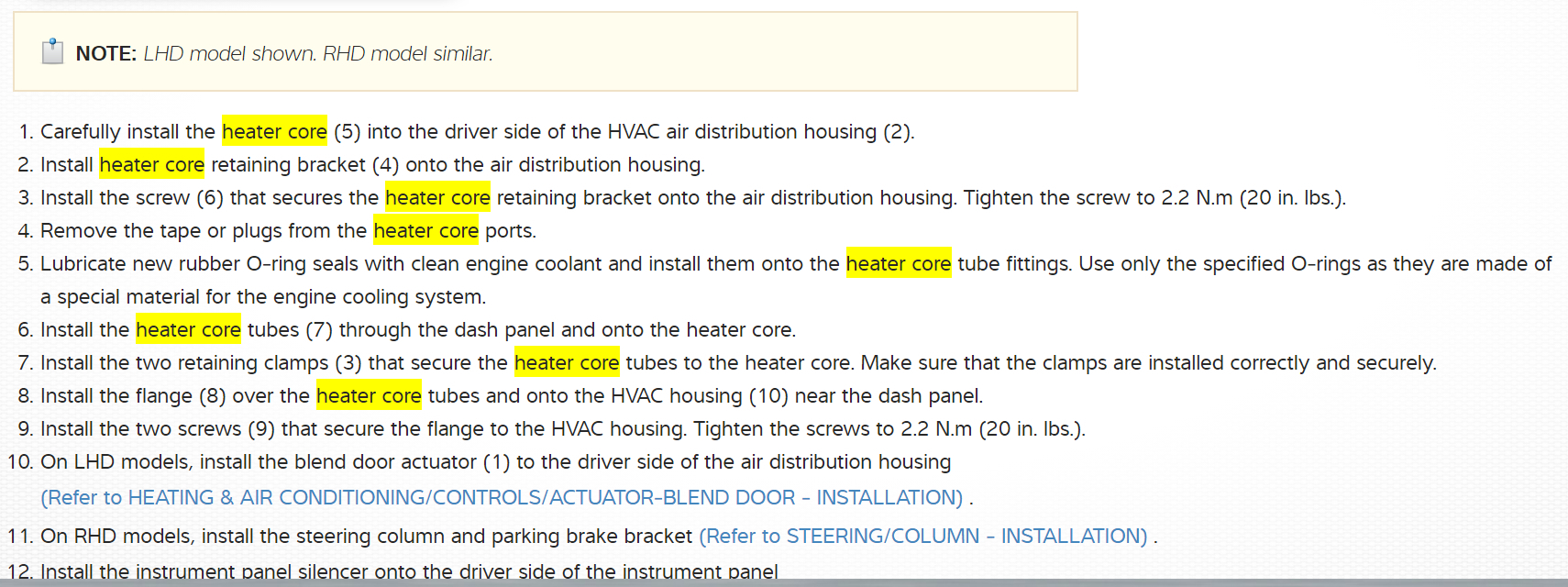

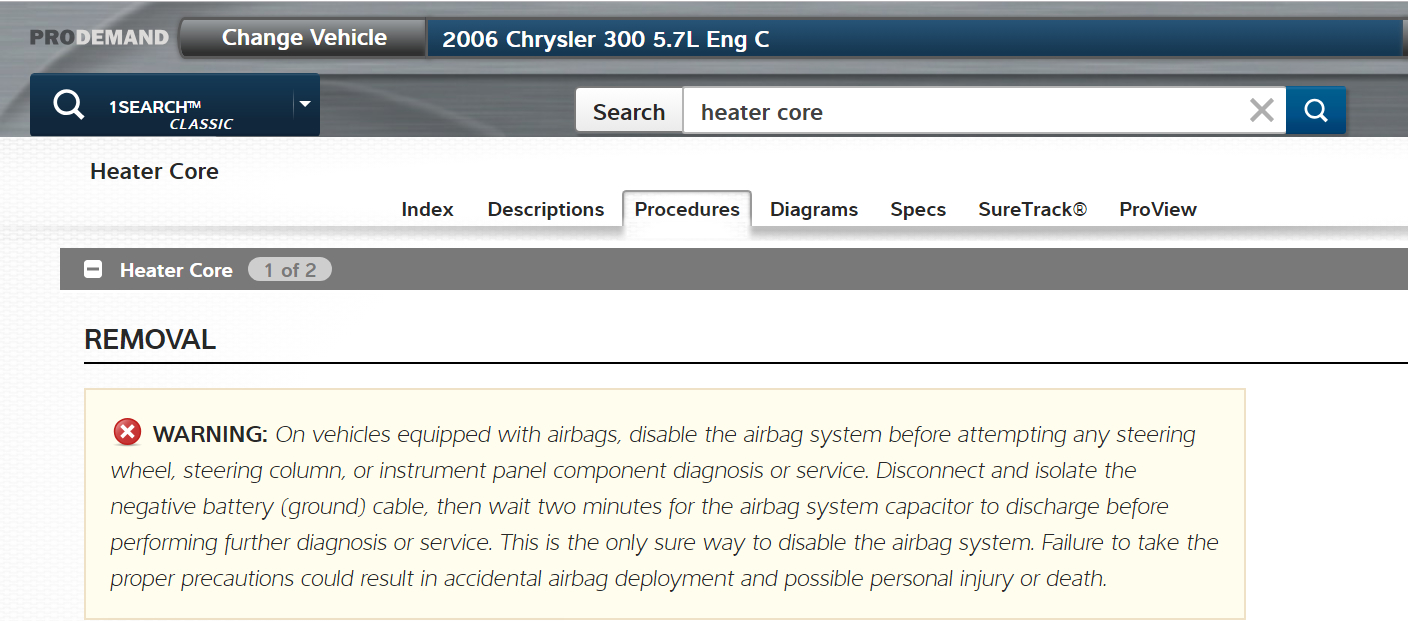

I have included both the step by step instructions for removal and installation in the diagrams below. These instructions are from the vehicle's manufacturer, so it should end any debate that you guys are having. Please let us know if we can help in any other way.
