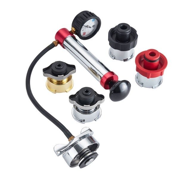

You will then need to refill with coolant and pressure test the system for any leaks. I will add a picture of this tool. It can be rented at your local auto parts store and is also available online. This will also help force coolant into the entire cooling system eliminating any air bubbles.

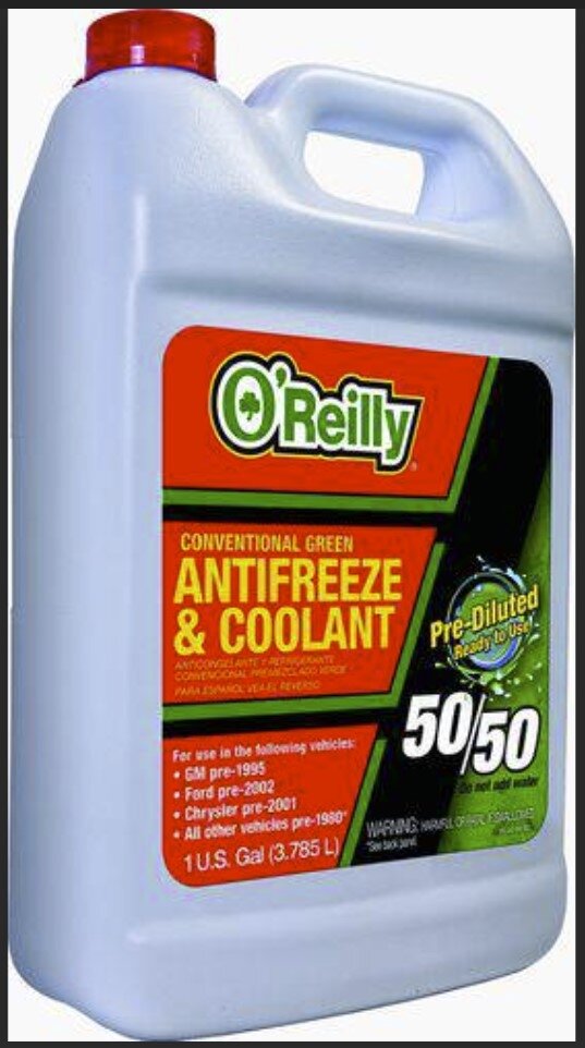

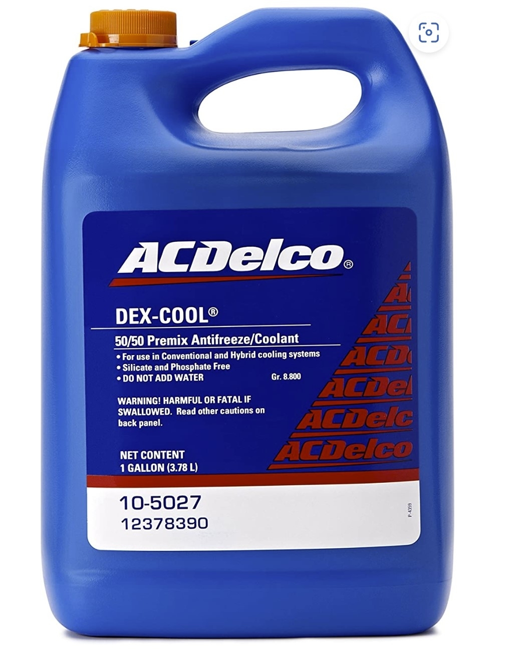

On thing to note: Chevrolet's take a special type of coolant called DEXCOOL. There was a Technical Service bulletin or a recall, I can't remember, where this coolant was replaced with regular green 50/50 mix.
If your coolant is pink, it is imperative you continue to use the DEXCOOL, if it is green then use the green 50/50 mix but never add green coolant to pink coolant or vice versa.

Your vehicles coolant capacity is approximately 6.9 quarts. So, I would get 3 gallons of 50/50 premix and return what you don't use.
