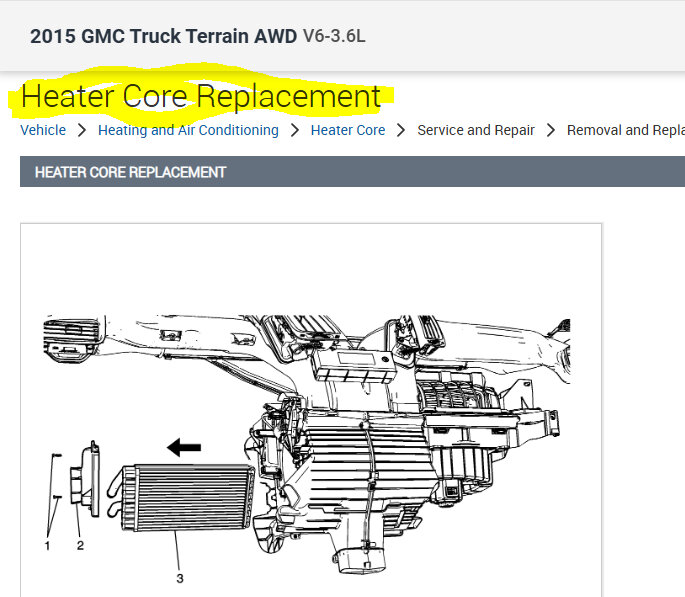

How to access the heater core.
Dec 6, 2024 at 11:42 AM
  • 110,194 POSTS

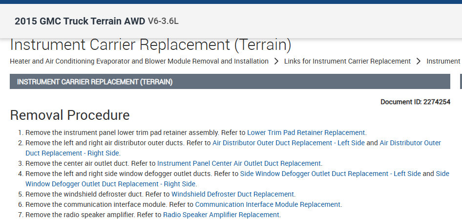

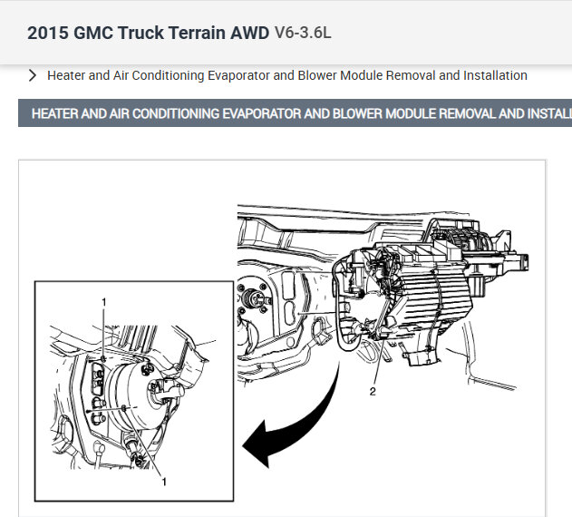

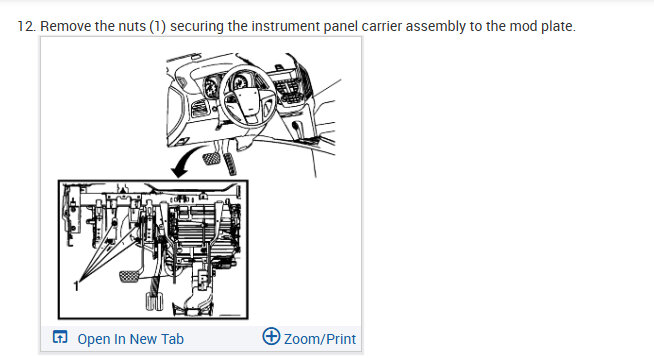

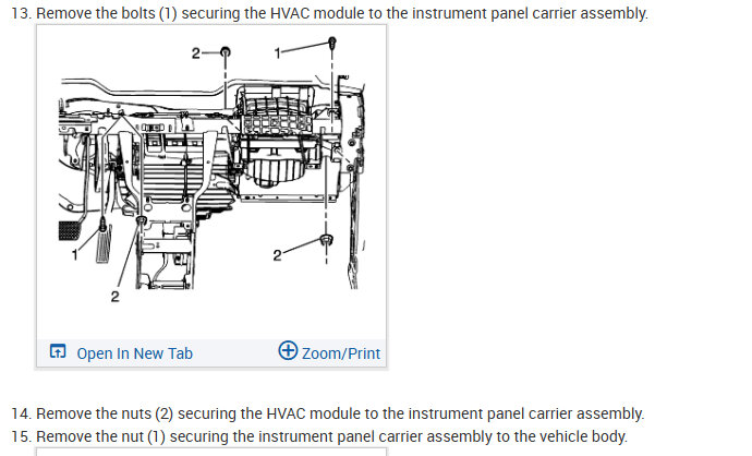

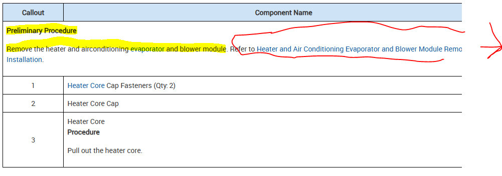

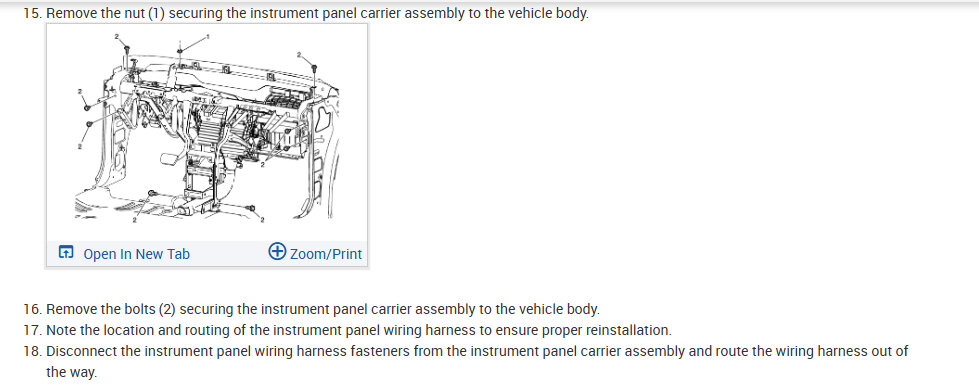

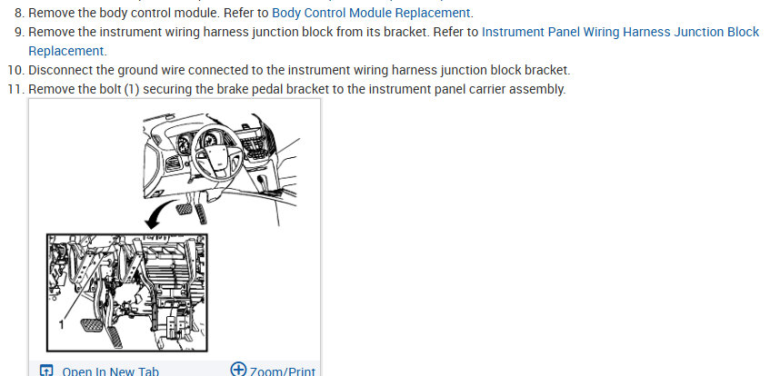

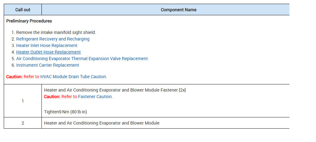

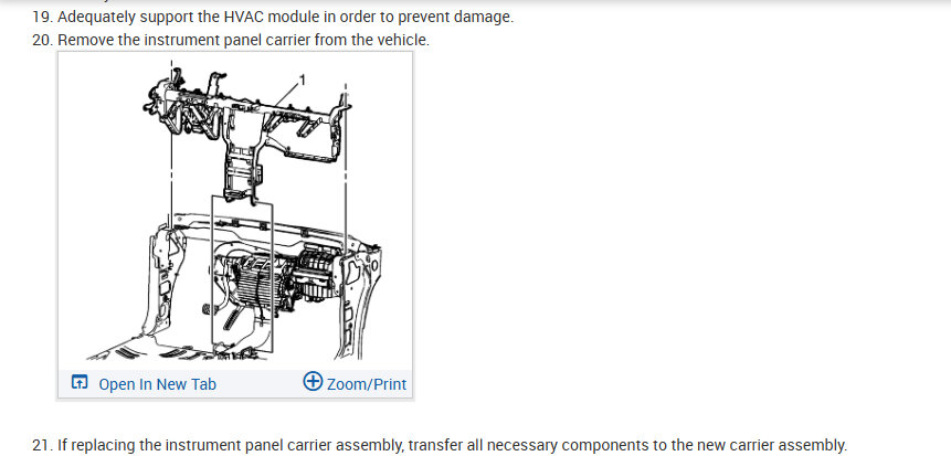

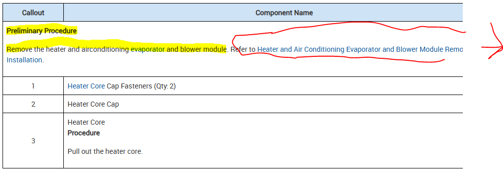

To access the heater core on this vehicle is a somewhat big job. The HVAC evaporator and blower module assembly needs to be removed first.
To do that, you will need to drain the coolant, recover the AC freon from the system, remove the ac evaporator, and the dash carrier assembly.
If you look below, I attached the directions. Take a look and let me know if you have questions.
