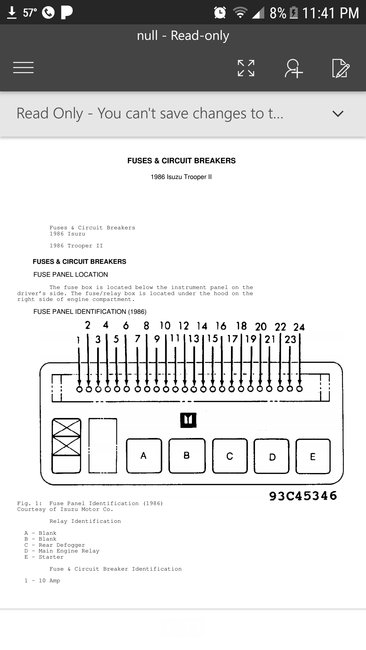

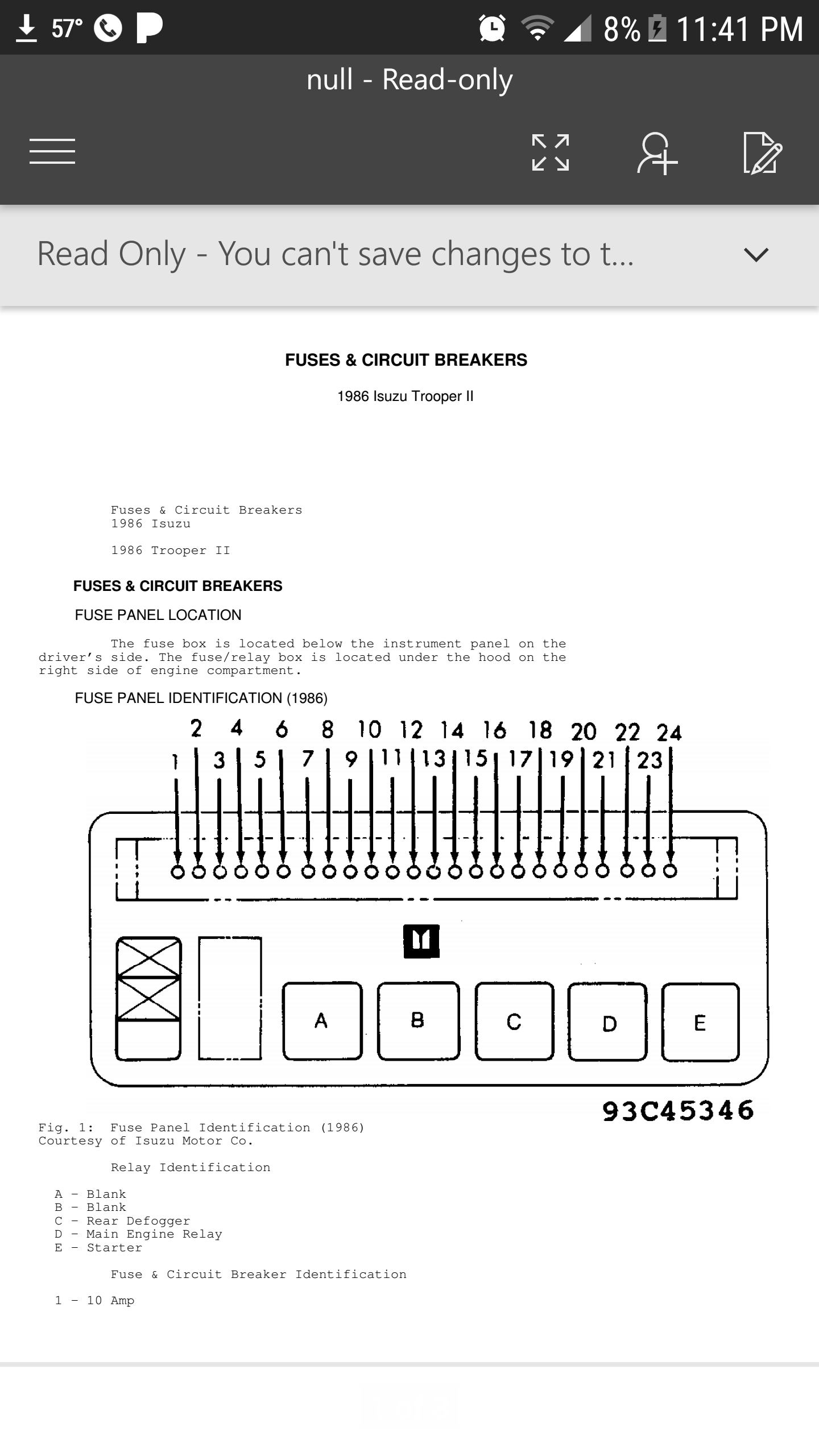

The fuse number is six, and I tested the fuse with a light and there is nothing I turn the car on and turn the heater control arm my blower fan is not spinning either. I took the blower fan out connected it to my car battery and it is spinning. I took the control temperature switch or whatever you call it out and replaced it with one from my parts truck even though it is a difference switch because it does not have the AC control, it is still not working.

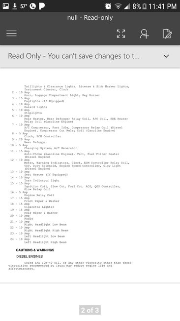

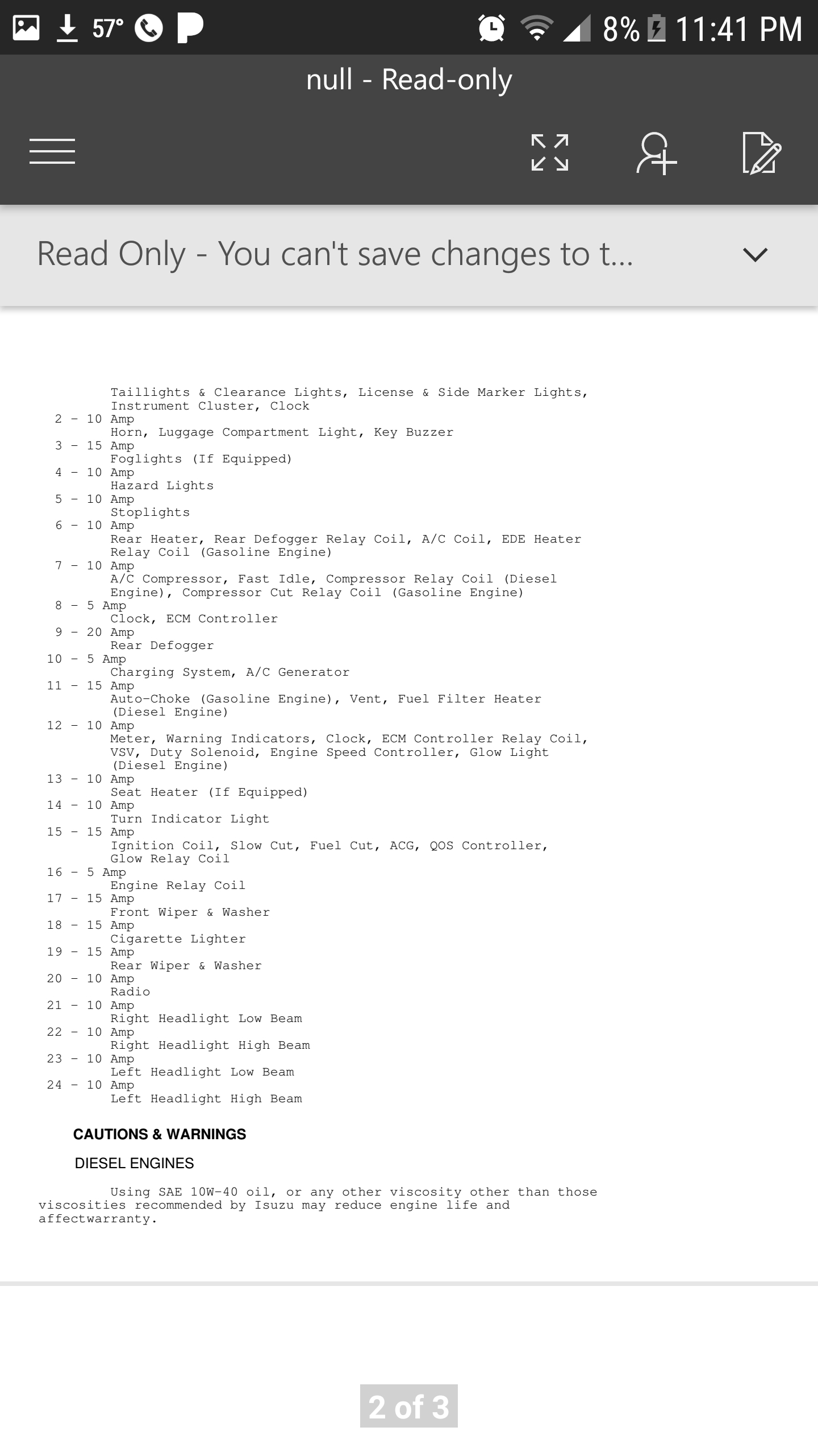

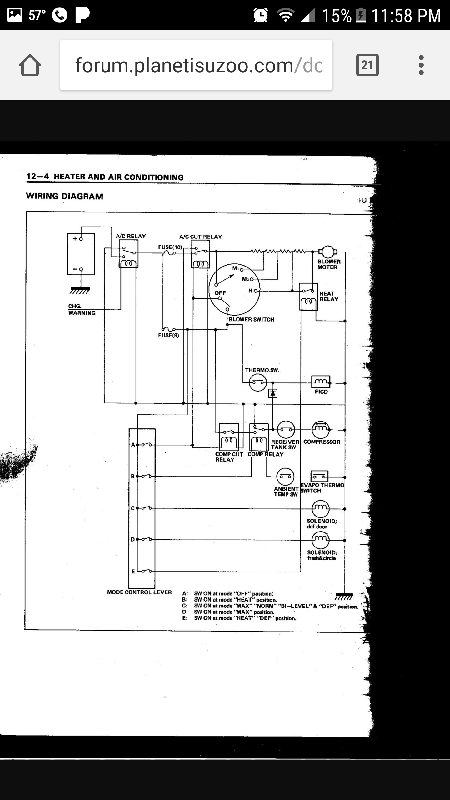

So it looks like six is the rear heater, but I do not see anywhere on this diagram or on my fuse box that says it is for the heater.

Do your warning lights work? Check for voltage on fuses ten and eleven. Those are tied right to fuse six. If all three fuses are burned out, look at the "engine relay" under the hood. From what I can see on the diagram, that relay only feeds those three fuses, and really has nothing to do with the engine.
I will be back tomorrow to see how you are doing.

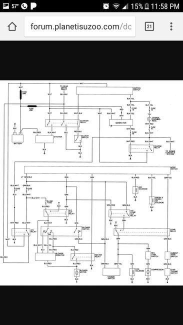

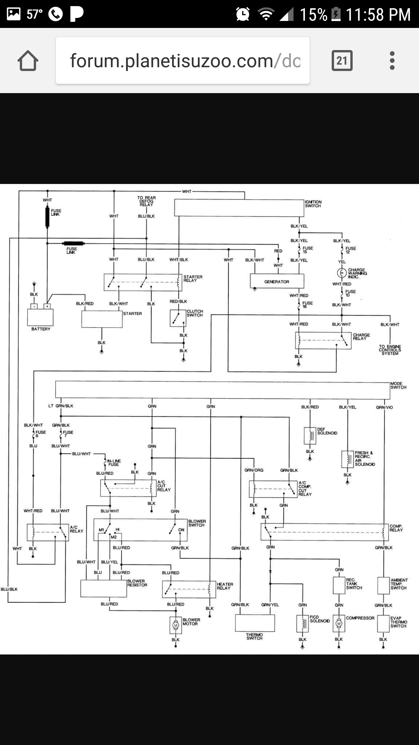

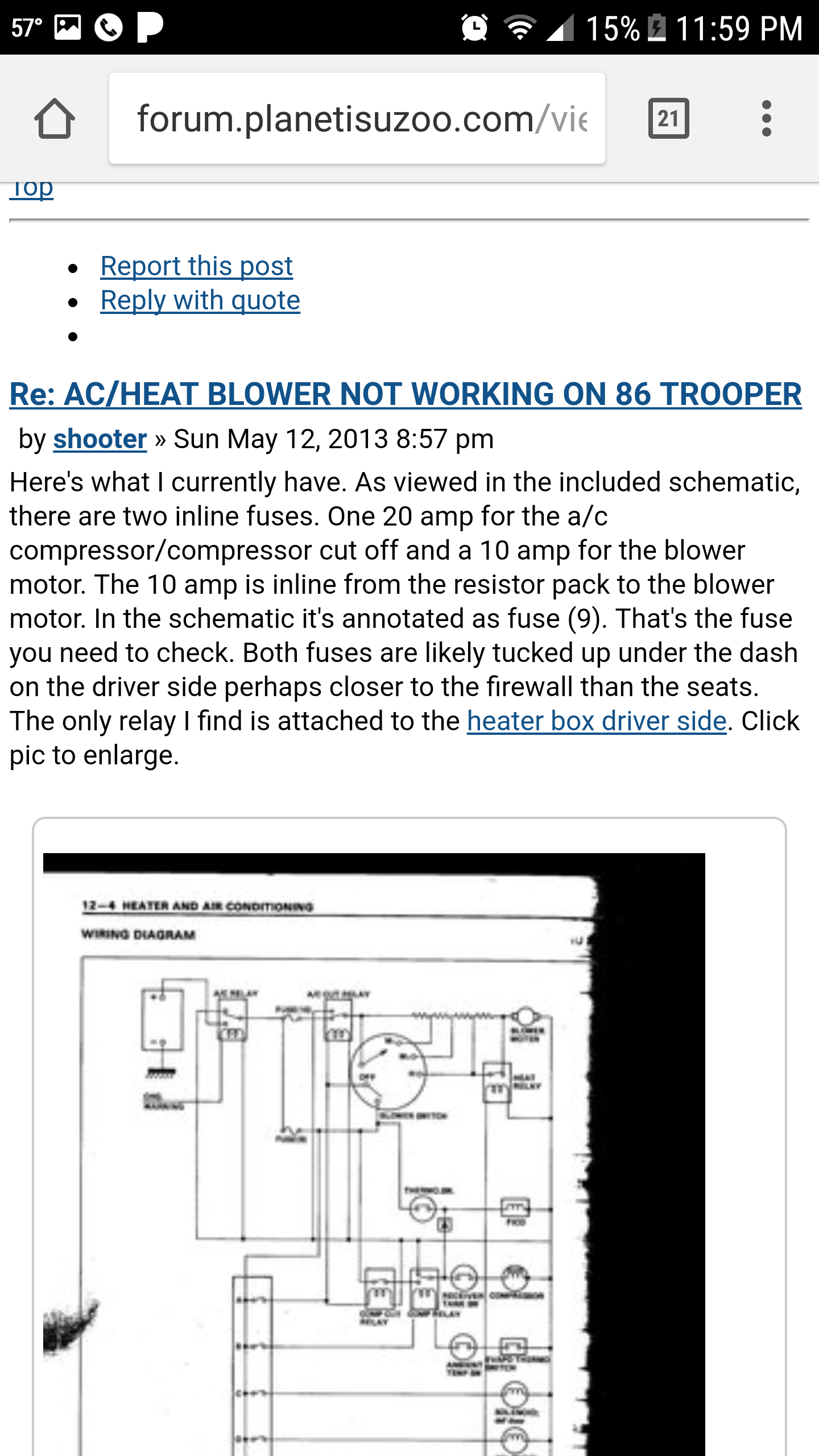

So I was looking at some other threads the heater relay is literally inside the car connected to the heater box. I am going to swap the relays and see if that fixes the issue.
Jun 20, 2017 at 4:57 PM
CHRISTOPHER OWENS
  • 6 POSTS
Here.
