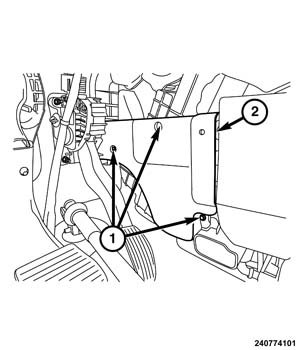

2. Remove the three air electric heater (AEH) high-voltage wiring cover screws (1), and the high-voltage wiring cover (2).

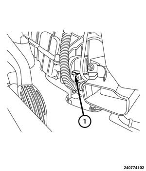

3. Release the tab (1) and detach the AEH high-voltage electrical connector bracket from the HVAC housing.

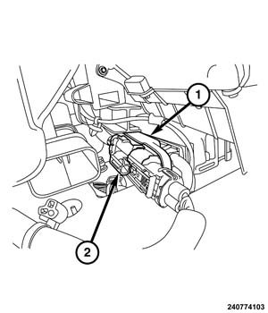

4. Detach the AEH high-voltage electrical connector (2) from the connector bracket (1) and disconnect the AEH high-voltage electrical connector.

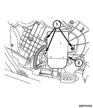

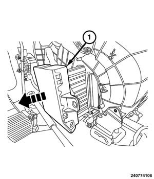

5. Remove the three AEH screws (1) and detach the AEH (2) from the HVAC housing.
pic 5
6. Remove the AEH (1).

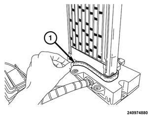

1. If installing a new air electric heater (AEH), install the new wide seal (1) around the side and bottom surfaces of the AEH element as shown.

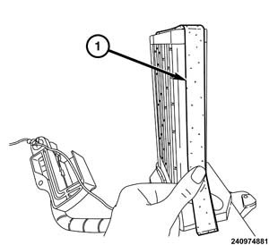

2. If installing a new AEH, install the new thin foam seal (1) along the surface where the AEH element meets the AEH module.

4. Attach the AEH high-voltage electrical connector (2) to the connector bracket (1), and connect the AEH high-voltage electrical connector.

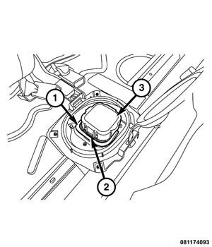

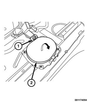

pic 12

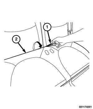

Pull the rear seat cushion release strap (1), and position the rear seat cushion (2) away from the high-voltage manual service disconnect cover.
pic 13
Release the tab (1) and position the high-voltage manual service disconnect cover (2) aside.

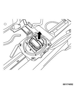

pic 14

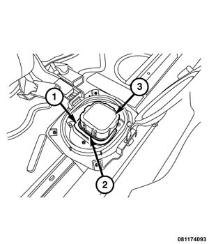

Release the locking tab and position the high-voltage manual service disconnect release lever (1) partially upward until it stops. Release the locking tab (2), and position the release lever (1) fully upward until the high-voltage manual service disconnect latch (3) is fully disengaged.
pic 15
Lift out, and remove the high-voltage battery manual service disconnect.
