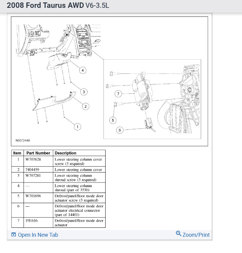

I am wondering if the mode actuator would cause this issue. If not, the plenum door flap inside must be broken. Here is the location of the mode actuator to see if it is working. There is only one heater core so if one side is hot the other side should be as well if the blend door is working correctly. Check out the images (below). Please let us know what you find.

Okay, thanks. I'll check that out. I printed out the diagram and it looks pretty straight forward and appears to be a simple enough job.I have to have my son-in-law help me with this because I am limited in my mobility and he has been ill with the flu, so it may be a few days or so before I can respond again. We will do the test on this one like the other one to see if it is working before, we would replace it. I checked that part, and it is less than $30.00 from Ford. I really appreciate your help. Thank you, Ken.
