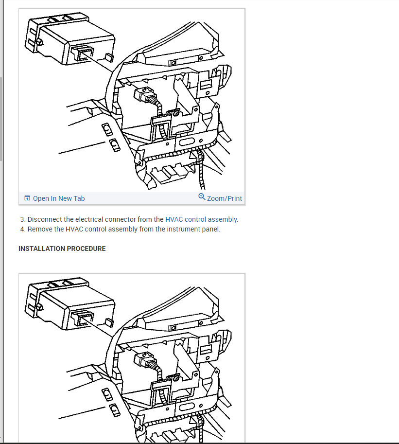

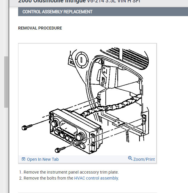

my AC/heat inside the vehicle stopped working. i have replaced the module in the dash 3 times and each time the part would work when i first put it in, then when i would shut off my car and turn the car back on the unit would simply not come back on. it blew A/C and heat just fine when the part was working.

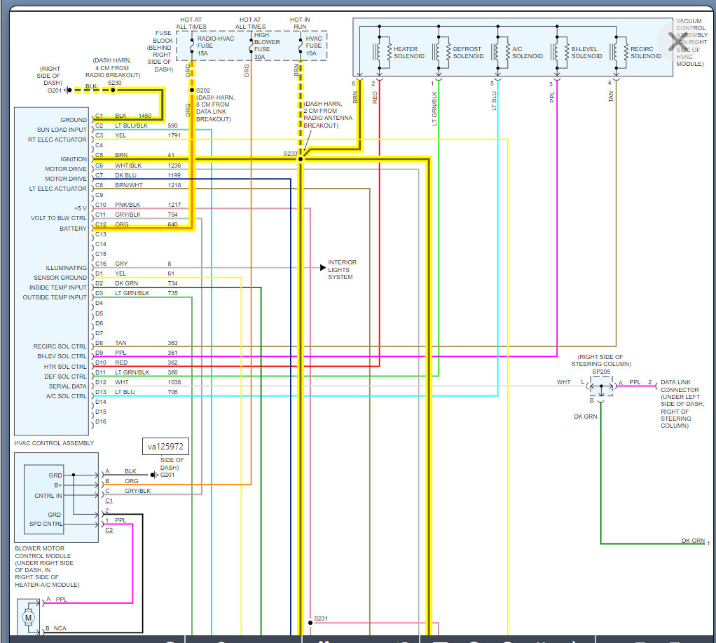

This would point to an issue that is shorting the module when you turn the key on.
So I just want to make sure we are on the same page.
When you turn the key and power it up the first time after replacement, it works properly? Then when you cycle the key again it stops working?

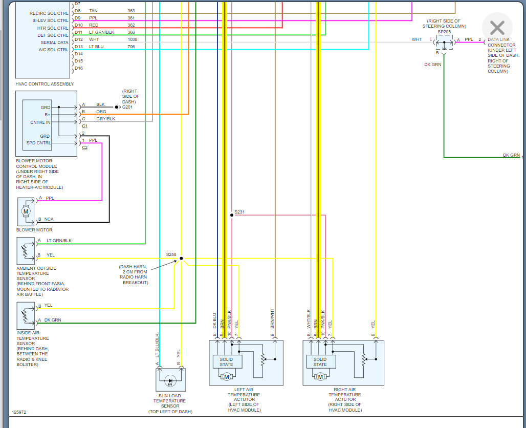

If this is the case, we need to unhook the connector and find out what the voltage is on the two power wires and the ground.
Basically we more than likely have an issue on the ignition feed wire which is labeled in the diagram. If this corresponds with a key cycle then monitoring that voltage when you turn the key on would be interesting to see. Maybe we are getting a voltage spike.
