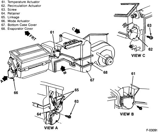

CHEVYBOY317
  • 7 POSTS
Okay, but I have checked blend doors both of those work fine.
Nov 26, 2017 at 6:54 PM
HARRY P
  • 2,292 POSTS
Your truck only has one blend door. But if you checked it and it is moving properly and not flapping back and forth or being easily movable by hand, then it is not the problem.
Nov 26, 2017 at 6:59 PM
CHEVYBOY317
  • 7 POSTS
Yea I was referring to the actuator under the dash and the blend door behind the glove box.
Nov 26, 2017 at 7:01 PM
HARRY P
  • 2,292 POSTS
Okay, I am posting a diagram here. As long as you checked 61 then it should be okay. I have got to go to work now, so I will not be back online until tonight.
