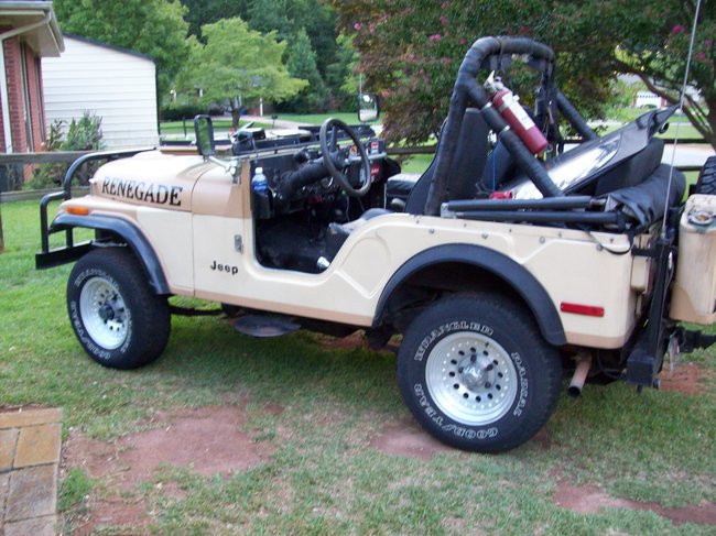

1980 JEEP CJ5
150,000 MILES • 2.4L • 6 CYL • 4WD • MANUAL
JAGA5
Heater blower works, air comes out but is cold. how can we get it to blow hot air?

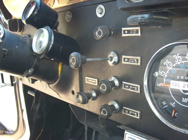

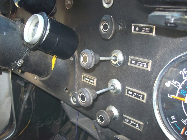

Are the heater hoses hot at operating temperature?
Let's make sure you have the
1) Blower on (hear it running)?
2) Air knob pulled out till it stops (this is the half way position).

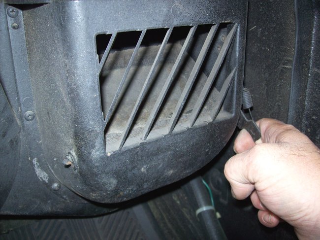

(2A General information) Beings this old, if you pull the air knob harder (and your pal assists the "frozen/dirty" vent Lever against the passenger wall). The knob will project further out, this would be the air or vent position being fully on, (air from the vent on the cowl). Summer time air 'twixt your legs and on the passenger's legs. Many folks do not realize the half or full positions, they think a quarter of the way is the heat setting.
3) Temperature knob all the way out?
4) defrost off/or part way/to fully. This will rob the heat going to the floor if pulled fully on.
(Note) after the air knob gets used to the full position (WD-40 helps too on the linkages and cables) It will function without your pal's assistance, just will a firm pull past the half mark.
A) Heat mode/ no defrost.
B) Air knob at 100% see "C".
C) This vent will be open if air is at 100%/ It will be closed at first stop/ the half position for heat mode.
D) Twixt your legs air/vent/ duct under the steering column.
