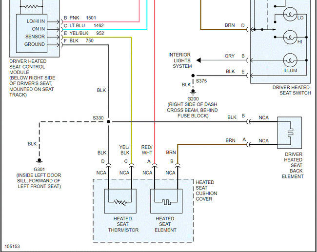

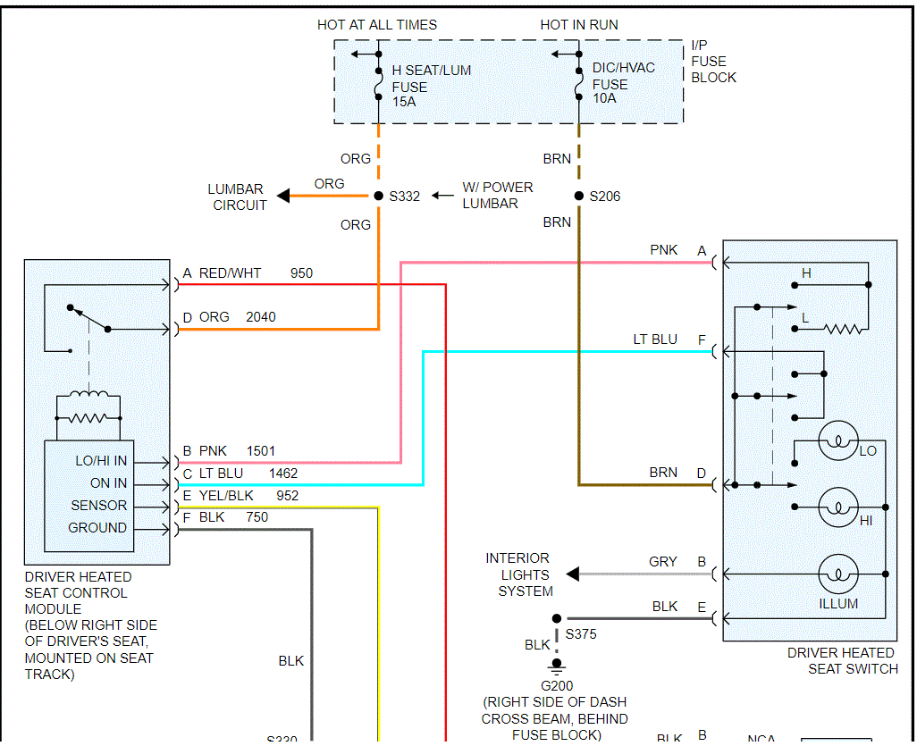

My 2002 Grand Prix does not have heated seats but my 2000 Grand Prix parts car does. would there be a plug somewhere for the heated seats in my 2002? if so where would it be?
Feb 24, 2021 at 7:06 AM
  • 110,244 POSTS
When the vehicles are manufactured, different wiring harnesses are used. Also, the Grand Prix will not have the power supply or control module for it.

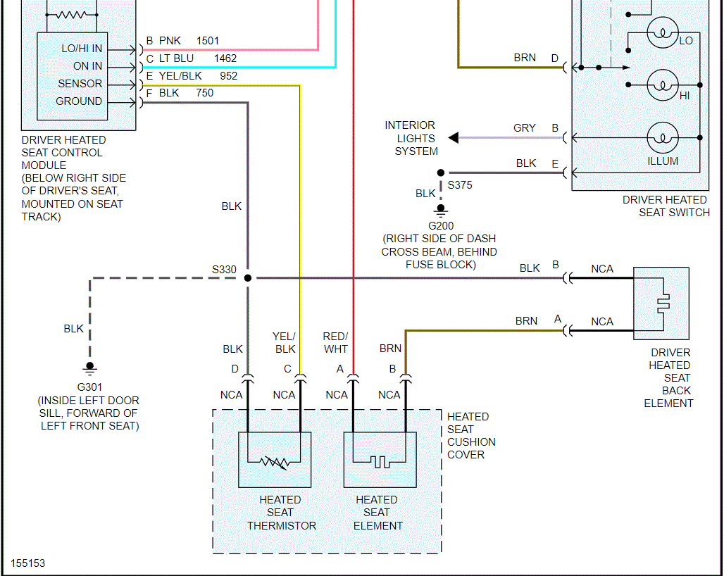

I won't say it couldn't be done, but it will take a lot of work. What I've done is attach the wiring schematic for the heated seat circuit in a 2002 Grand Prix. Take a look through it and see if it is something you want to perform.
Note: I cut the original wiring schematic in two so it is easier to read. I did overlap the two pics so you can follow them.
Take care and God Bless,
Feb 24, 2021 at 12:50 PM
