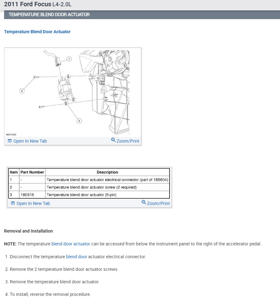

Where is the blend door actuator located?
2011 FORD FOCUS
30,000 MILES
QUANA
Heat works on the passenger side but not the driver side. I was informed that I needed a blend door actuator. Where would it be located in the car listed above? Also, I saw you guys provide manuals on how to remove and locate it. Please help. The harsh parts of winter is fast approaching.

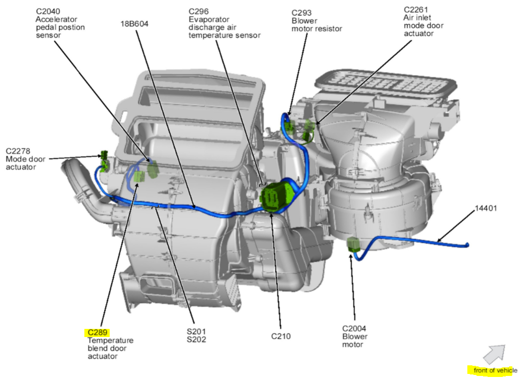

On your vehicle the blend door actuator can be accessed from under the driver's side dash, next to the accelerator pedal.
I have attached diagrams/instructions below for your reference.
