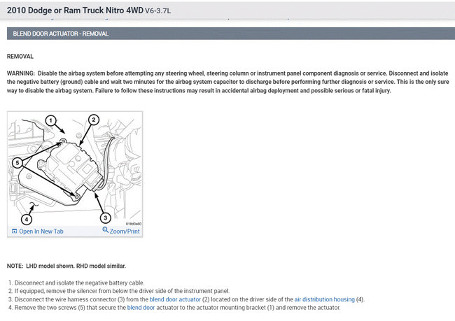

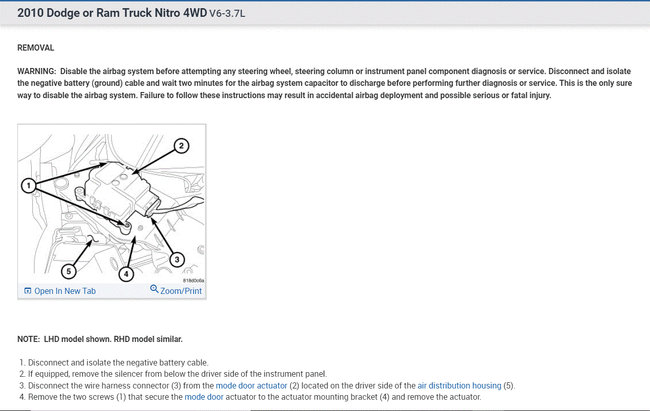

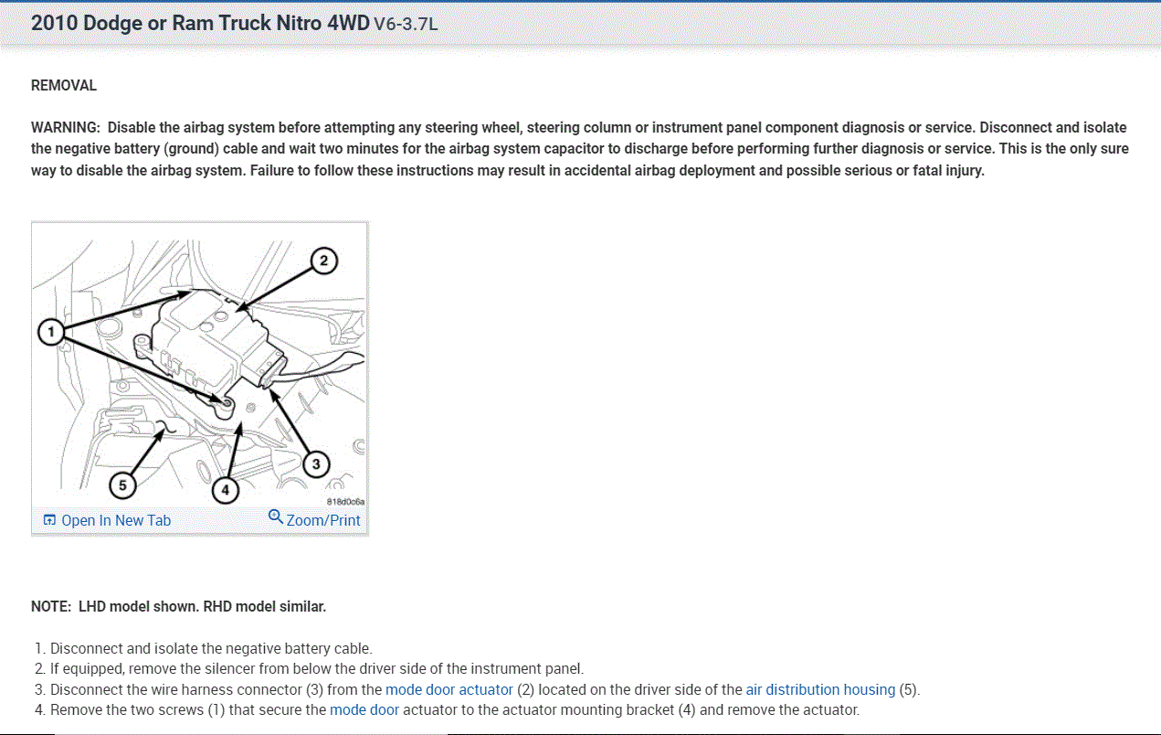

I believe you are referring to the mode door actuator. That is what directs air flow direction.
If you look at the attachment below, it explains how to replace one. And you are correct. It doesn't require the dash to be removed.

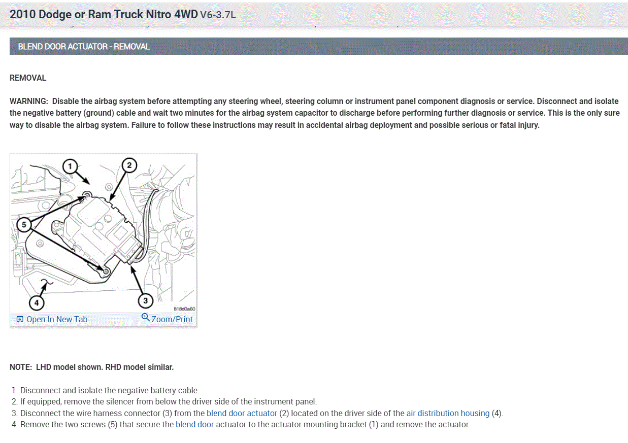

If you are referring to the blend air door actuator (responsible for air temperature entering the vehicle) see pic 2 below.
Let me know if this helps.
See pic below.
