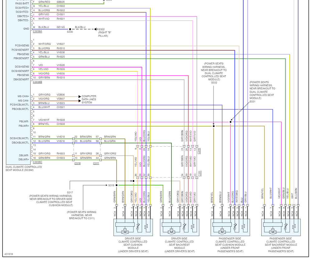

Heat and Cool seats not working?
2014 LINCOLN MKX
243,000 MILES • TURBO • 4WD • AUTOMATIC
RJLOMB
When the A/C button for the seats is depressed, it lights up that all 3 positions are on and if I switched to the Heat mode the same indicator shows lit, but I don't hear anything running nor is there any air coming out from the seats nor heat depending on what is lit. I haven't tried removing and replacing fuse 28 under the hood which I will do. If that doesn't do the trick, what is next??
Aug 14, 2023 at 7:30 PM
  • 54,832 POSTS

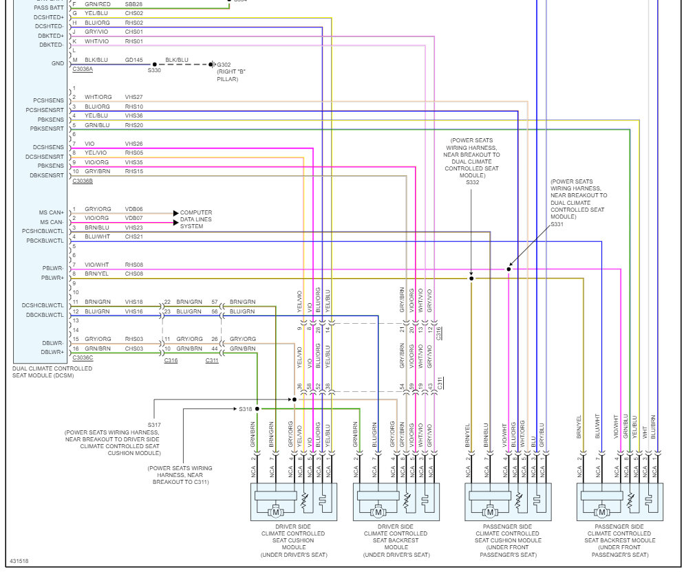

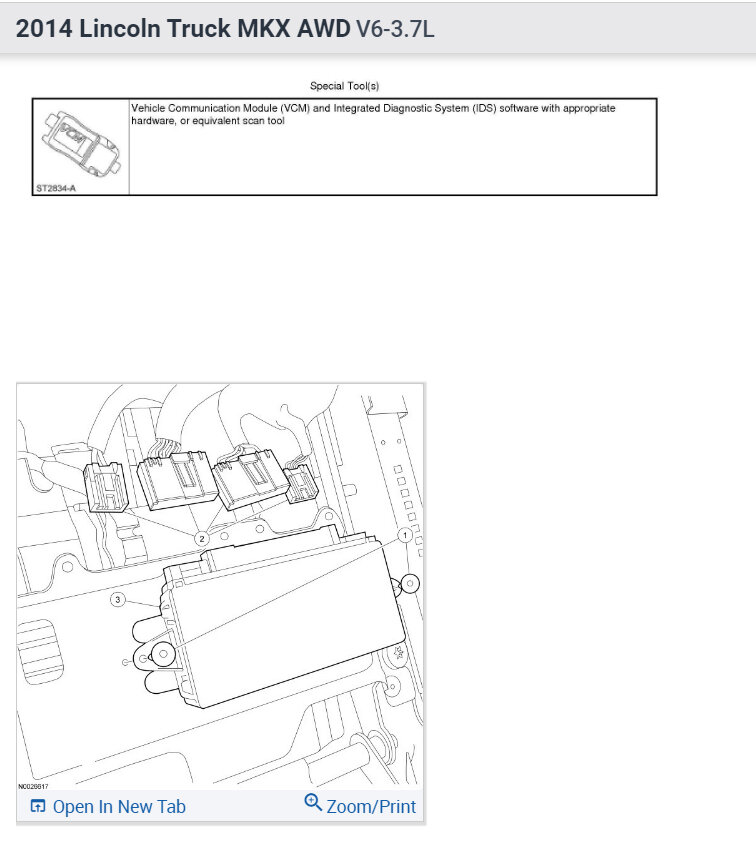

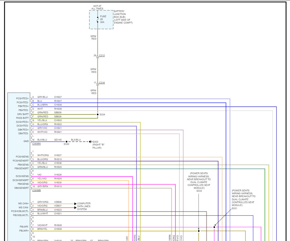

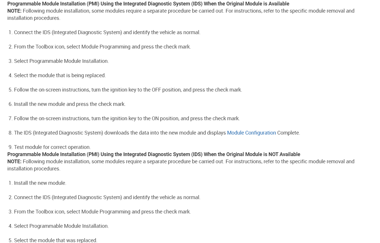

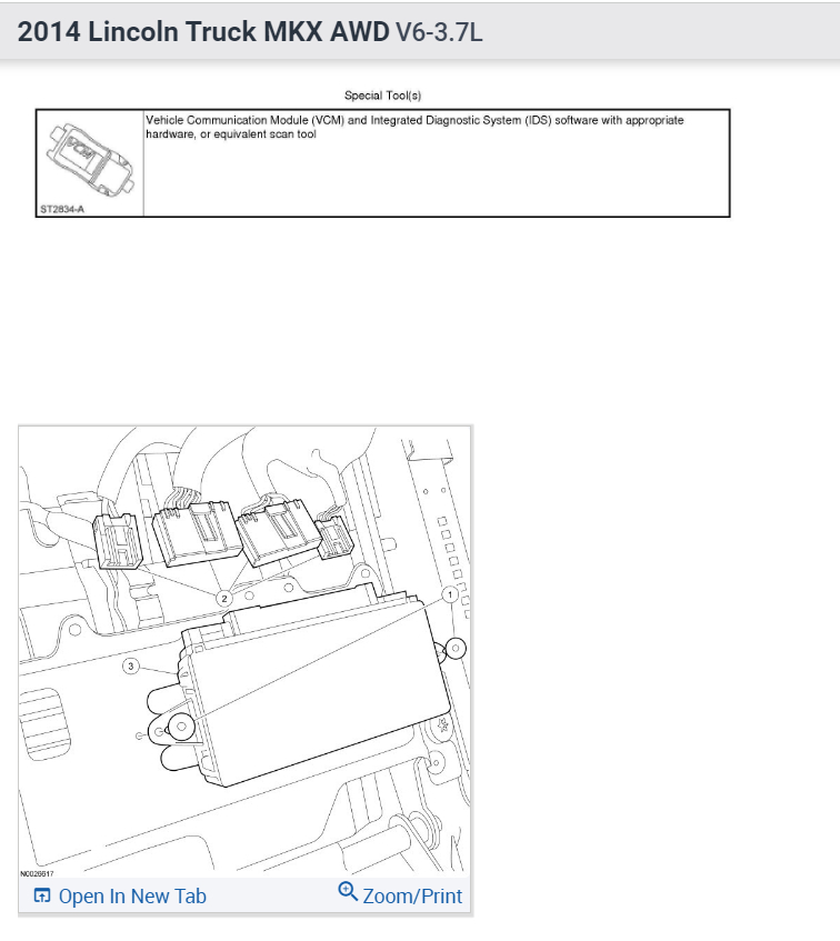

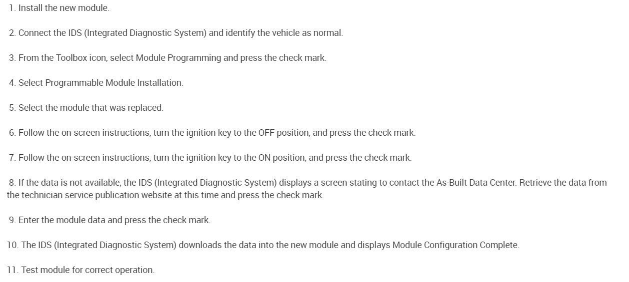

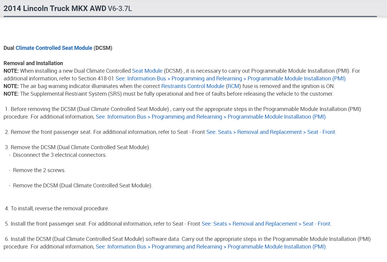

Yes, please check fuse #28 first, if that is okay it sounds like the dual climate control seat module is bad. Here are the wiring diagrams so you can see how the system works and the location of the module. Check out the images (below). Please let us know what happens.
Aug 15, 2023 at 10:47 AM
