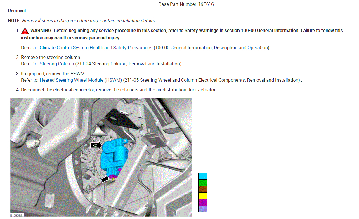

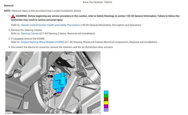

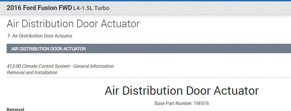

The codes are for the left temperature actuator and the mode door actuator. First, and I feel bad to say this, but the mode door requires the removal of the steering column to replace or inspect it. Also, if the vehicle has a heated steering wheel, that module will also need to be removed.
If you look at the first two pics below, they are for the mode door actuator. If you need help accessing it, let me know. Also, if you plan to replace it, make sure to get a quality actuator. Some of the less expensive ones will fail shortly after install.
