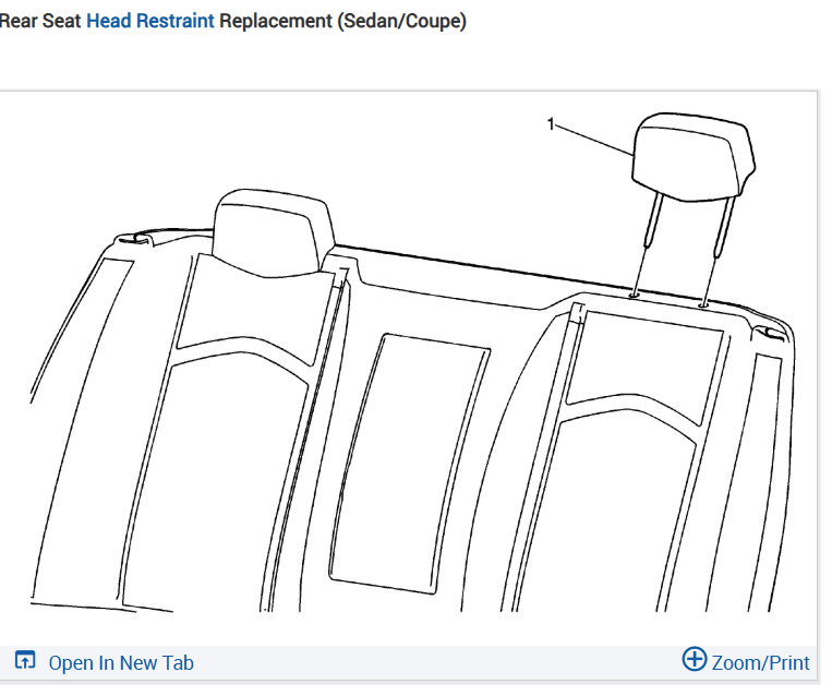

Is it possible to remove the rear fold down seat headrests??

There is no button or any escutcheon on these headrests, they don’t move up and down. That’s why I can’t get them out. They are on rods like a normal part, but do not move. I want them out, because when the seat backs are down, they interfere with the front seats. They do swivel, I don’t know why, lol.

This is a 2 door coupe 2012 cts

Can you upload a picture of the base where the shaft goes in?

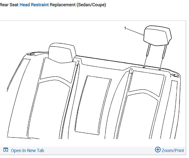

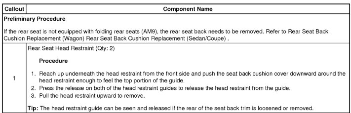

Here is how to replace the rear seat headrest. Check out the images (below). Let us know if you need anything else.
