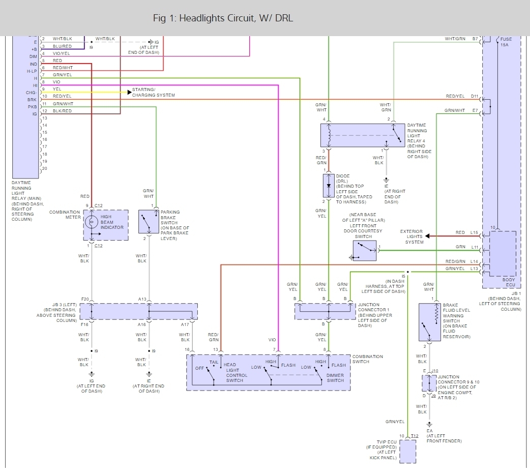

Headlights turn off after thirty minutes
185,000 MILES • 2.7L • 4 CYL • 2WD • MANUAL
CALITOYOM
There was previously a ignition interlocking device in the truck. Exactly after thirty minutes the headlights turn off and can be brought back on by turning them off then on again. This happens like clock work with the truck on or off. I know that there are a few crimp connections from when the interlock was removed. Thanks, I look forward to your help.

Hey CALITOYOM,

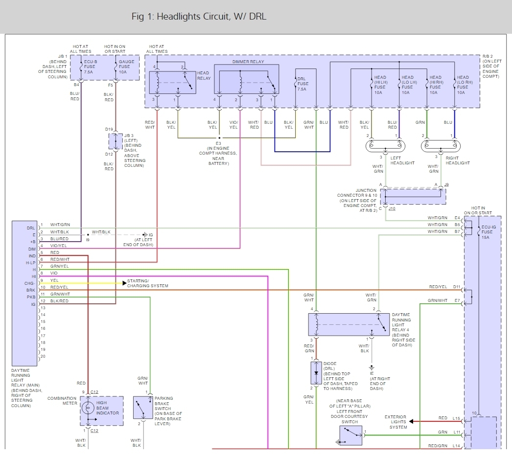

This sounds like a problem with the BCM which controls the headlight relay but I would chase down where the power stops using a test light, here is a guide for you to follow along with a diagram.
Please run some tests and get back to us so we can continue helping you.
