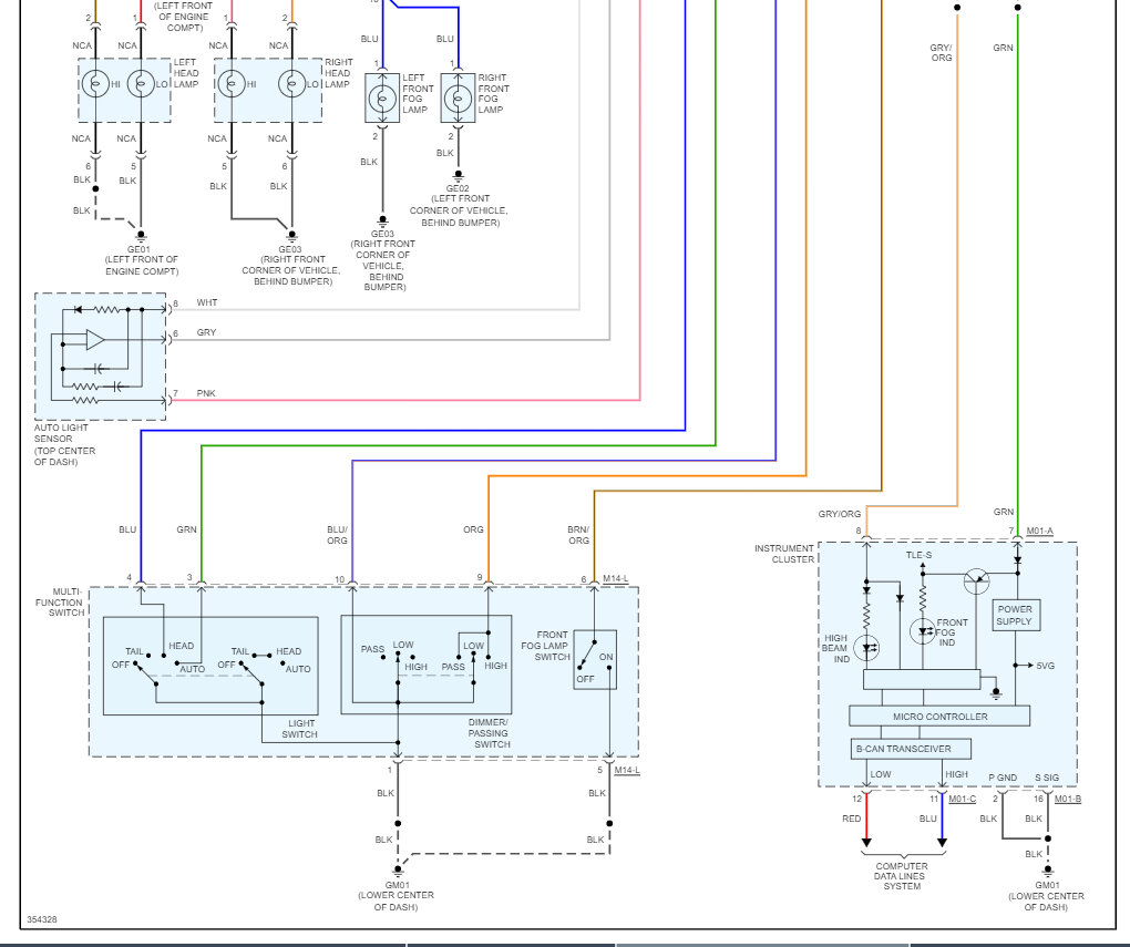

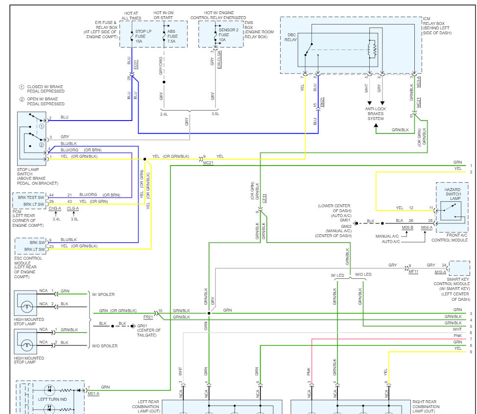

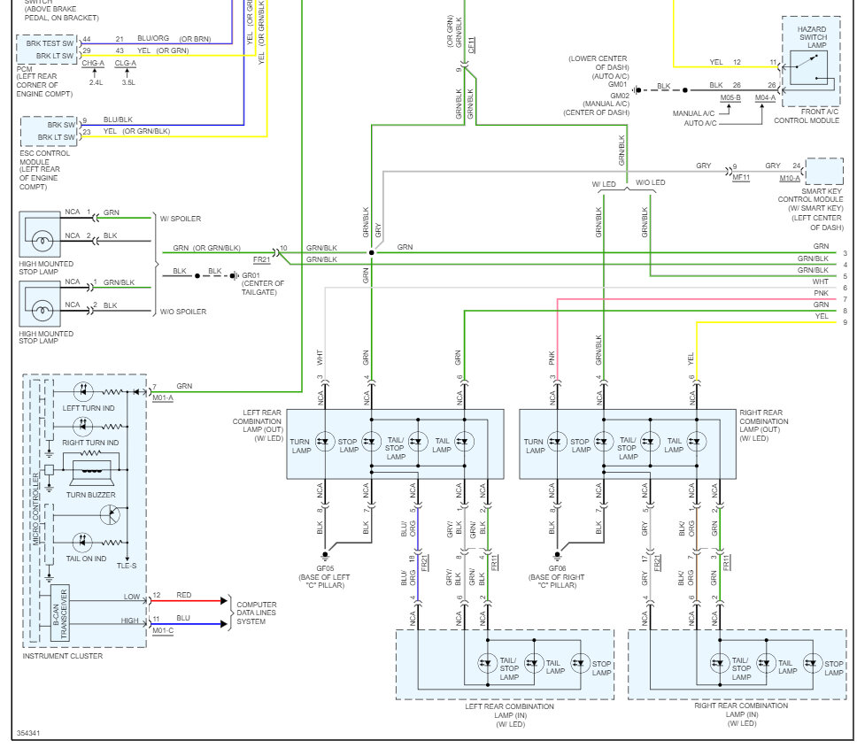

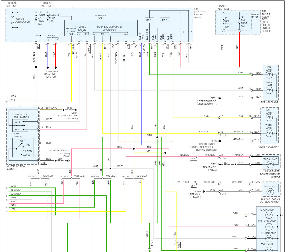

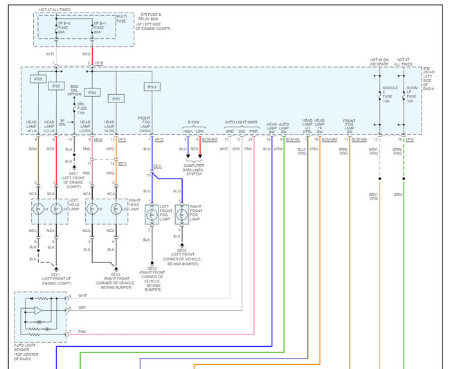

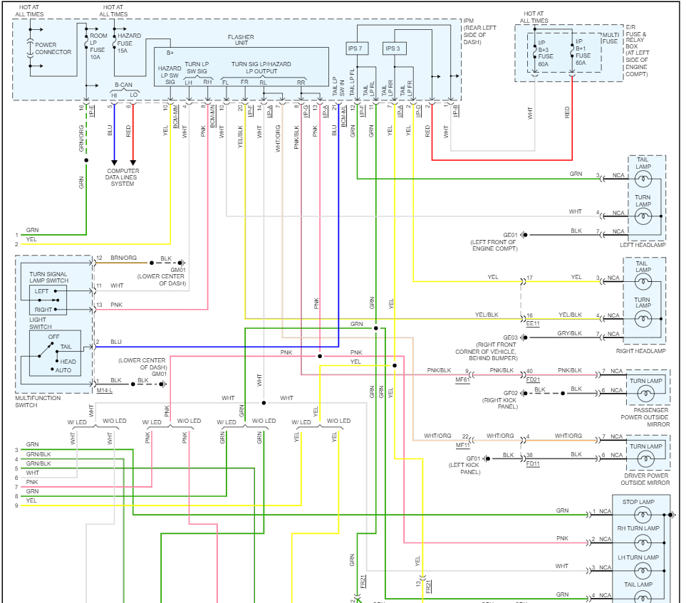

I can't drive at night due to the lights shutting off intermittently.
May 2, 2023 at 3:45 AM
  • 55,721 POSTS

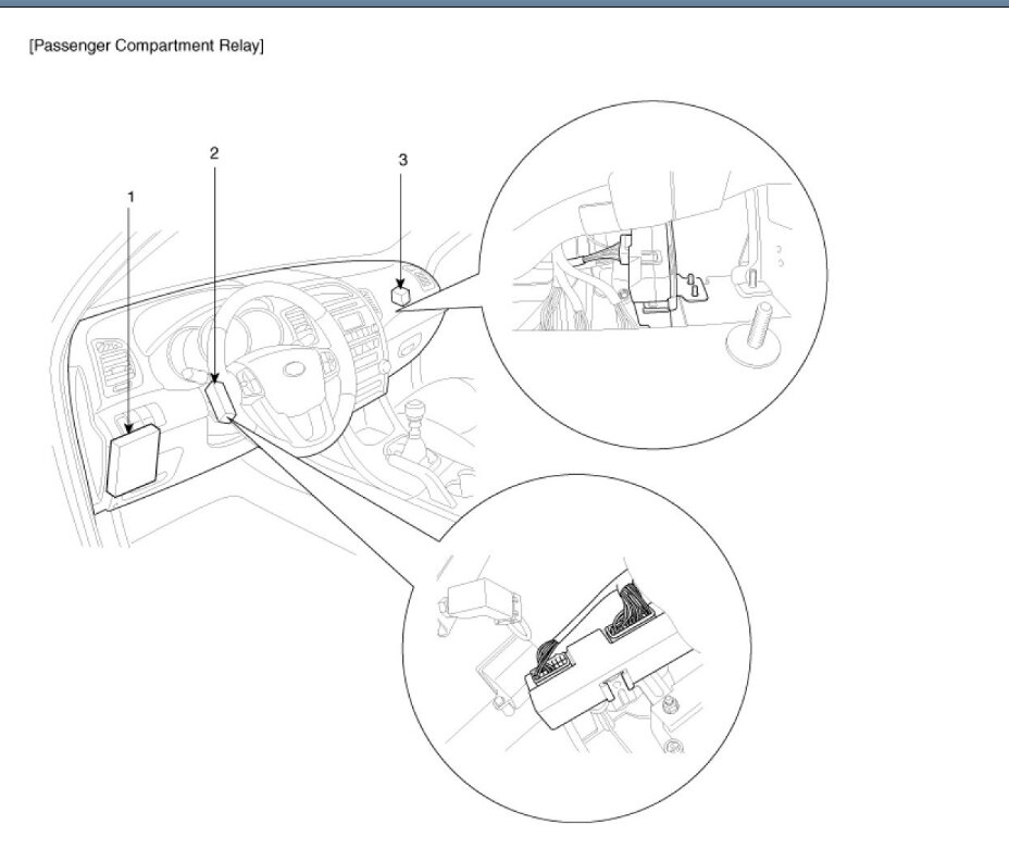

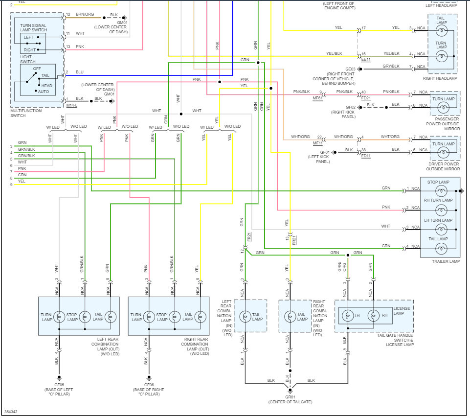

The happens when the IPM is going out. here are the headlight and taillight wiring diagrams so you can see how the systems work and where they get their power from. I have also included how to change out the IPM and its location. You can get a preprogrammed unit by searching Google or Ebay. Check out the images (below). Please let us know if you need anything else to get the problem fixed.
