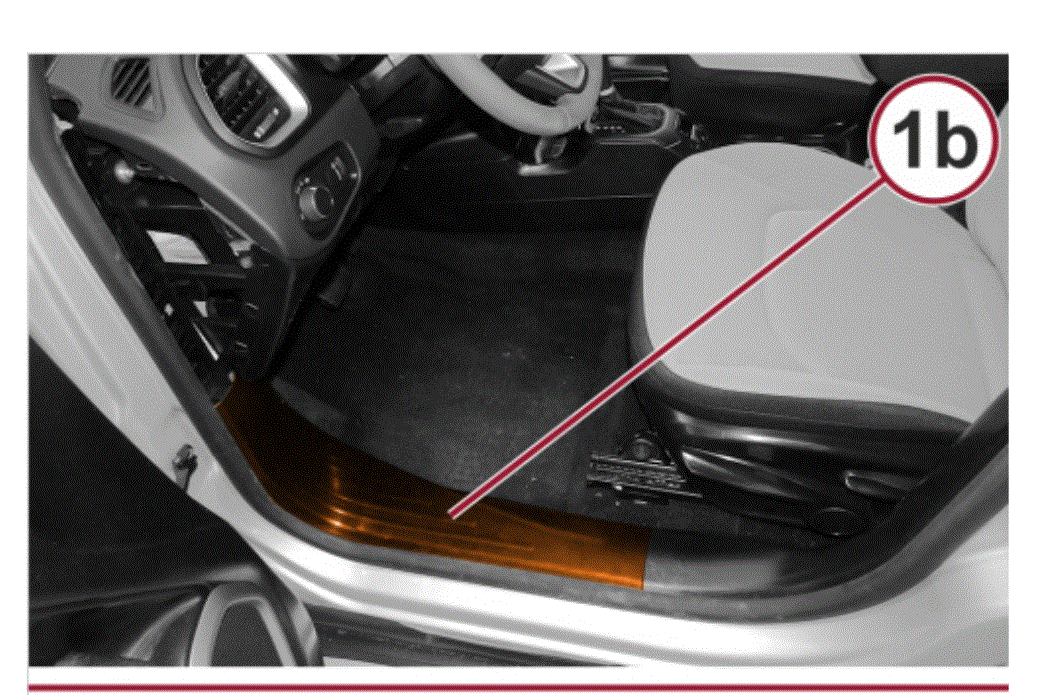

Turn the heater fan speed to speed 4-7 (max) causes the headlights (and occasionally every other light) to turn on and off in rapid succession as if I was sending Morse code messages. If I'm parked with the headlights turned off, they still turn on and off with the heater fan. Everything is original including the battery and alternator but there is no corrosion of any kind messing with the connection. I can't find the ground wire though as I'm told there's more than one and I'm not mechanically inclined.

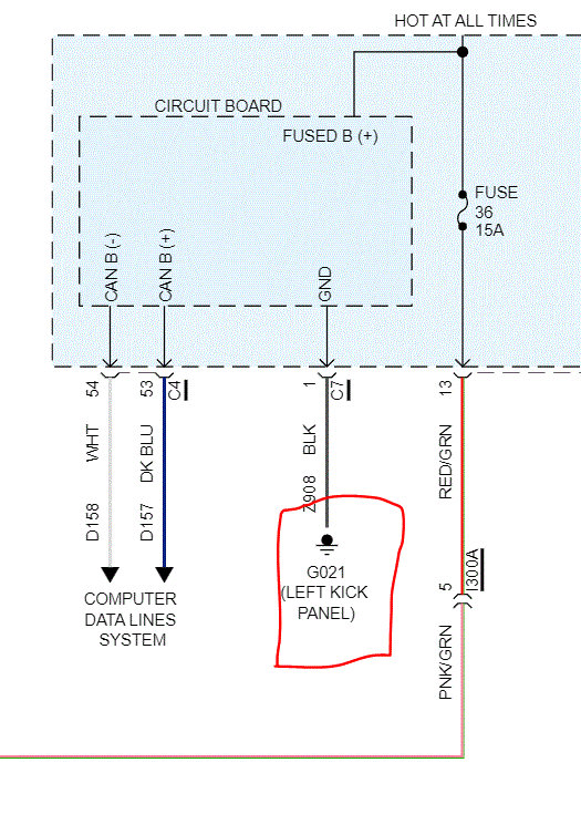

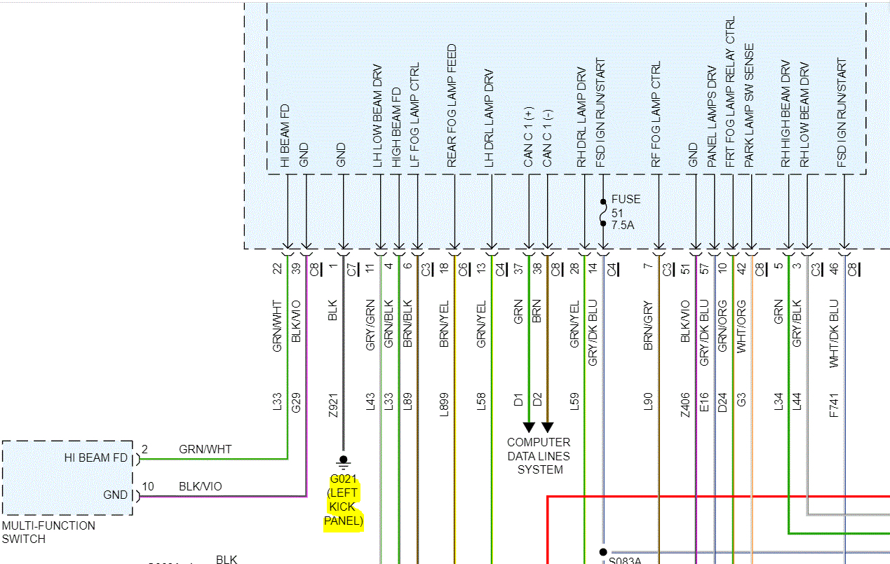

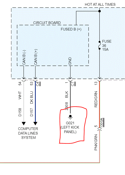

The idea that the lights flicker with the blower motor on leads me to think it's a ground. However, with the headlights turned off, they shouldn't flicker on when you turn the heater on. That leads me to think there is a short to power somewhere.
I looked through the wiring schematics for both the headlamps and the heater blower motor. Although there is more than one ground, they do have one in common.
Pic 1 is a ground for the HVAC system. Pic 2 is a ground for the headlamps. Note they have the same number, G021. That is where I would recommend checking first.

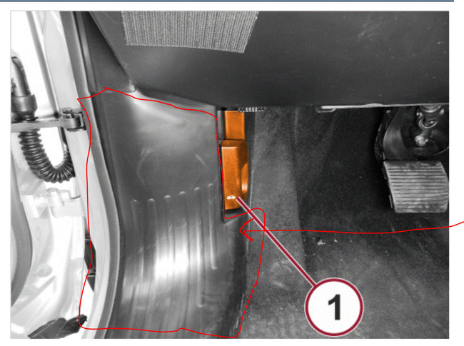

The schematics indicate they are located at the left kick panel. There will be more than one wire and they should be black in color.
The left kick panel is under the dash on the driver's side. If you were sitting in the vehicle with your feet on the floor and turned your left foot, it would touch the panel. It is behind where the hood release is located.

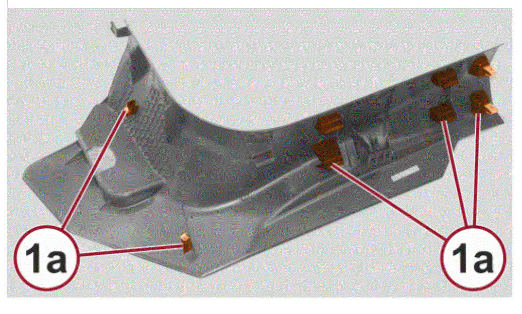

Pics 3-5 are the kick panel. It is clipped to the body of the Jeep (pic 5). Gently pull in those locations to remove them. Once removed, check for the black wire that is bolted to the steel body of the vehicle, checking it for corrosion, damage, and make sure they are tight.
