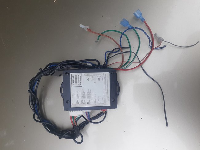

The button on the key doesn't unlock the doors anymore. I should explain that when I first bought it I one key was used to start it and one to unlock the doors. But when i took it back to the guy i bought it from because the lights kept blinking every time i opened the door he cut some wires that made it unable to use the key to unlock the door with the button. So I was only able to unlock the door manually, then after awhile I wasn't able to even do that. The key goes in but doesn't turn to unlock the door. So I cant lock the doors anymore.
May 6, 2020 at 12:01 PM
Oh boy. Do we know what wires he cut? Do you know where they are? We are going to have to repair that before we are able to figure this out.
If you know where they are? can you get a picture of it and we can try to put this back together and see what happens? Then go from there. Thanks

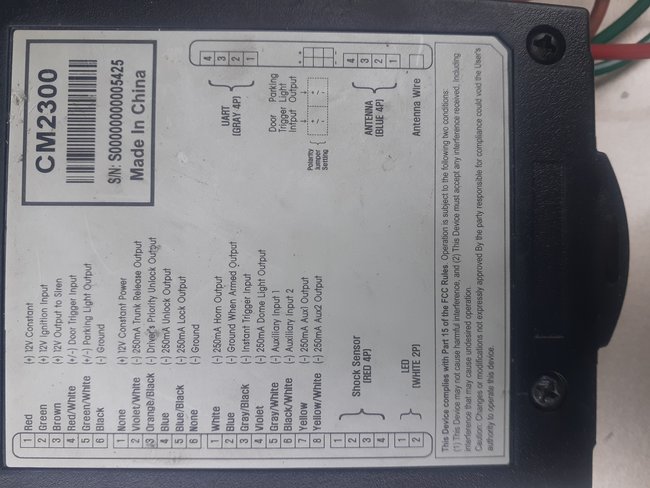

Okay. So I'm sending a picture of the box he took out. I'm not sure where he took it from. If you tell me what to look for, I'll search. Wouldn't it be easier if I had the key fixed? Then I could just turn off the alarm manually at the door. Or is that even an option? BTW thank you so much for your help. I had no idea what to do or who to ask.

While it doesn't say what it is I suspect that is an alarm system. No matter what it is, it is not a factory item because they do not use those type of connectors.
I think at this point the best course of action would be to take care of the key and go from there.
Keep us updated with what happens. Thanks
