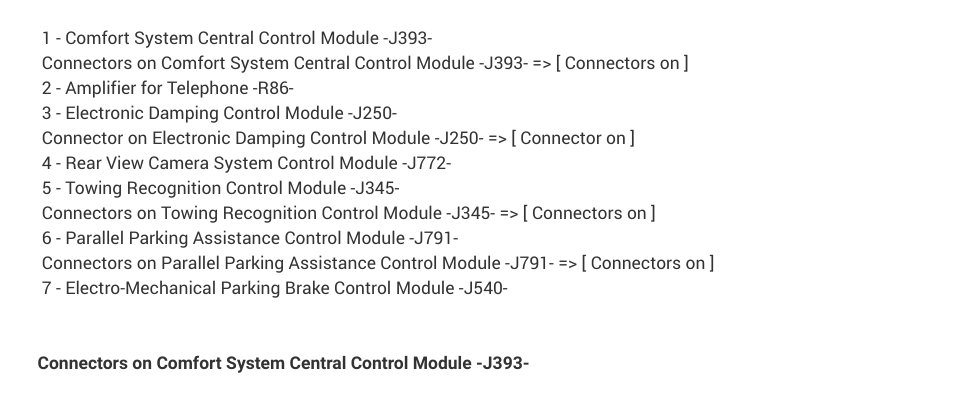

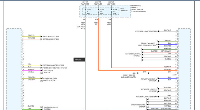

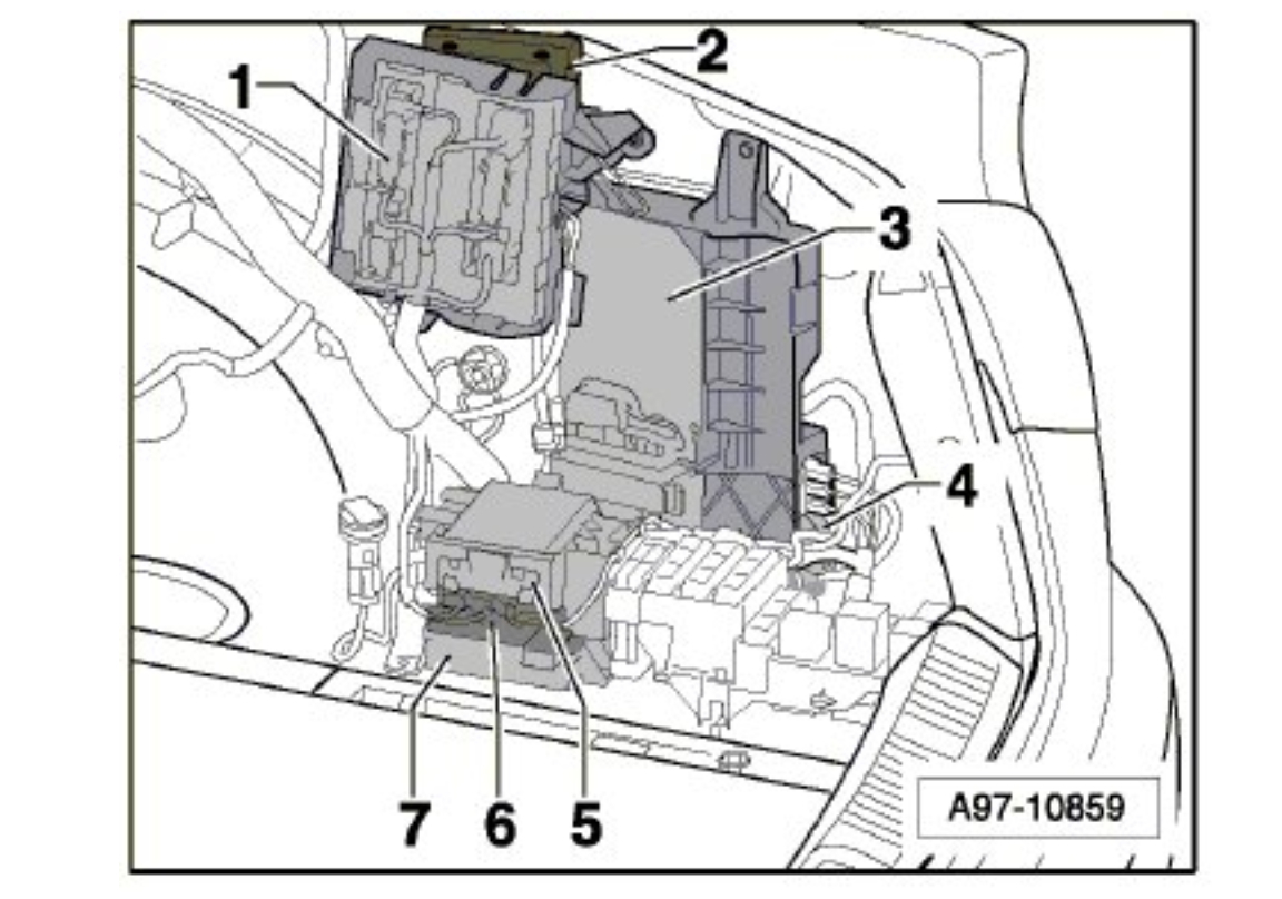

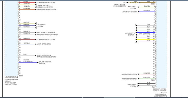

This sounds like you either are having an issue with your vehicle's Body Control Module or you have a short to power across two or more circuits.Doing research on your vehicle I wasn't able to find a lot of information on your vehicle's Comfort Systems Central Control Module[CSCCM], which controls all of the systems that you are having problems with. I was able to get and put in the diagrams down below for you the .wiring diagrams for the CSCCM along with diagrams for it's location and connector pinouts for comparison off the wiring diagram. I would recommend starting by checking Ground #51, on the right side of the luggage compartment. It is the brown wire coming from pin 17 of connector T170 of the CSCCM. Make sure the ground is clean, tight, corrosion free, and making good metalto metal contact. Please go through these guides and get back to us with what you are able to find out. We can go from there if needed.
