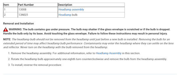

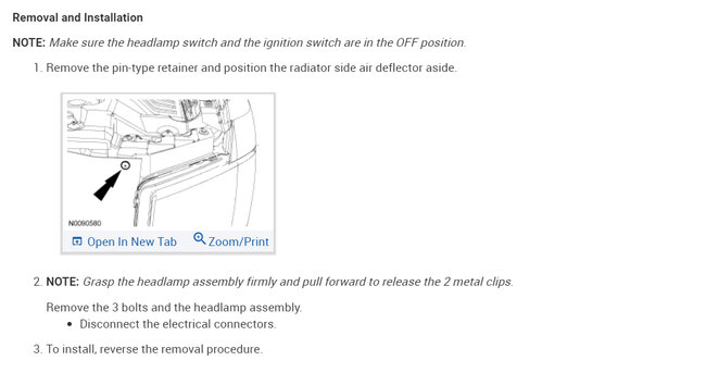

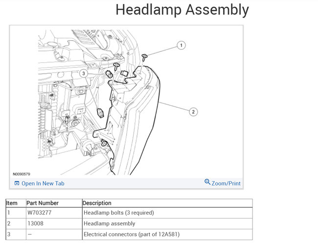

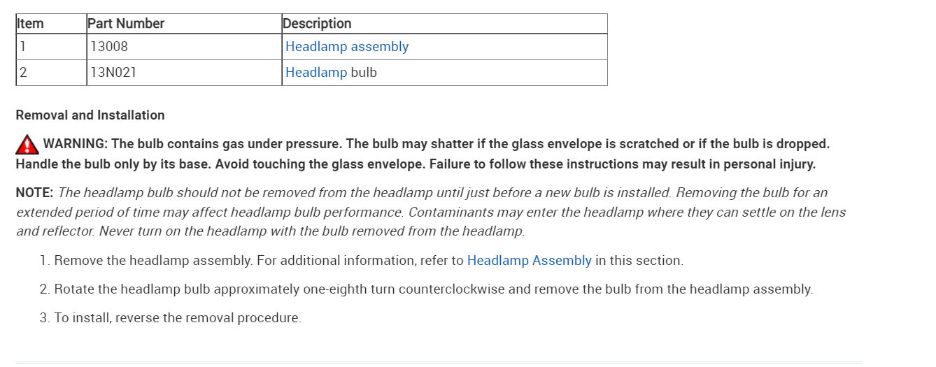

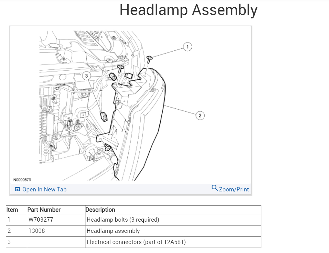

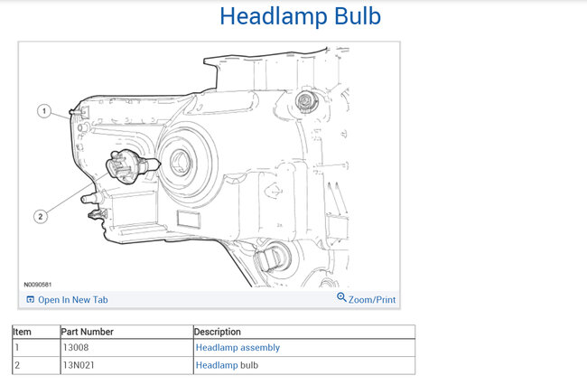

I want to replace the headlight bulbs.
Dec 8, 2022 at 10:57 PM
AL514
  • 5,610 POSTS
Hello, here are the instructions for replacing the head lamp bulbs, try not to touch the bulb itself, just the section that plugs into the wiring harness. It's a good idea to inspect the connector as well. They tend to get corroded inside after a while since they are exposed to the elements a lot. Hope this helps.
https://www.2carpros.com/articles/how-to-replace-a-headlight-bulb
