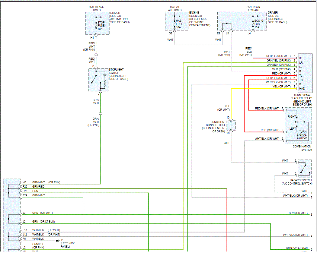

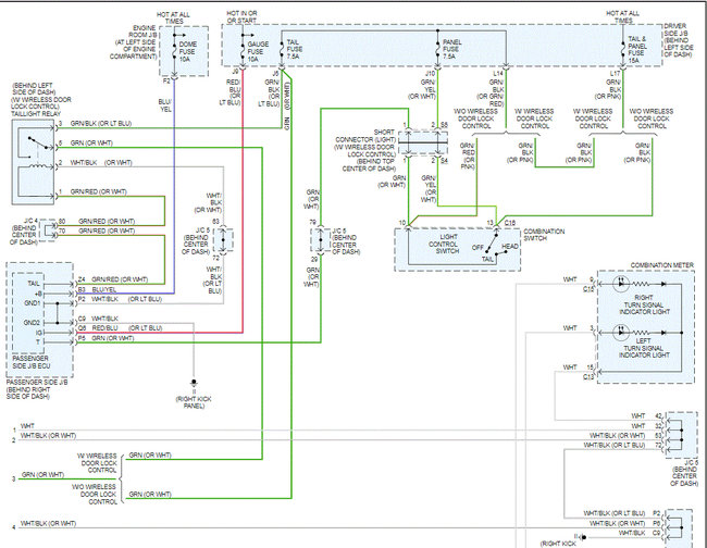

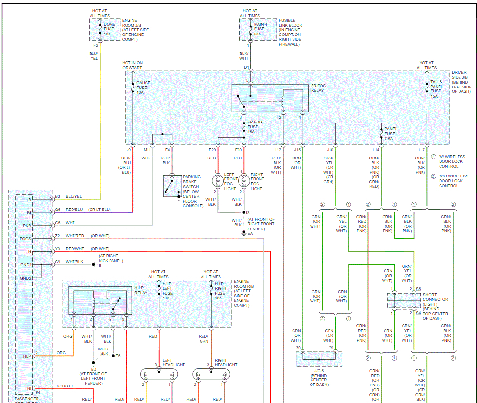

Hello, the vehicle left rear tail light and the front right head light not functioning. I have checked the fuses and relay they are fine. I have tested the bulbs separately they are functioning but there's no power at the connector. Could you help me the circuit diagram

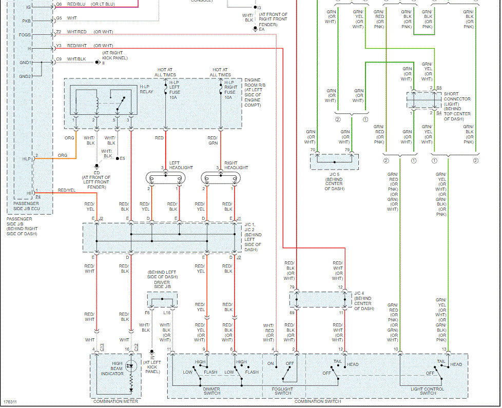

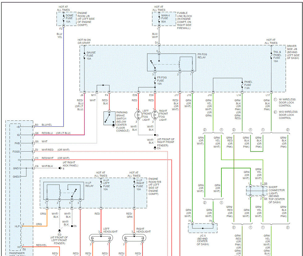

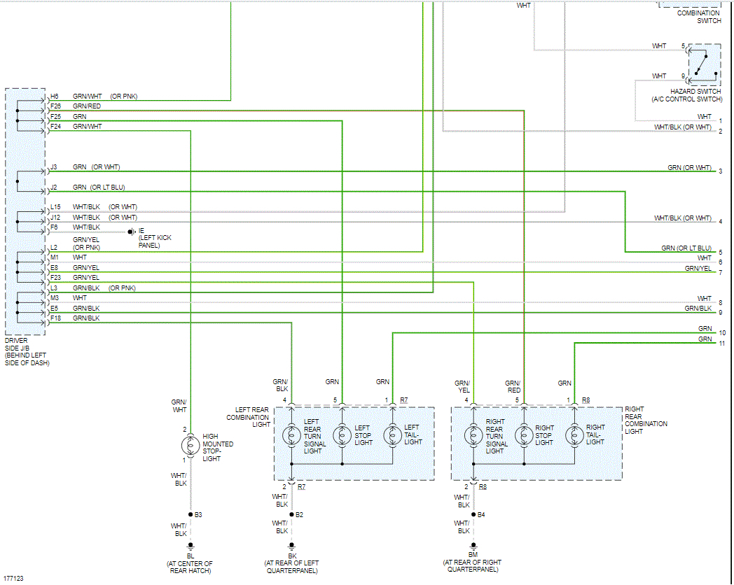

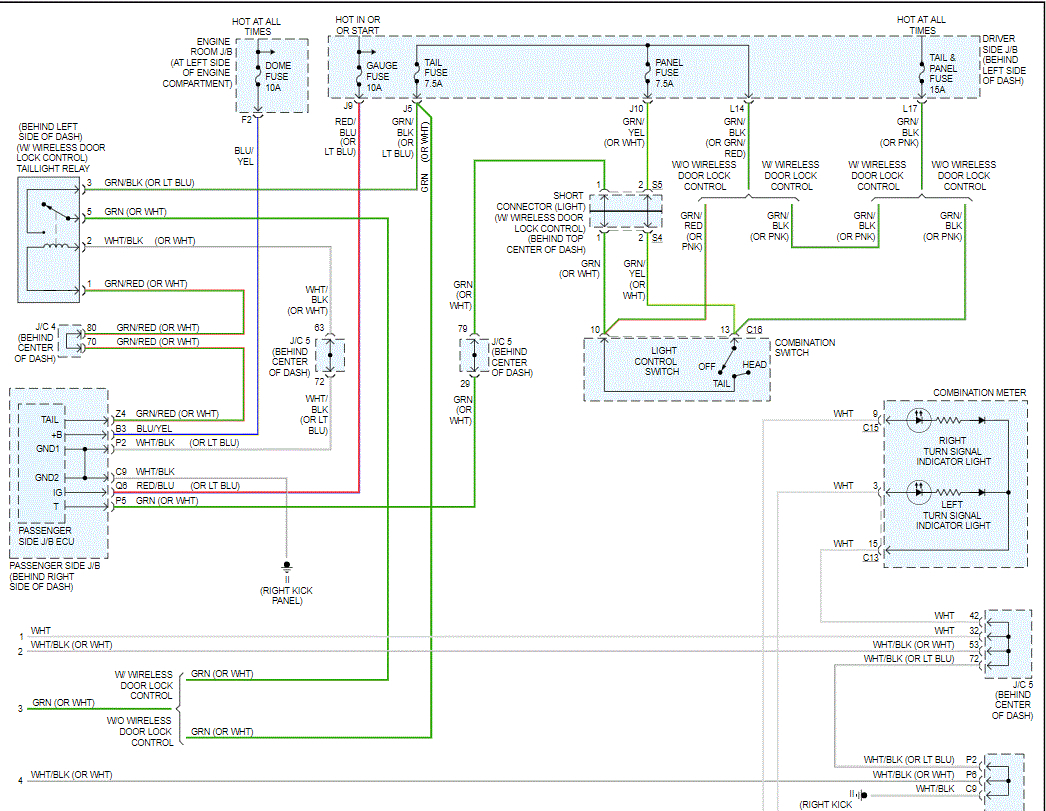

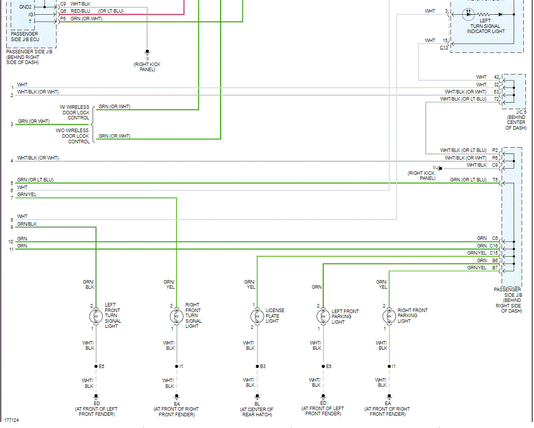

The wiring schematics are broken into two sections, headlamps and exterior lighting. The rear tail lamp issue will be under exterior lighting. The headlamp will be under headlamp.
_______________
Pics 1 and 2 are for the headlamp. I cut the pic in half to make it more readable. I did, however, overlap them so you can follow it.
Pics 3, 4, 5, and 6 are the exterior lighting schematics. Again, I cut them in half to make it more readable, and I overlapped them as well.

Sir, considering the 2nd diagram, it seems that the H-LP relay has no function since the circuit is ground by switch, am I right? If I am what is the function of the relay?
Friday, March 12th, 2021 AT 1:04 PM
BLESSING EWOBOR
  • 686 POSTS
How does the high beam indicator work since it is connected to the ground of both switch?
Friday, March 12th, 2021 AT 1:08 PM
  • 109,885 POSTS
The relay gets ground at the left front fender.
Friday, March 12th, 2021 AT 6:38 PM
BLESSING EWOBOR
  • 686 POSTS
What I am saying is that the whether the relay ground or not it won't stop the headlights from coming on.
Friday, March 12th, 2021 AT 9:10 PM
  • 109,885 POSTS
If the relay doesn't have ground, it will prevent the light from working. No power will be transmitted through the relay.
