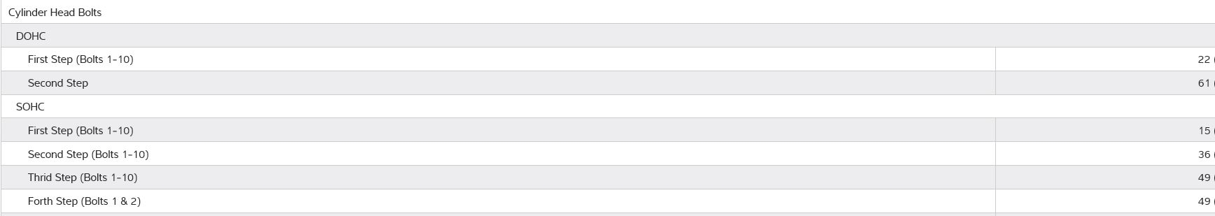

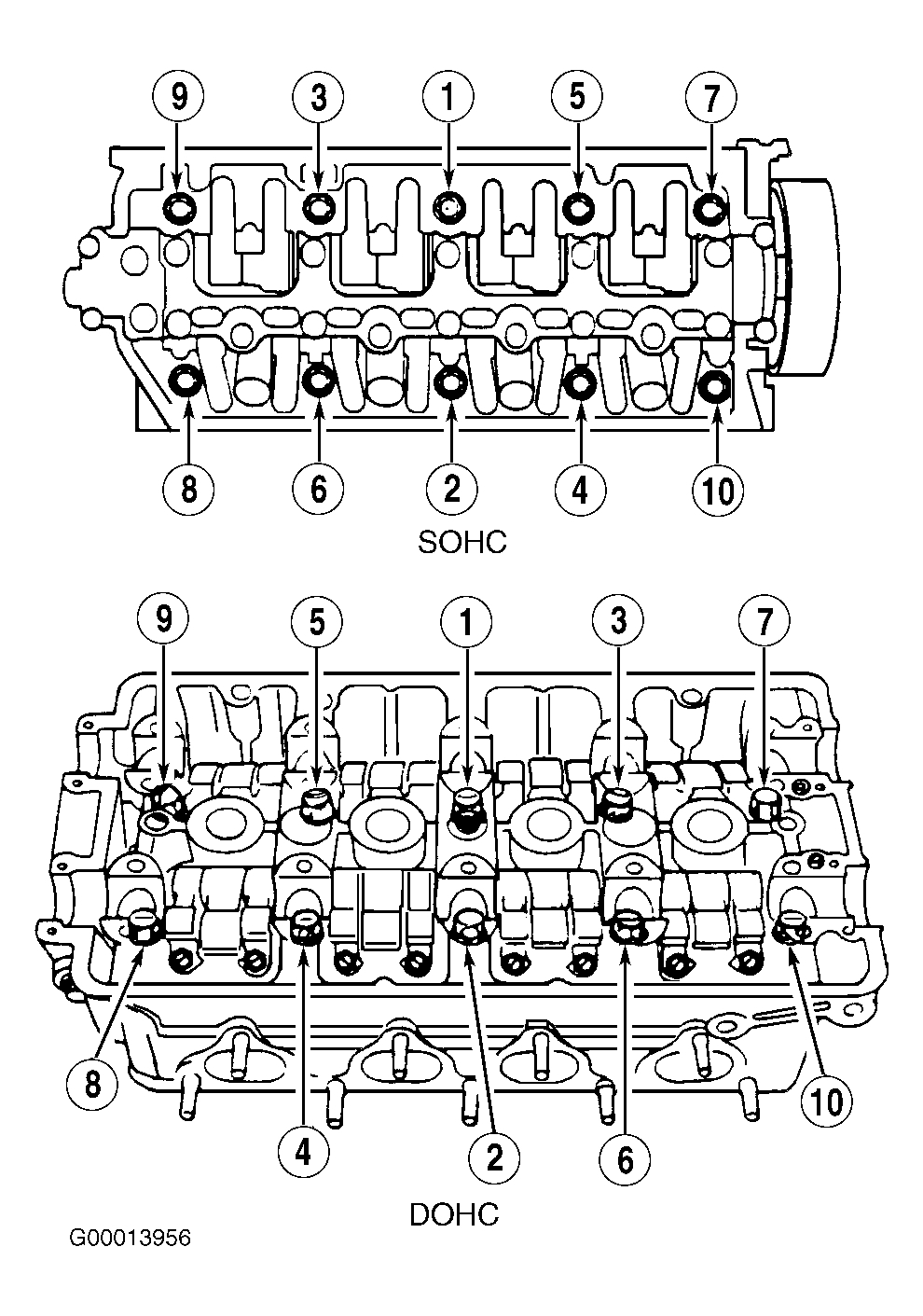

I have the car listed above (d16y9). I replaced head gasket and would like to know the head bolts torque.
Thanks
Dec 14, 2017 at 10:02 PM
PATENTED_REPAIR_PRO
  • 1,853 POSTS
That should be the same as on the 1999 Honda Civic 1.6L and those torque specs are listed here. They are in ft lbs. Check out the diagrams (Below). Please let us know if you need anything else to get the problem fixed.
