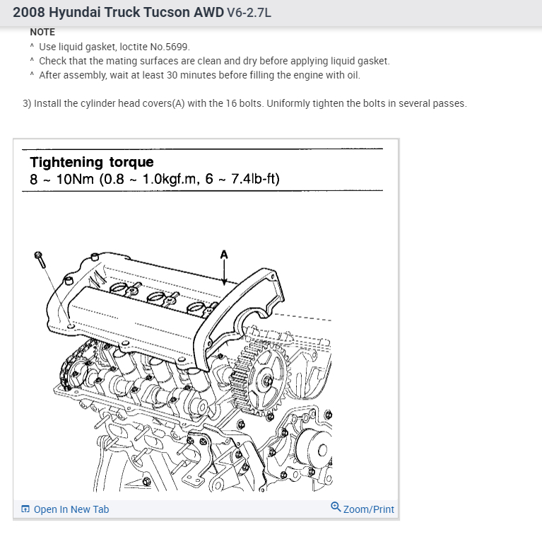

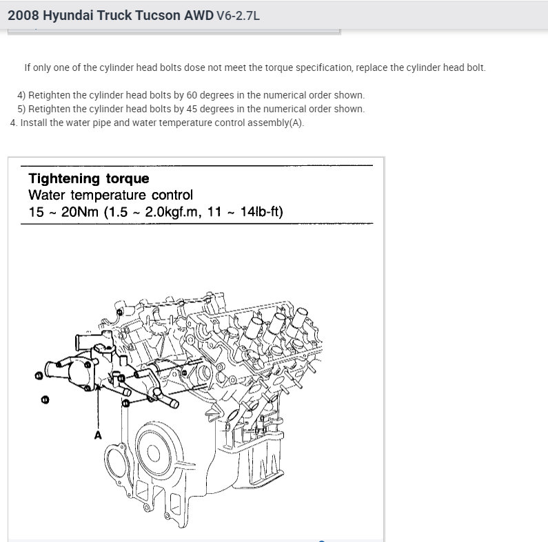

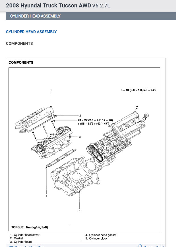

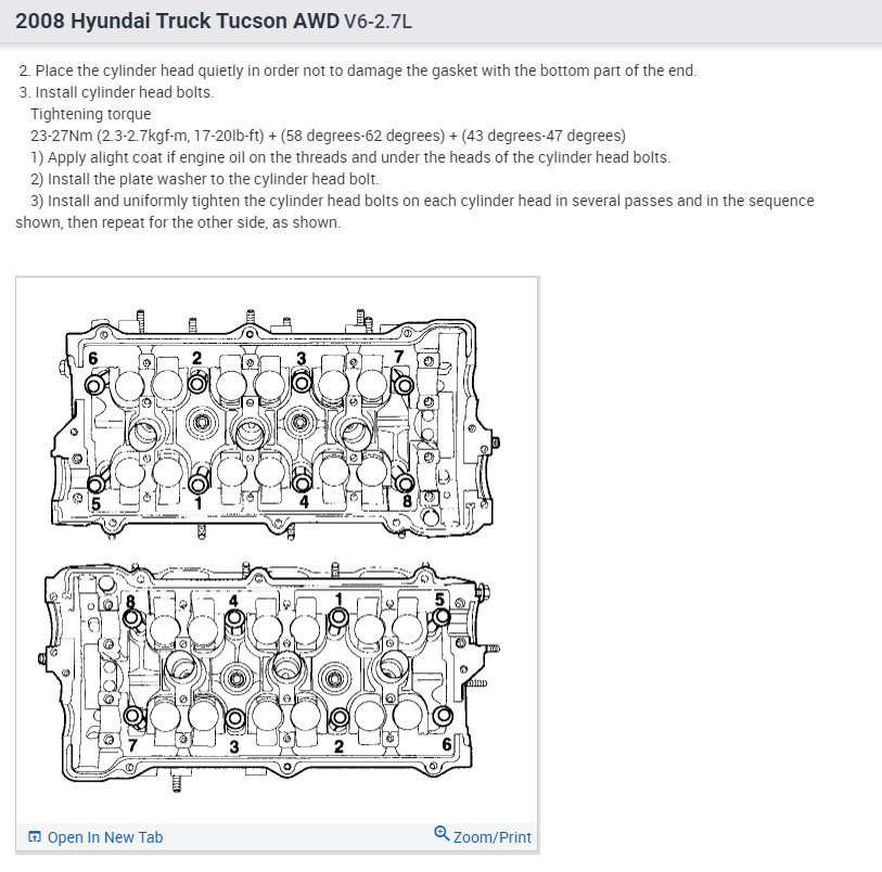

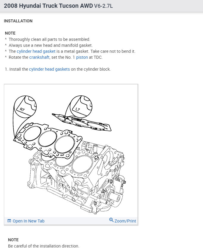

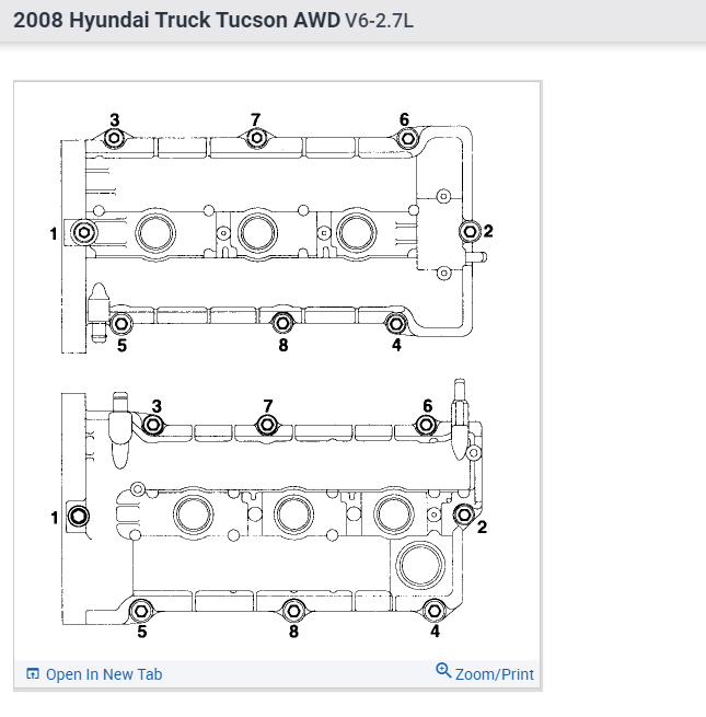

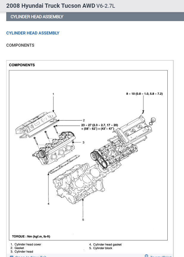

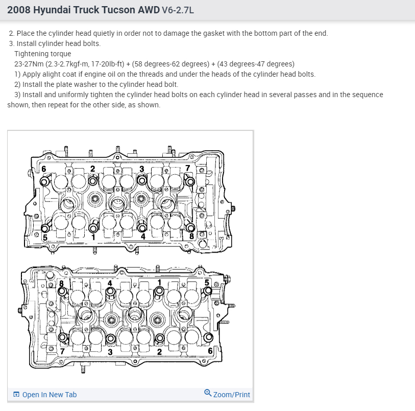

Need to know the head bolts torque.
May 7, 2022 at 5:24 PM
SQM
  • 6,383 POSTS

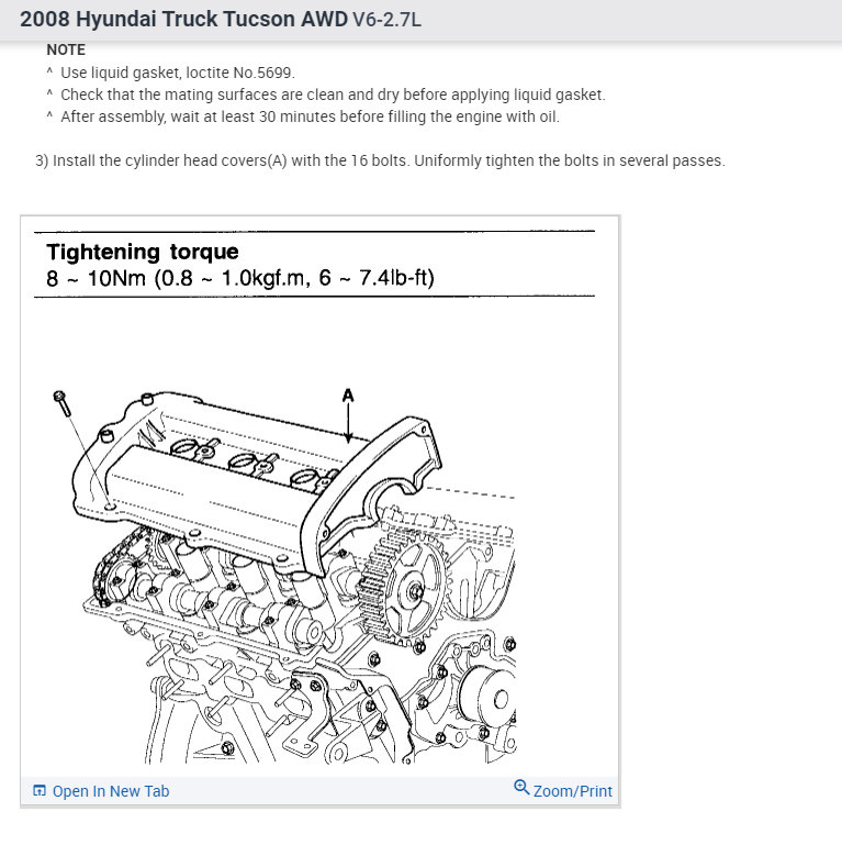

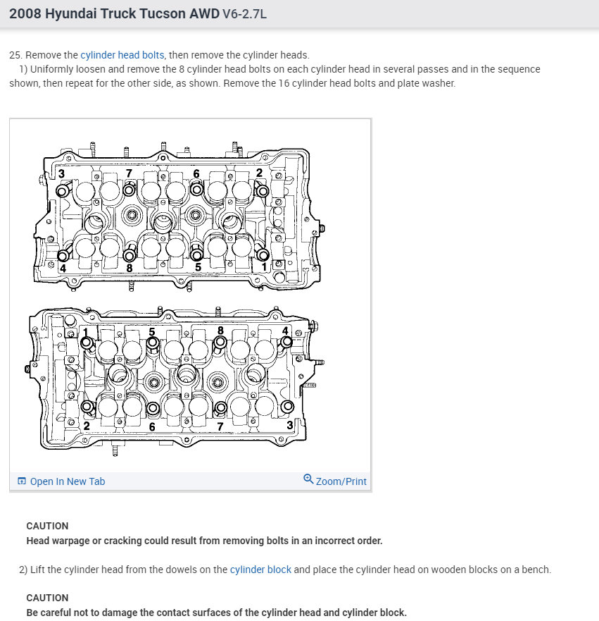

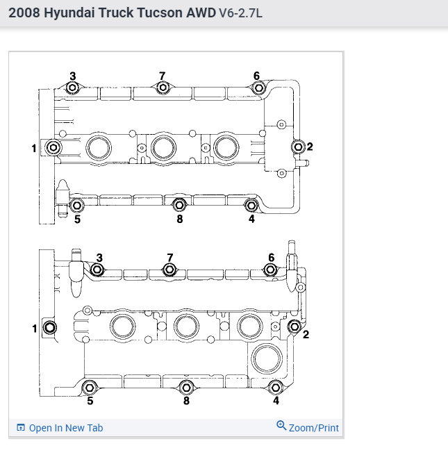

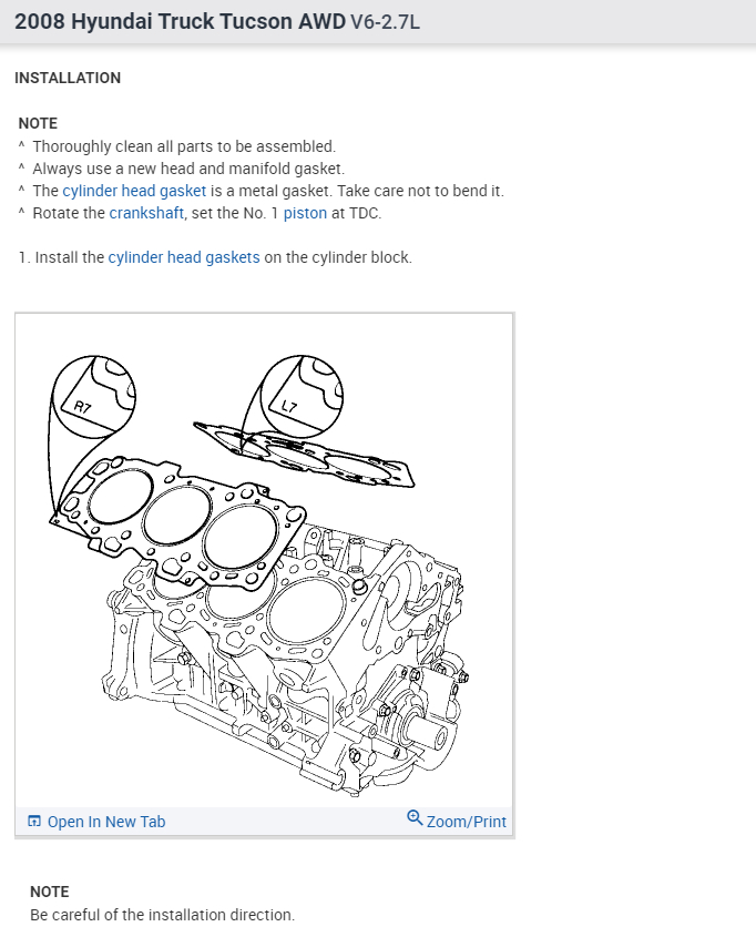

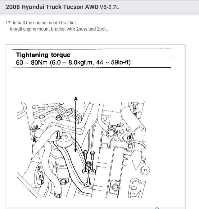

Here is the cylinder the head bolt torque specifications:
Cylinder head bolt (Cold engine) 23-27 Nm + (58 degrees-62 degrees) + (43 degrees-47 degrees) 2.3-2.7 kgf.m, + (58 degrees-62 degrees) + (43 degrees-47 degrees) 17-20 lb-ft + (58 degrees-62 degrees) + (43 degrees-47 degrees))

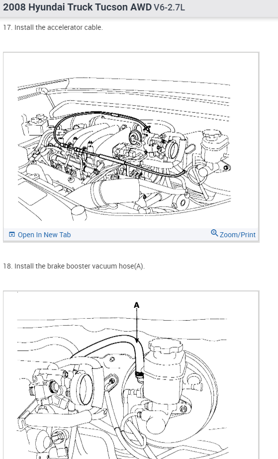

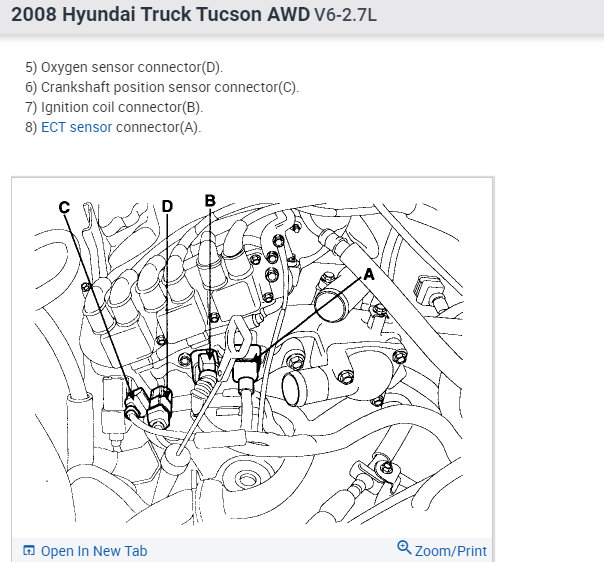

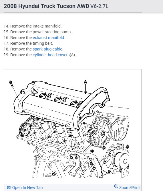

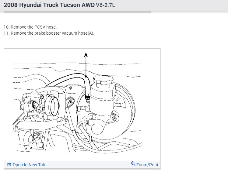

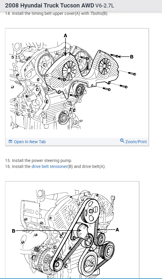

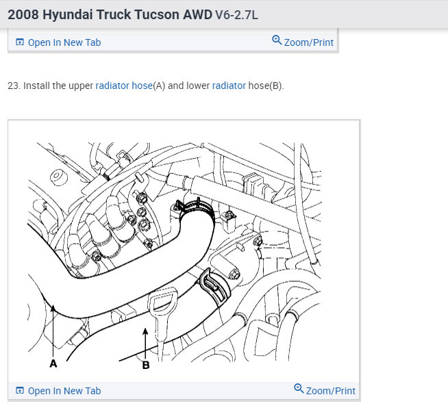

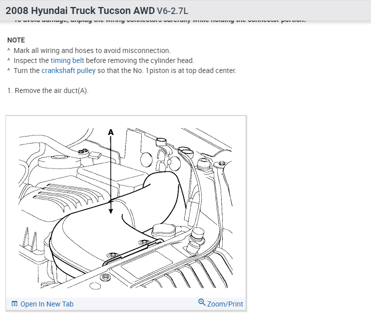

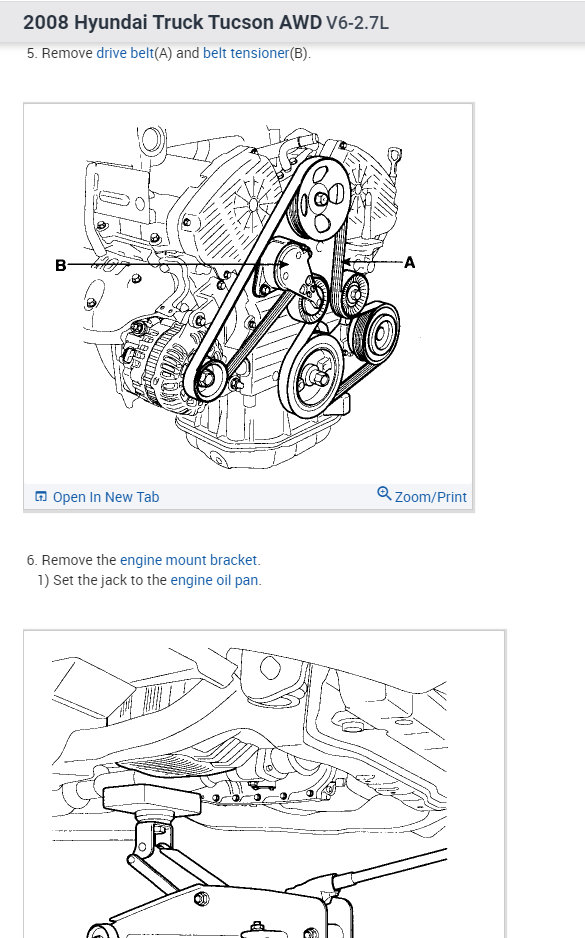

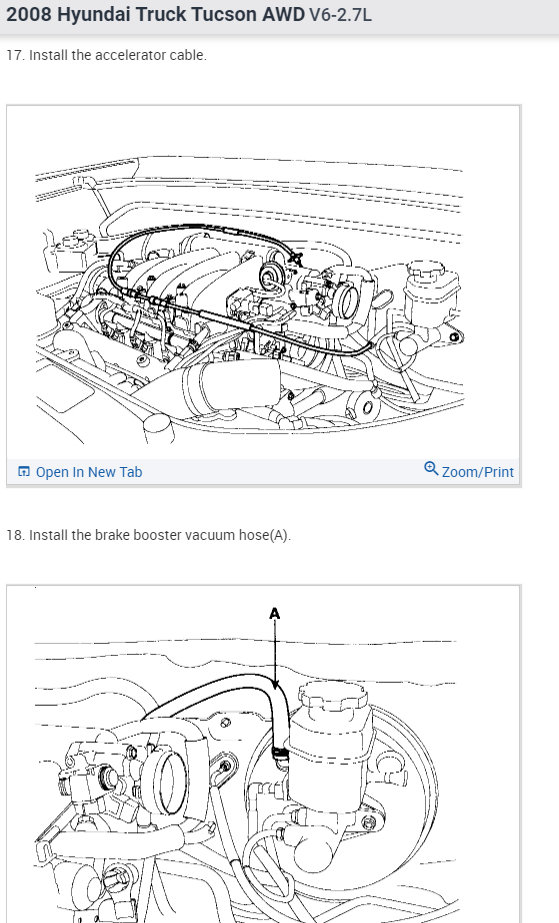

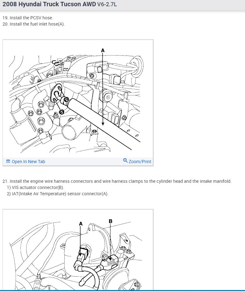

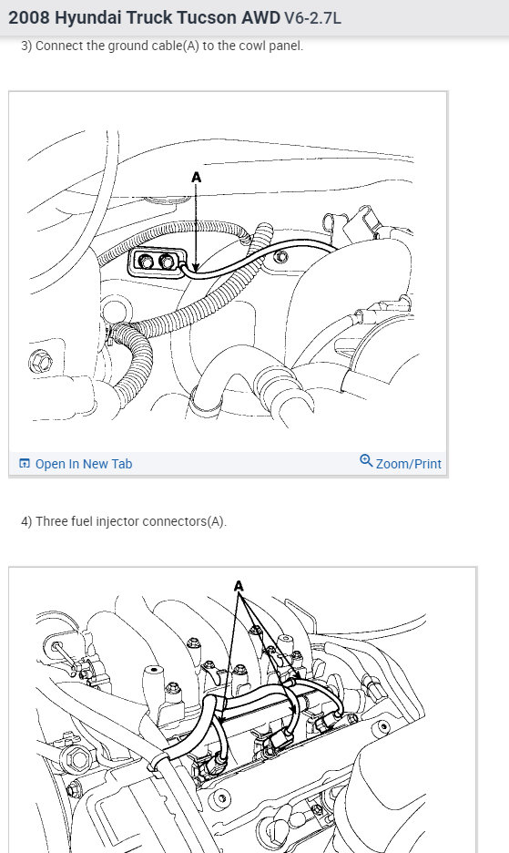

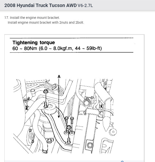

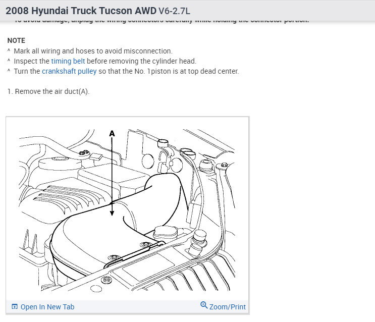

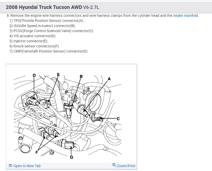

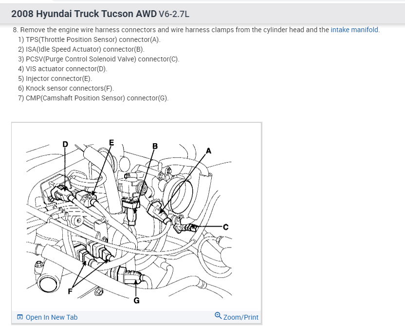

I have attached the replacement procedure with all the other bolt torque specifications as well as the sequences below.
Let me know of any questions.
https://www.2carpros.com/articles/how-a-cylinder-head-works

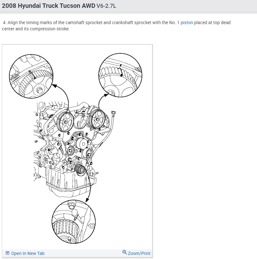

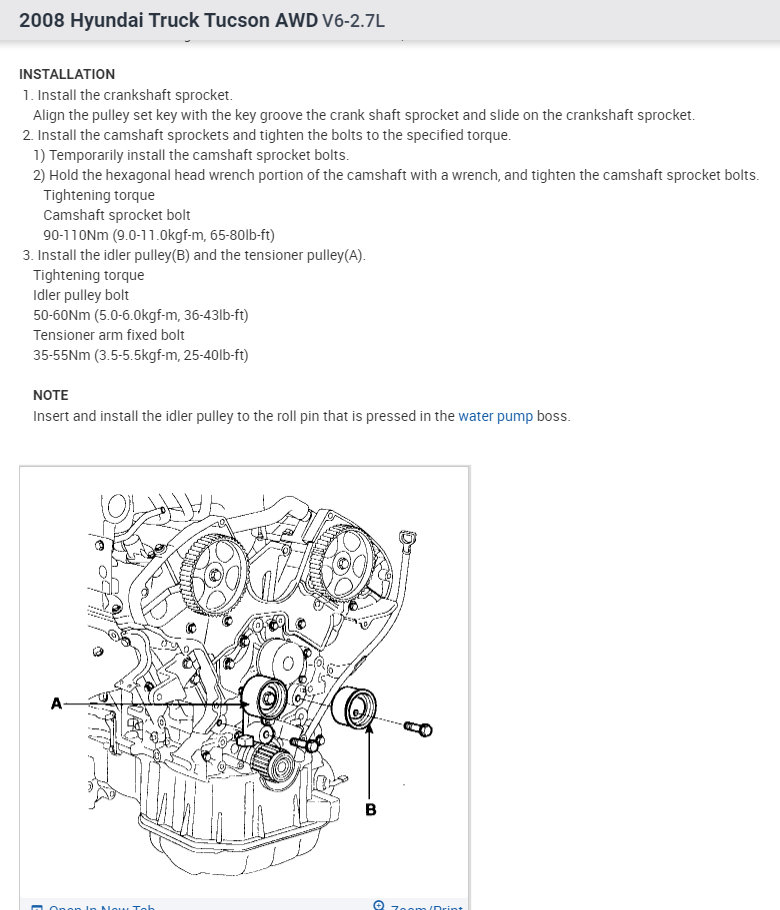

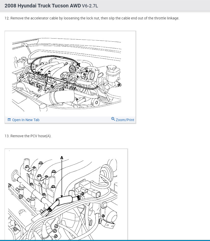

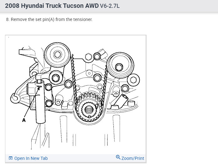

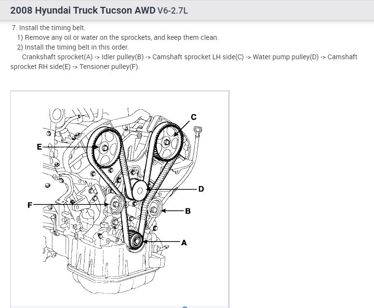

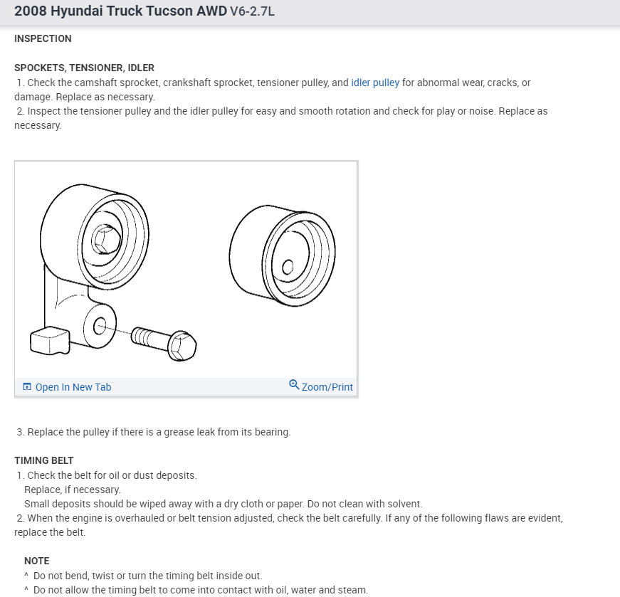

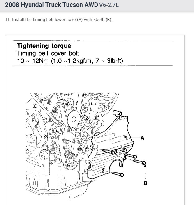

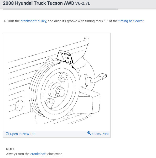

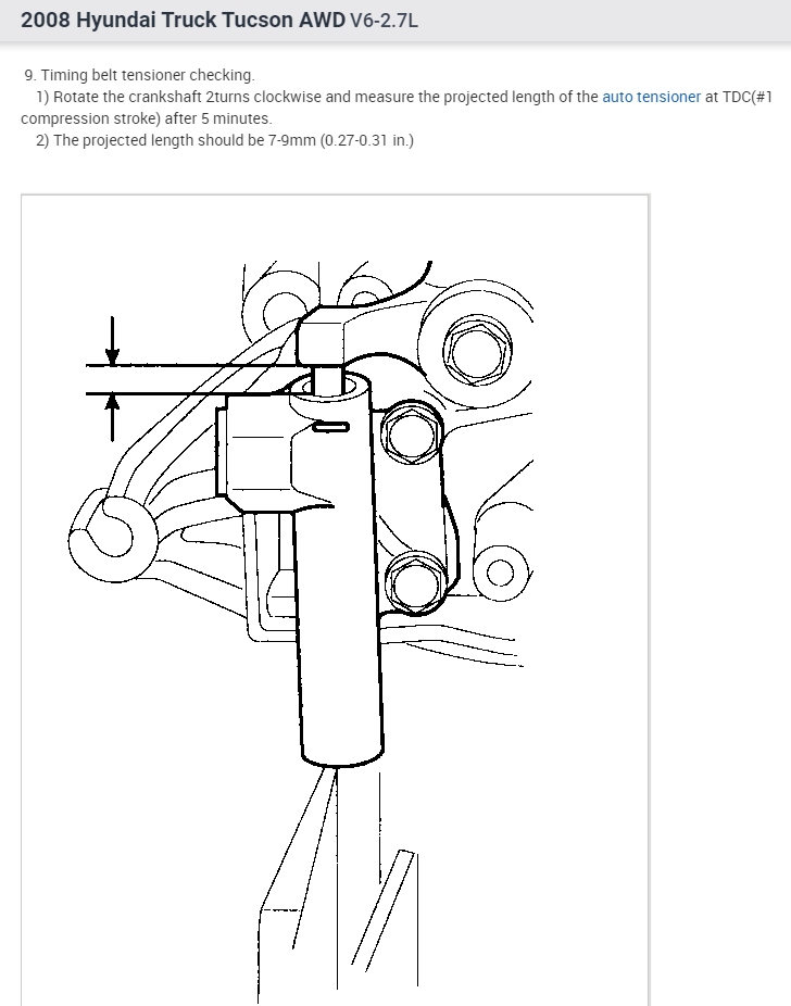

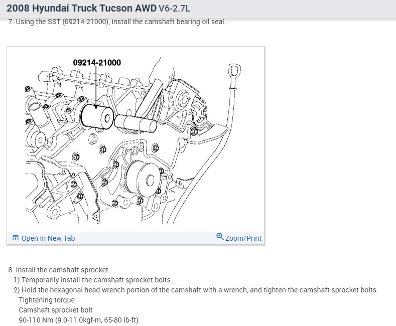

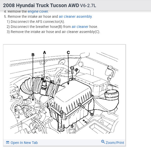

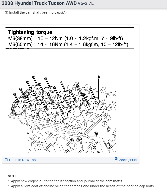

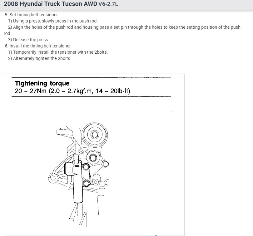

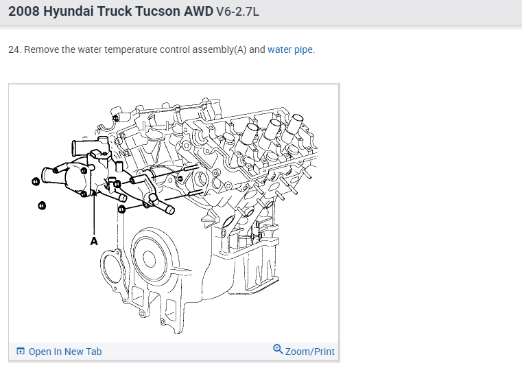

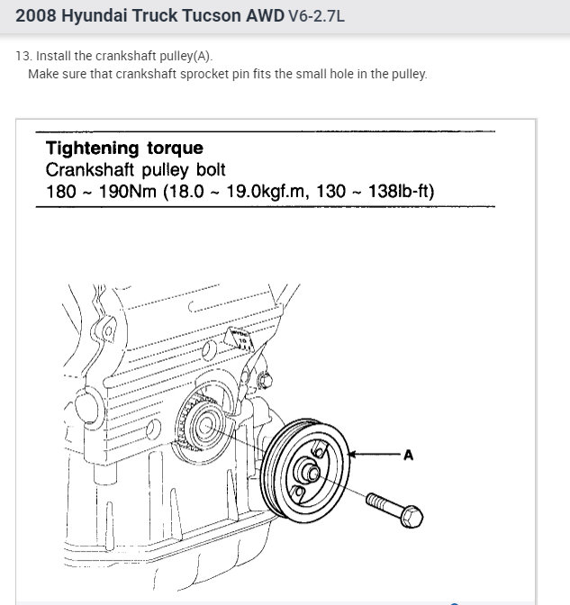

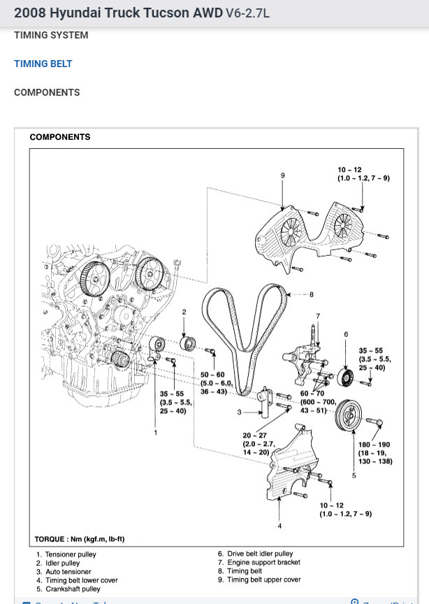

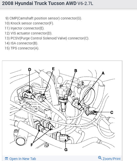

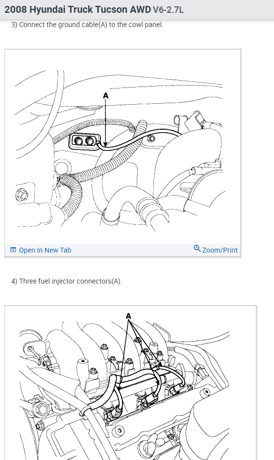

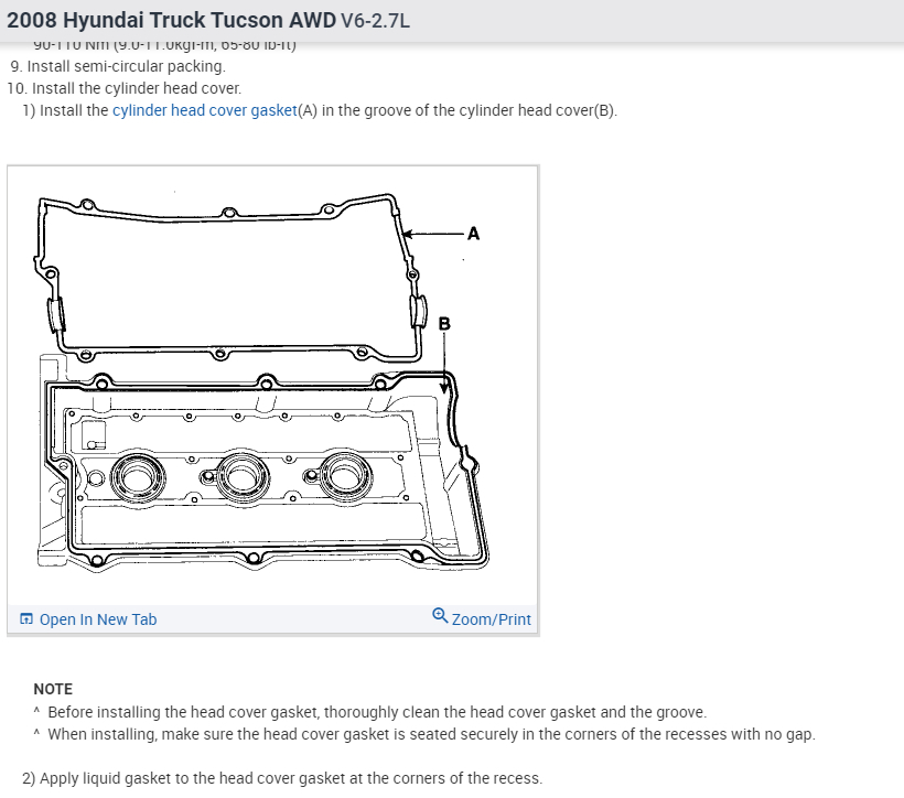

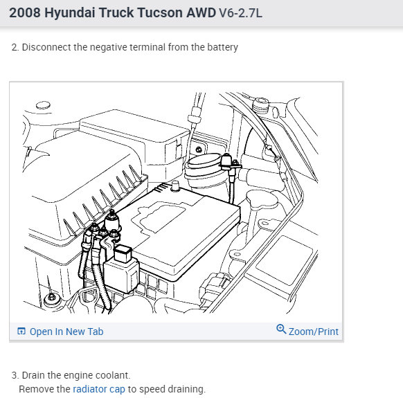

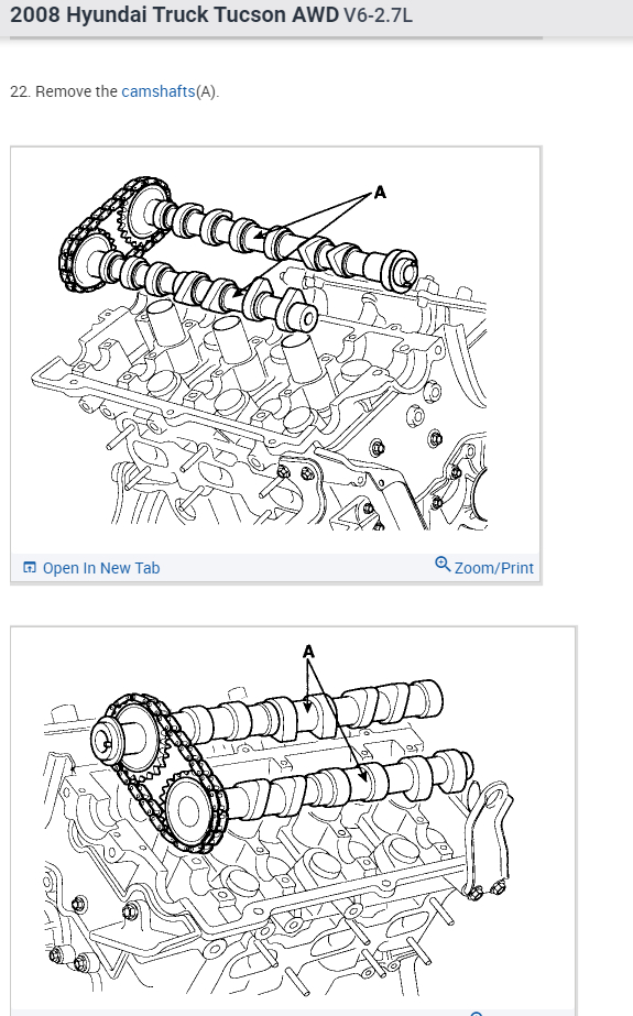

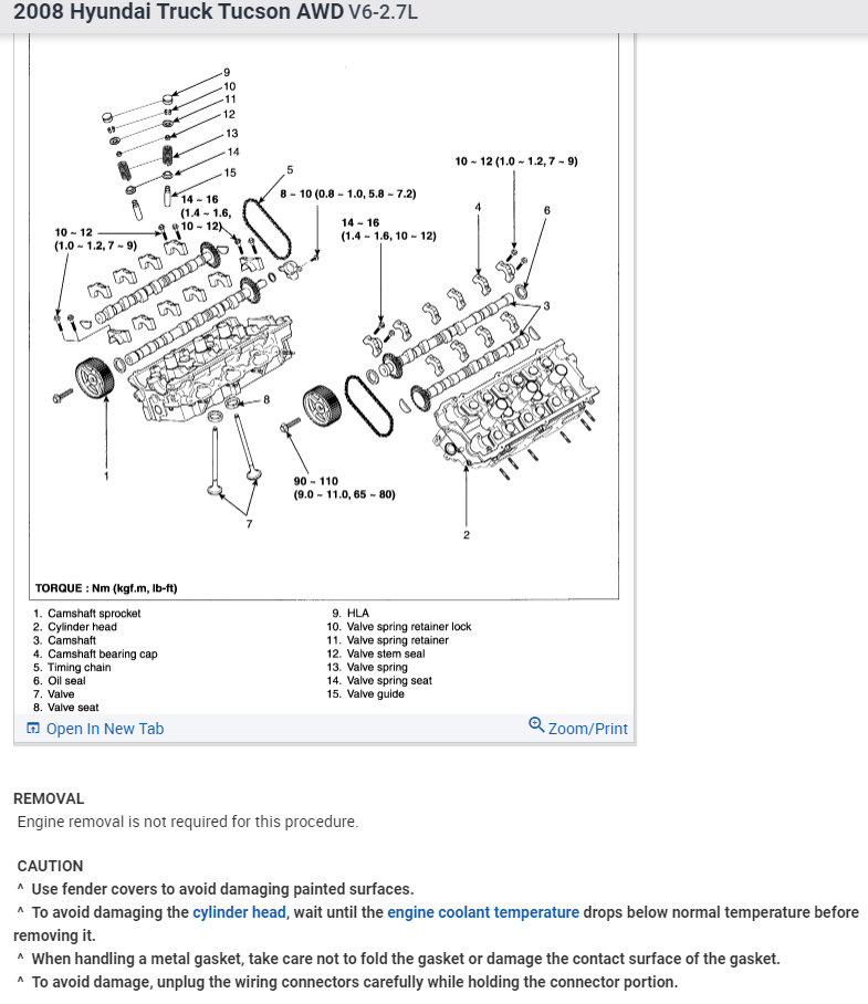

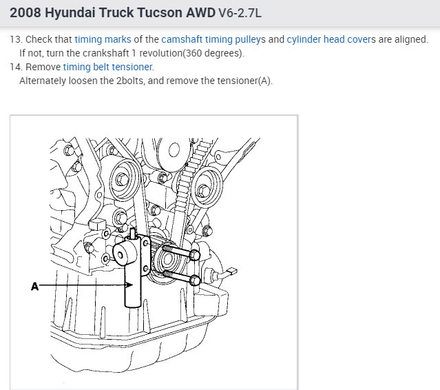

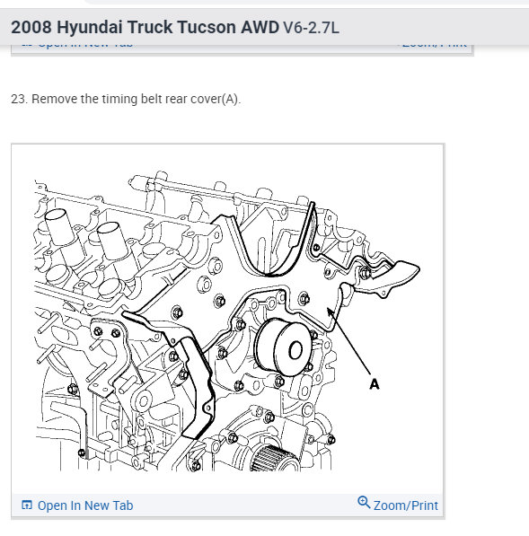

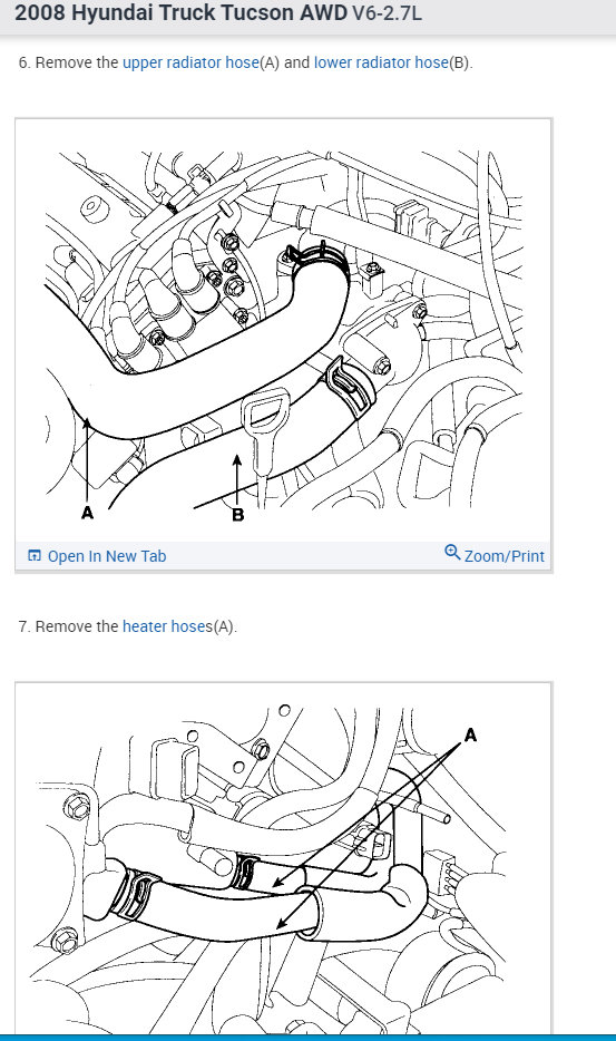

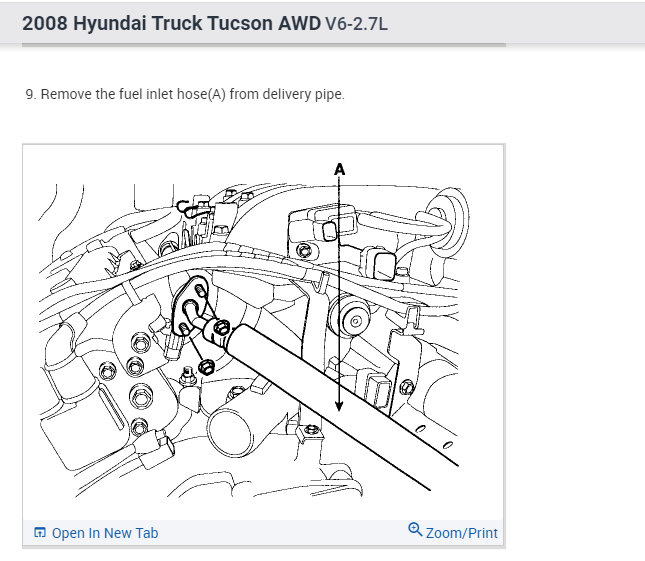

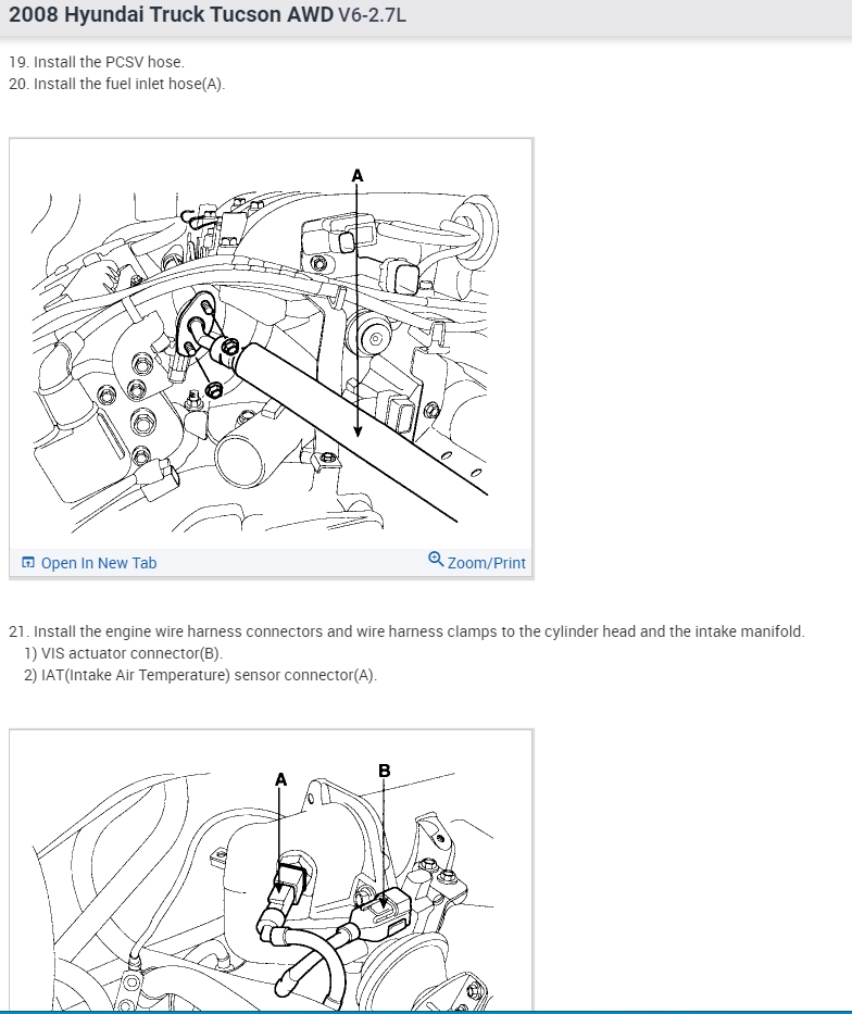

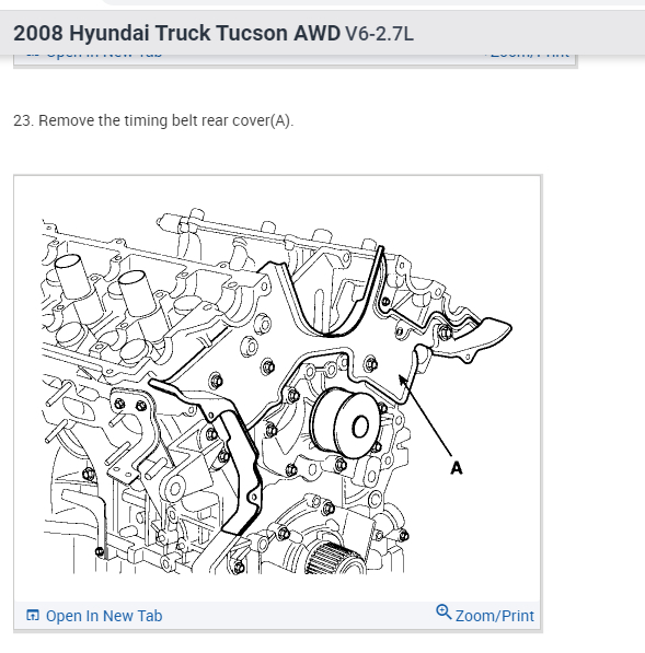

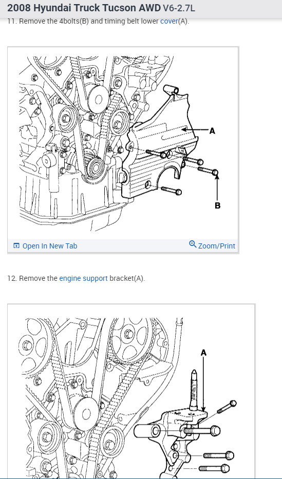

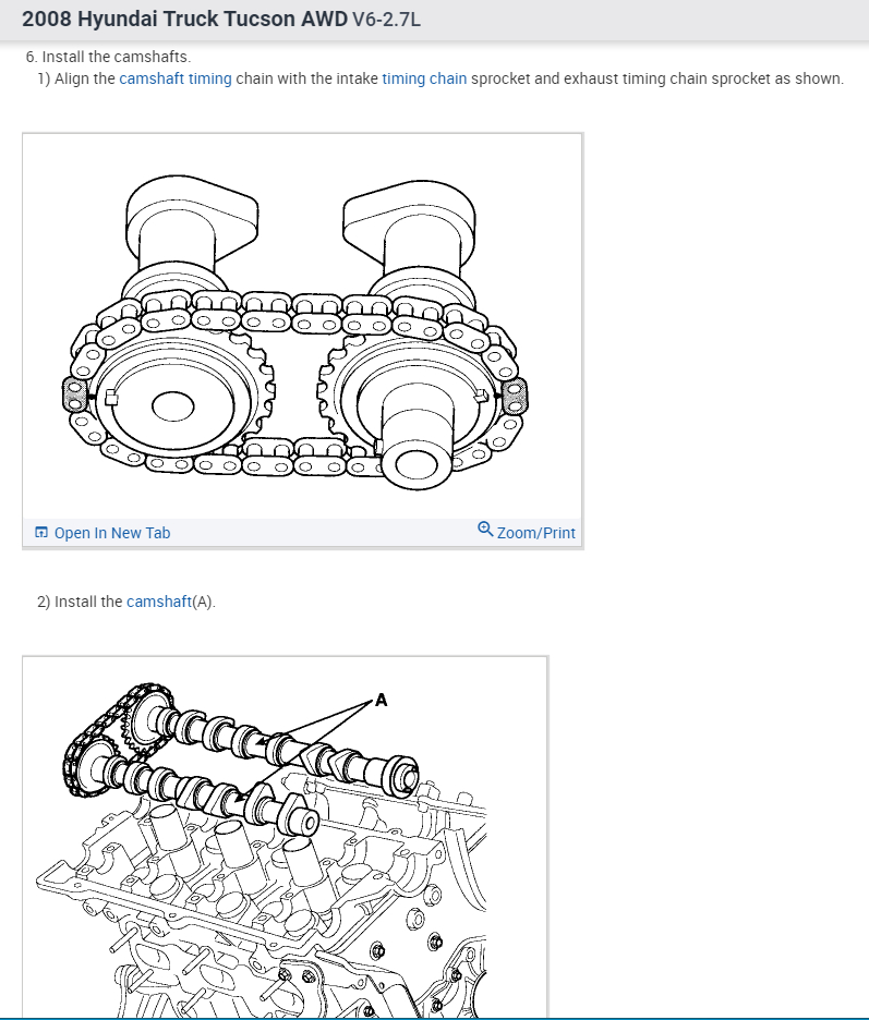

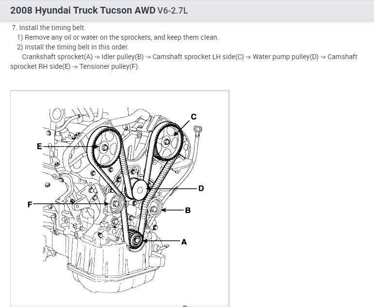

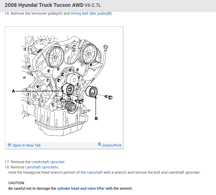

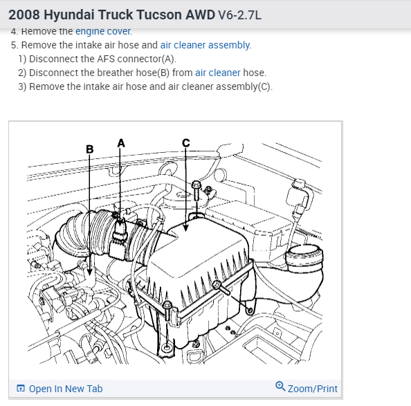

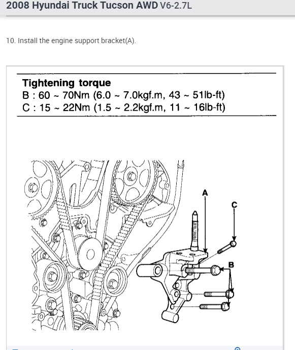

Thank you very much. This was helpful. I do have another question about 2008 Hyundai Tucson 2.7. I want to know how to time the cam chain on both heads.
May 17, 2022 at 7:35 PM
SQM
  • 6,383 POSTS

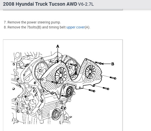

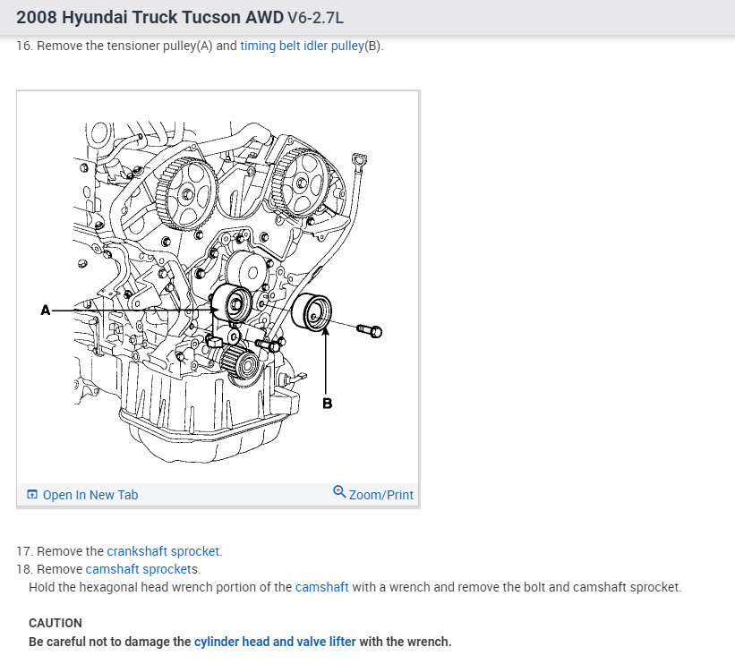

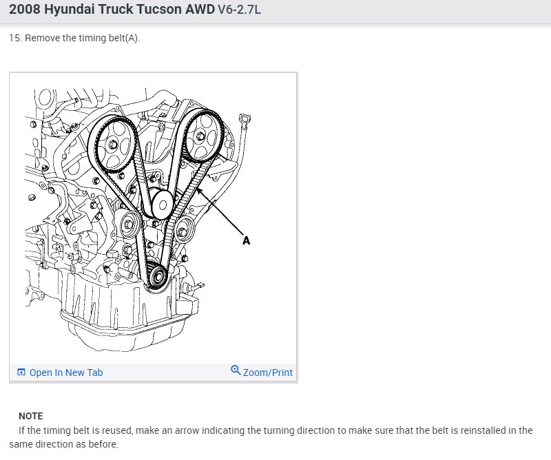

This engine has a timing belt. So are you looking for how to set proper timing after a replacement?
May 18, 2022 at 2:40 PM
ANDRAE29
  • 8 POSTS

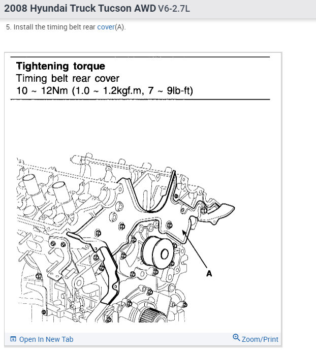

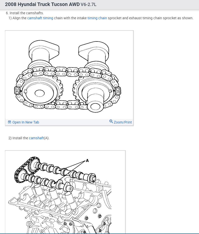

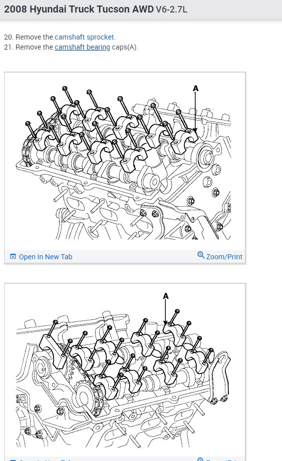

The cams have a chain that has timing marks. Cams have to be timed.
May 18, 2022 at 3:01 PM
ANDRAE29
  • 8 POSTS
Yes, how to set the timing on the cam chain on both heads?
May 18, 2022 at 3:04 PM
SQM
  • 6,383 POSTS

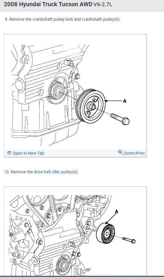

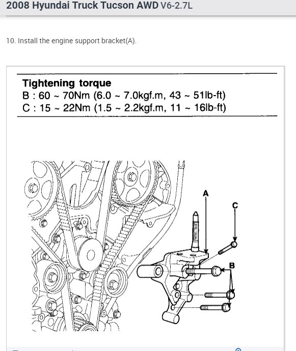

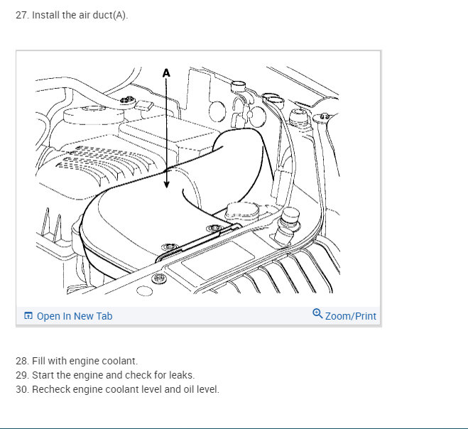

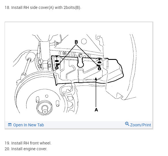

I have attached the complete timing belt replacement procedure along with the timing marks and all the torque specifications below.
