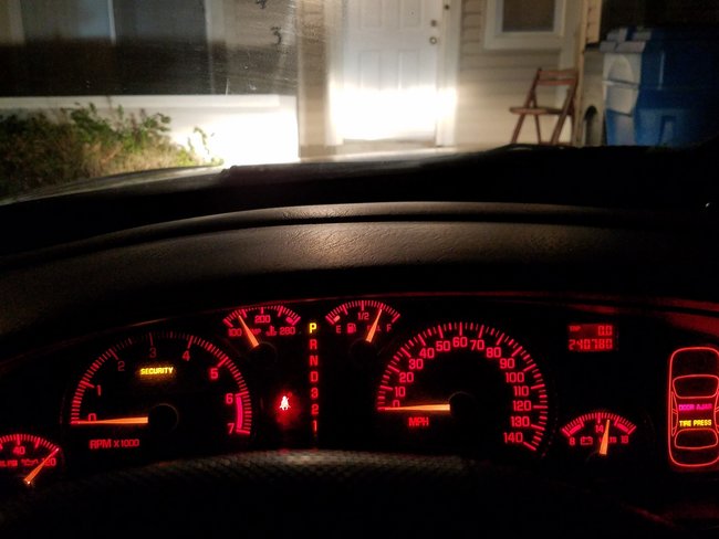

That resolution solved the issue with the hazard lights blowing fuses. The speedometer and tachometer stay at zero. They do not function at all no indication of RPMs or current speed whatsoever. The odometer also does not function and the Systems Monitor says "TIRE PRESS" even though its not low. The turn signals and cruise control also do not work. The lights on the radio does not come on. It seems to be an issue with the instrument cluster. Help

JAMES JORDAN
  • 5 POSTS
Here is a copy of the cluster screen shot.
Nov 20, 2017 at 1:33 PM
  • 55,433 POSTS
I would disconnect the battery for 5 minutes and then reconnect it to see if the cluster resets
