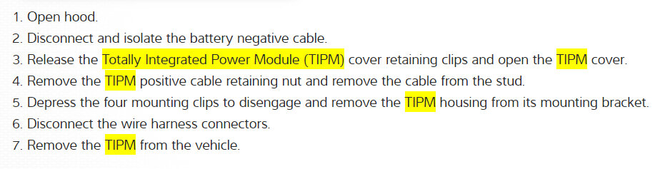

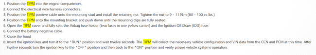

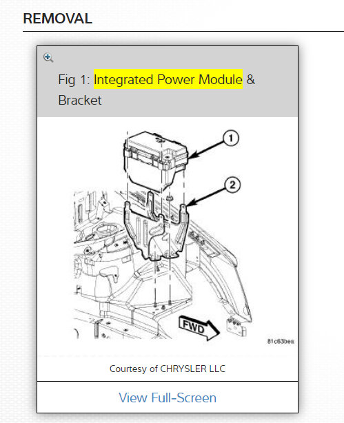

So, this happens when the TIPM goes out which is easy to replace because it-self learns, here is the location and how to replace it in the diagrams below. Check out the images (below). Please let us know if you need anything else to get the problem fixed.
