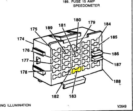

All lights work. Turn signals work normally. When hazard button is pressed, hazards do not come on. When brake pedal is pressed turn signals come on but do not flash. Any help?

When you press the brakes, which lights come on, exterior signal (front and rear) or the signal indicator lights on the instrument panel? First, there is a good chance the hazard switch is bad. As far as the signal lights, if you mean they stay on but stop flashing when the brake is applied, we could have a ground issue.
Fuse 183 in the attached pic provides power for both the signals and the hazard lights, so that isn't an issue.

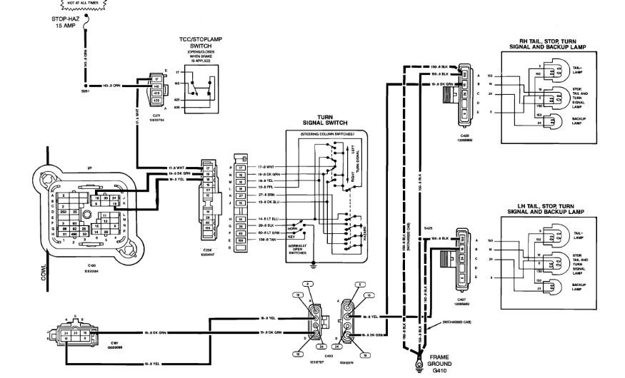

Also, I attached a copy of the wiring schematic for the signal and brake lights. Everything is tied together as you will see.
It wasn't uncommon for the tail light assembly which has a printed circuit board in it to fail. Have you checked everything there? A short, ground issue or damaged connectors could cause the issue.

Do me a favor. Disconnect the brake light switch and see if they work. Something is either causing power to back feed to the switch or there is a ground issue. The schematics are somewhat difficult to follow, and due to the model year, they are quite limited.
