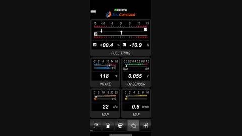

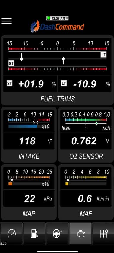

I do have scanner, catalysts I already removed and refixed with new gaskets, engine have little vibration in idle I noticed.
Symptoms in visible:
1. little vibration in idle.
2.fuel tank pressure always when open the lid.
3.worst gas mileage getting.
I’m attaching one video before I recorded
Later I’ll do with think diag and upload.
Thanks a lot.

In a perfect world, the fuel trims would be 0%, but that isn't usually the case. I noted the long-term fuel trims stay at -10.4% and then drop to -5%. What was happening when that happened? The idea that they are -10+% tells me the computer is trying to lean the fuel mixture.
Have you checked the fuel pressure? Something is causing more fuel to enter the combustion chamber than the computer wants. The STFT looks great, but the LTFT indicates a possible issue.
Next, I noticed the MAF reading really isn't changing. Was the engine at idle the entire time? The normal mass airflow (MAF) readings in a car can vary depending on the make, model, and engine type. MAF readings are typically measured in grams per second (g/s) and can range from around 2 to 150 g/s. Yours is staying at 0.6 and really not changing. Has anyone checked the MAF? Does the reading change based on engine load?
I'm not sure what to do with the MAP readings. According to two manuals, the vehicle only has a MAF and there is no MAP.

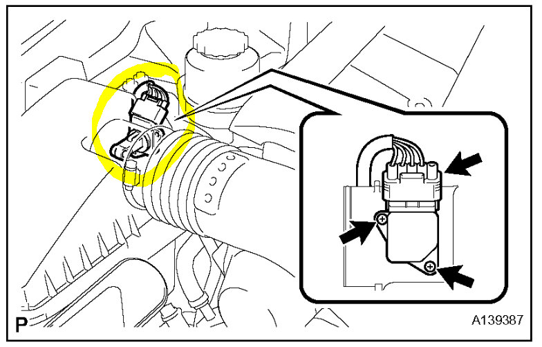

I attached a pic of the MAF sensor location below. If nothing has been done with it, remove and clean it.
Here is a link that explains how it's done:
https://www.2carpros.com/articles/mass-air-flow-service
Let me know if that makes any difference. If after cleaning the readings don't change, the MAF itself is the likely problem.
See pic below.

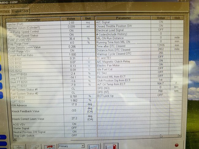

FAJ
  • 5 POSTS
Hello Jacob, I’m attaching the picture from tech stream data vehicle was in idle on both time when I did the test, mag sensor I replaced as well . Forgot to mention , fuel pressure didn’t check yet.
Thanks a lot

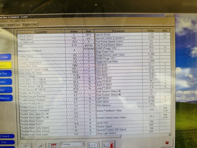

FAJ
  • 5 POSTS
Hello Jacob I’m attaching the picture from tech stream data vehicle was in idle on both time when I did the test ,mag sensor I replaced as well . Forgot to mention , fuel pressure didn’t checked yet
Thanks a lot

  • 110,236 POSTS
The only thing I'm seeing is the long-term fuel trims indicate the control module is trying to reduce the amount of fuel entering the engine. The oxygen sensor voltages look good as well. So, in my mind, we have a fuel pressure issue or faulty injectors.

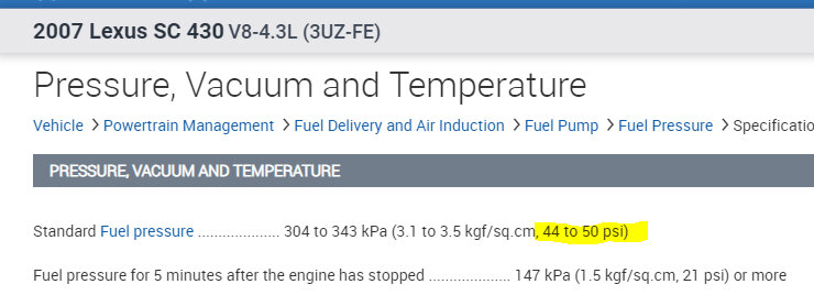

  • 110,236 POSTS
When I say fuel pressure issue, I mean the regulator may be failing and allowing pressure to get too high. Take a look through this link:
I attached the manufacturer's fuel pressure specifications below.
Let me know what you find.
See pic below.
