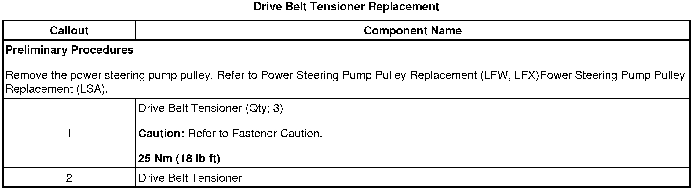

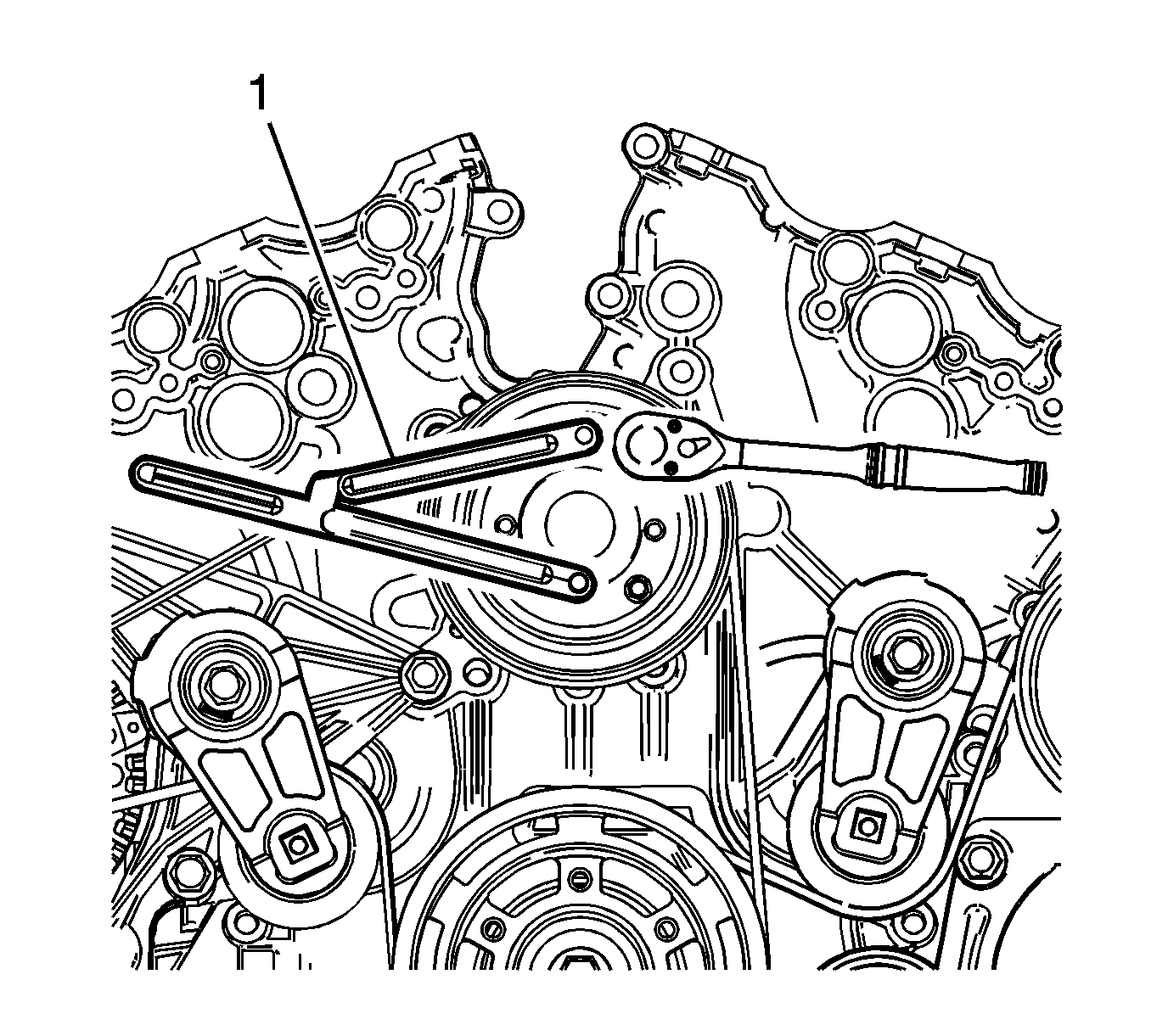

Changed belt still squealing notice water pump pulley has a slight wobble.
May 27, 2019 at 10:38 PM
  • 110,244 POSTS
Welcome to 2CarPros.

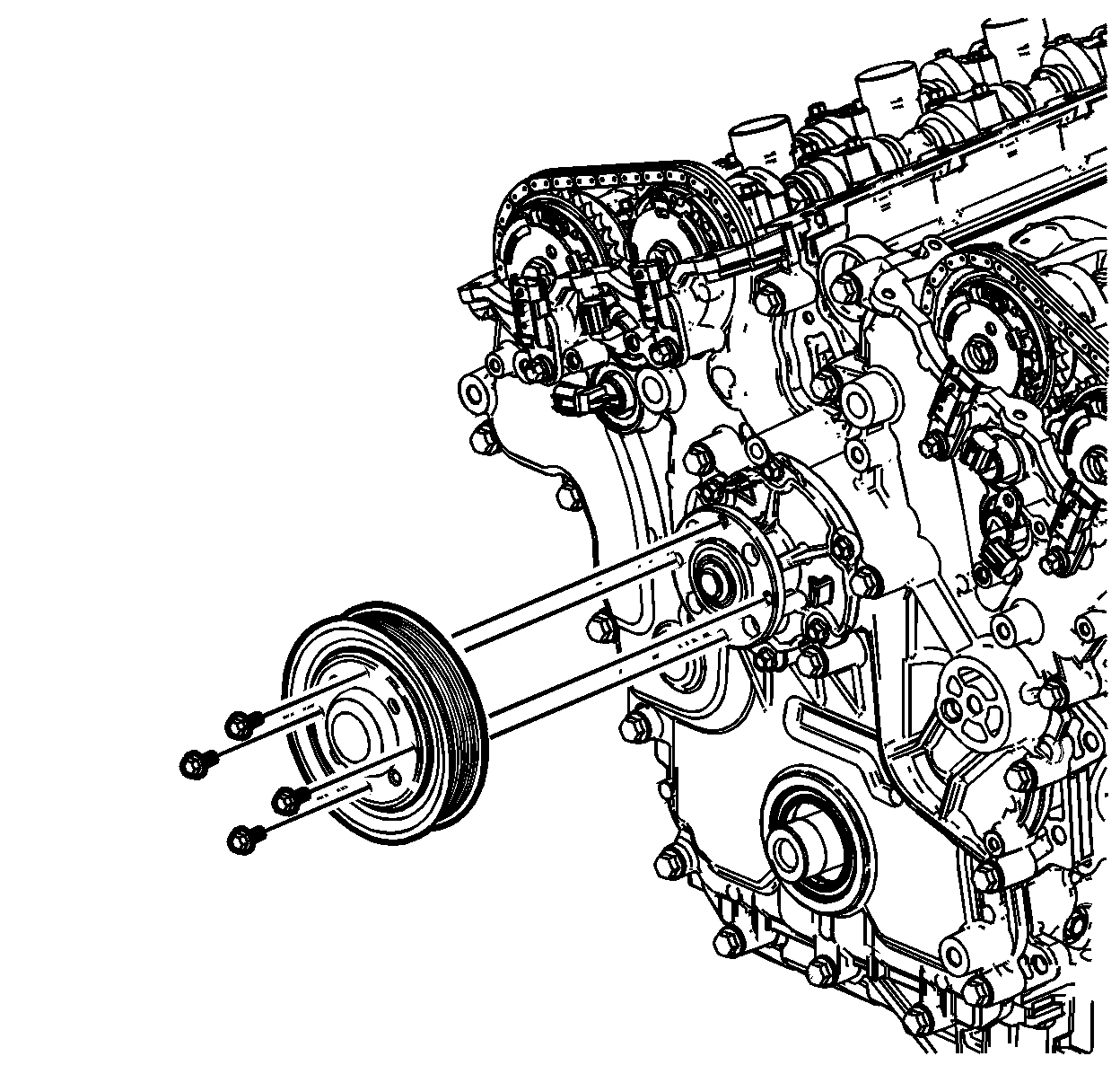

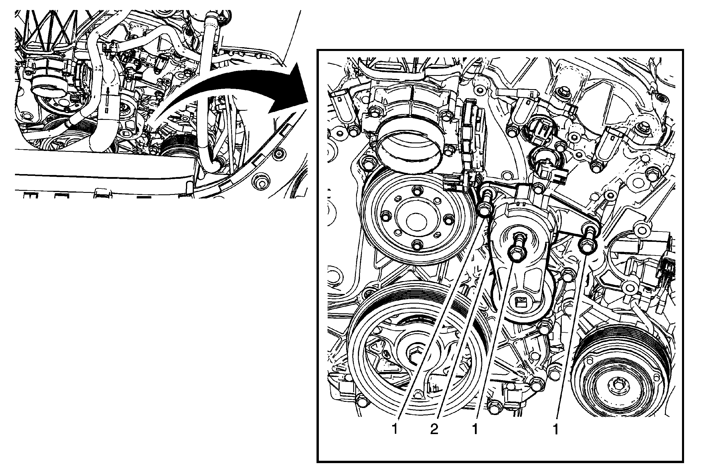

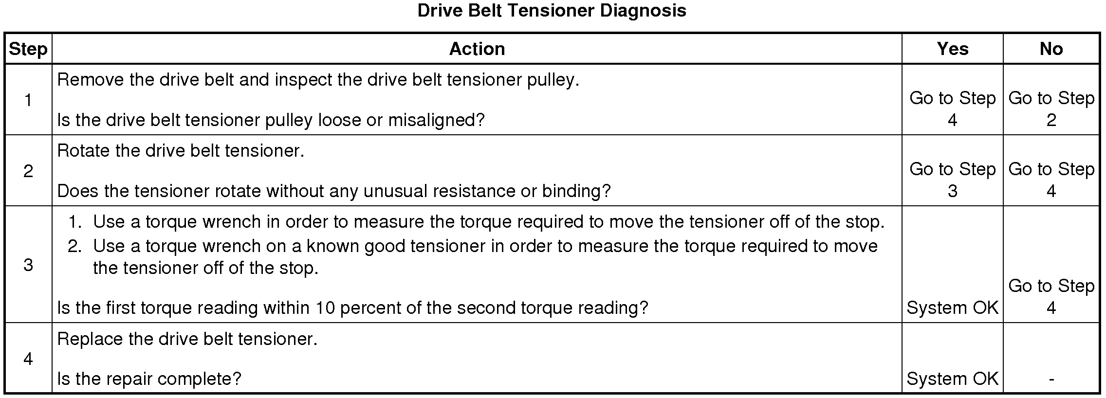

See if there is play in the water pump pulley. The bearing may be bad. Also, are you sure the belt is tight enough? The automatic tensioner may be weak.
If you look at picture 1, it explains how to check the tensioner.

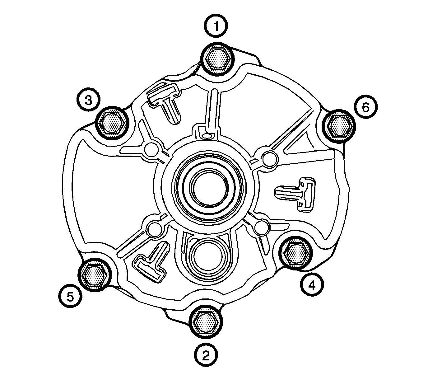

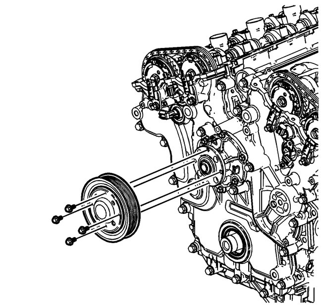

If you find it is bad, the directions for replacement are in pictures 2 and 3. Here is a link that shows in general how one is replaced:

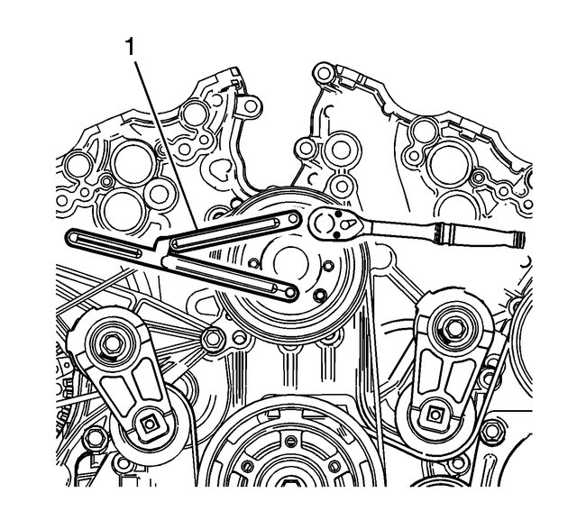

3. Use the EN 46104 - water pump pulley holding tool (1) in order to retain the water pump pulley.
pic 5
4. Remove the water pump pulley bolts and DISCARD the bolts.
Caution: This vehicle is equipped with torque-to-yield or single use fasteners. Install a NEW torque-to-yield or single use fastener when installing this component. Failure to replace the torque-to-yield or single use fastener could cause damage to the vehicle or component.
5. Remove the water pump pulley.

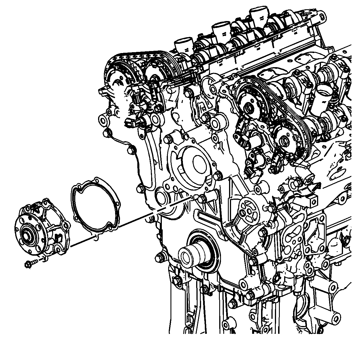

6. Remove the water pump bolts and DISCARD the bolts.
7. Remove the water pump.
8. Remove and DISCARD the water pump seal.
9. Carefully clean the water pump sealing surfaces.
Installation Procedure
pic 7
1. Install a NEW water pump seal.
2. Install the water pump.

3. Install the NEW water pump bolts and hand tighten the water pump bolts.

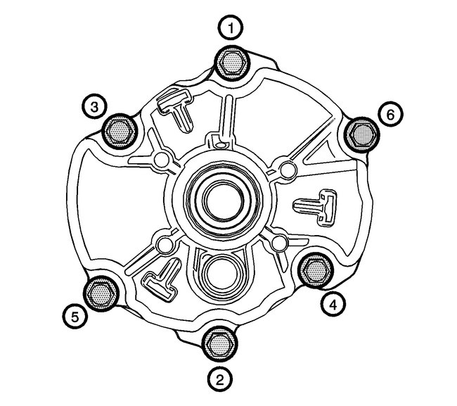

pic 8
4. Tighten the water pump bolts in sequence.
1. On the initial pass, tighten the bolts in sequence to 10 Nm (89 lb in).
2. On the second pass, tighten the bolts in sequence to 10 Nm (89 lb in).
3. On the final pass, tighten the bolts in sequence shown an additional 45 degrees.
pic 9
5. Install the water pump pulley and the NEW water pump pulley bolts.
pic 10
6. Use the EN 46104 - water pump pulley holding tool (1) in order to retain the water pump pulley.
7. Install the water pump pulley bolts and tighten to 12 Nm (106 lb in).
