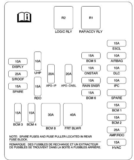

fuse panels trunk was open, and sometimes it won't open I will check the fuses first
2011 CADILLAC SRX
75,000 MILES • 3.8L • 6 CYL • FWD • AUTOMATIC
MARK BAYLESS
It's electric, sometimes it opens all the way,sometimes it starts to open,stops and closes back up,sometimes it won't work at all,one time i went in a store and came out and the trunk was all the way open,another time all the windows were down and the trunk was open, and sometimes it won't open at all, is there a bad relay switch ? I need to check the fuses?
Aug 26, 2016 at 2:51 AM

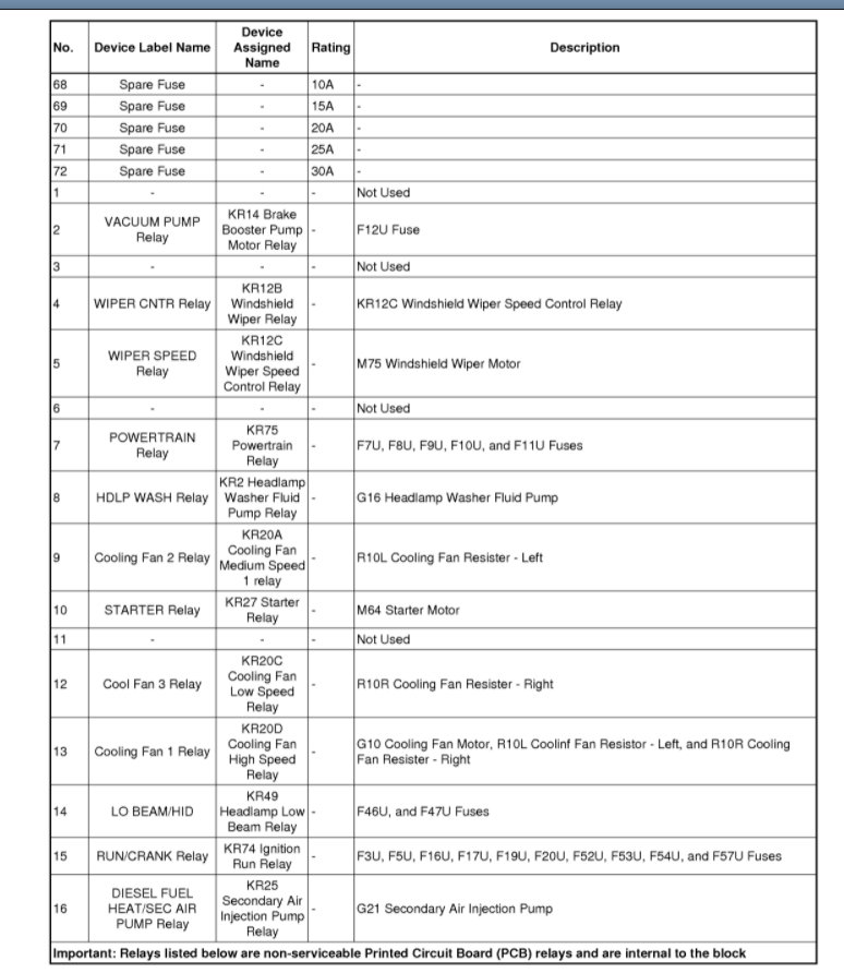

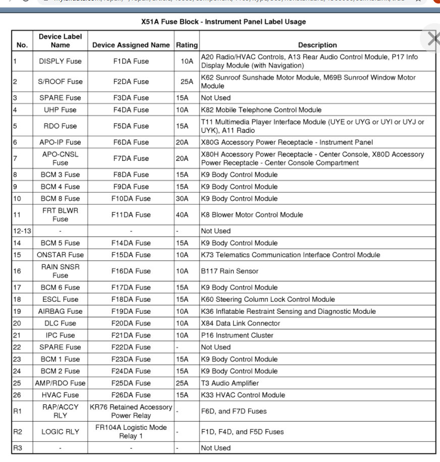

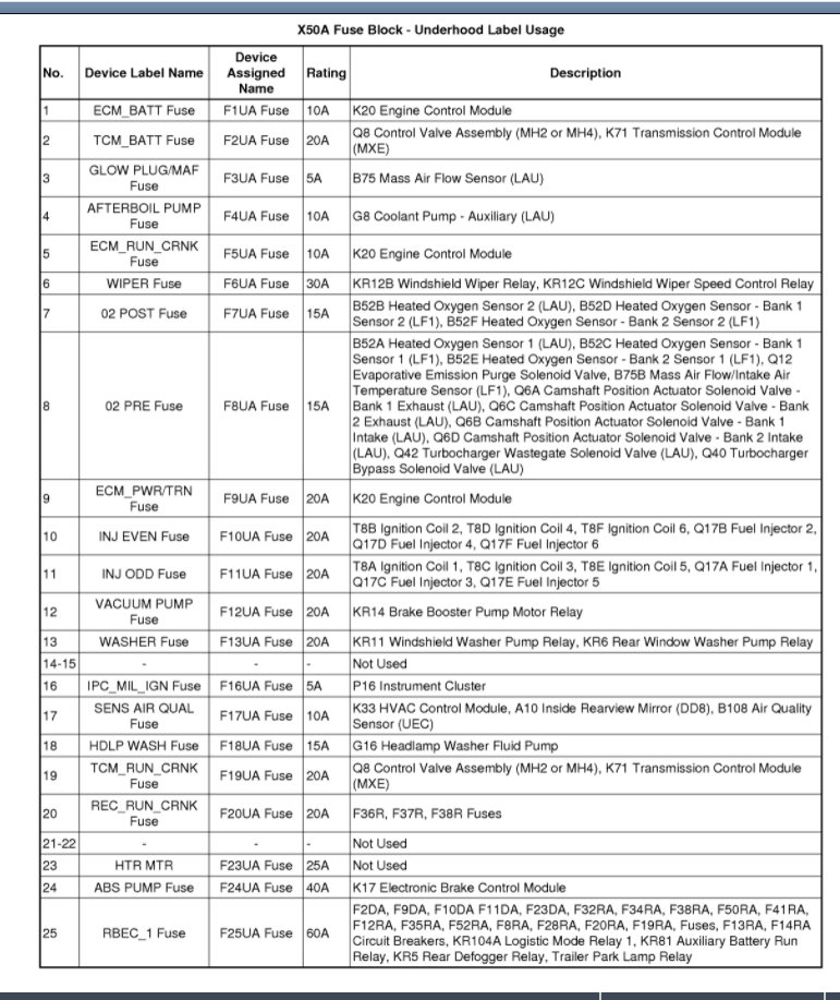

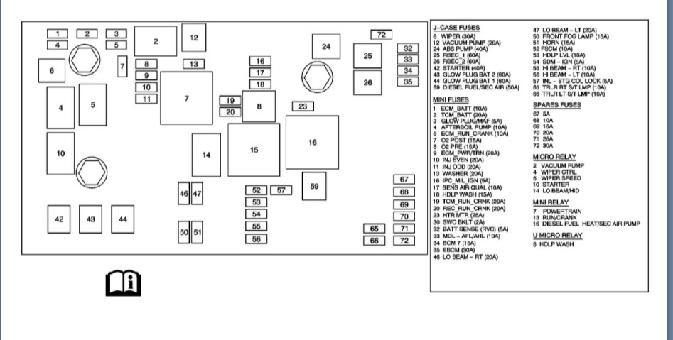

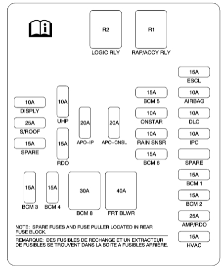

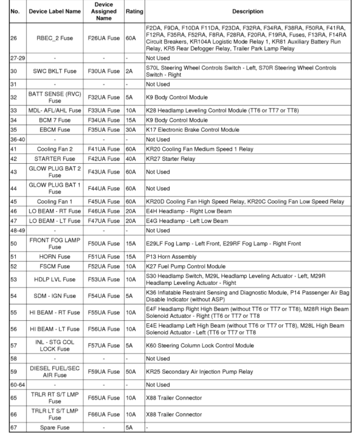

Here is a guide that will help with testing and replacing fuses. Please let us know if you have more questions on this info.

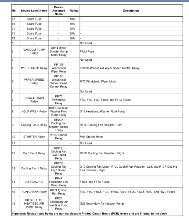

Below you will find the info from the manual that will give the detail on the fuses.
Please let me know if you have other questions. Thanks
