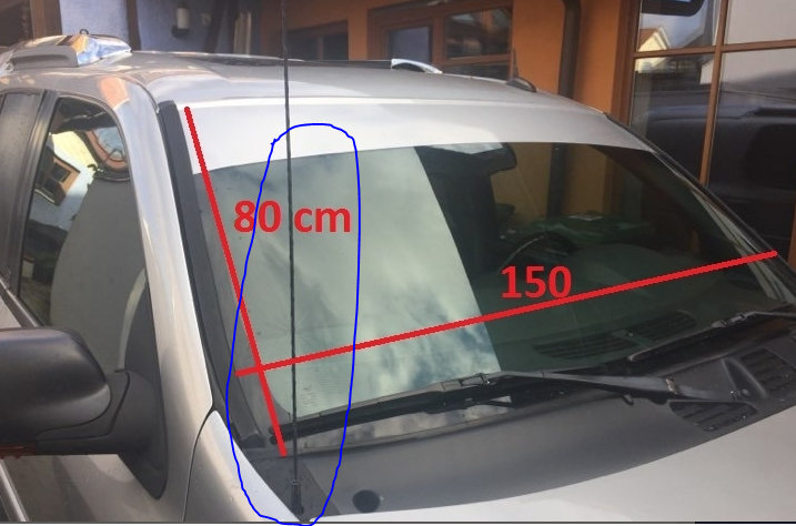

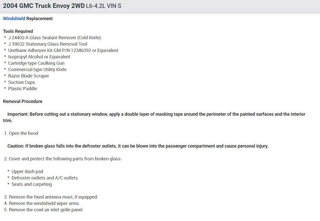

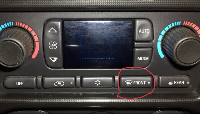

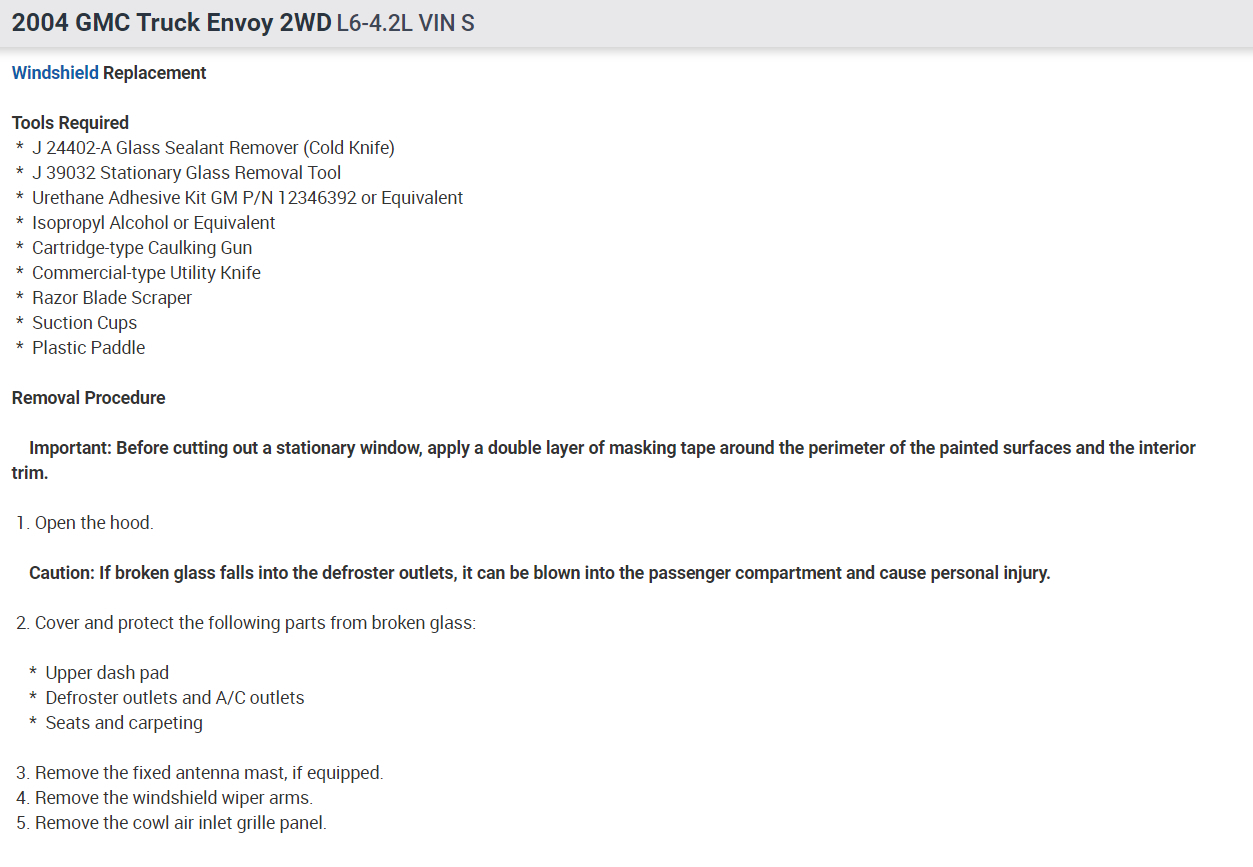

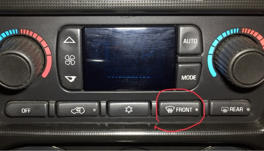

I have to replace cracked front window in my 2004 GMC Envoy XUV, full loaded. Picture 1 shows I have heated front window but my window doesn't have thin wire in glass and I believe it's not original it's aftermarket. My question is, does my car have heated front window?
Thank you
With best wishes
Paul

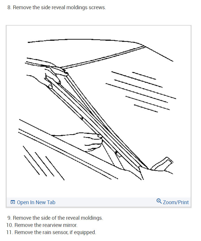

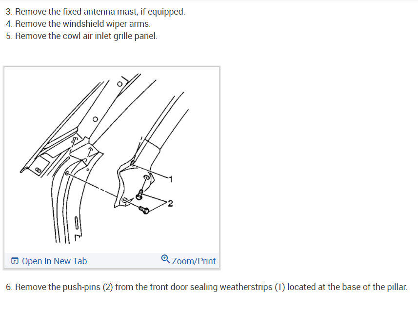

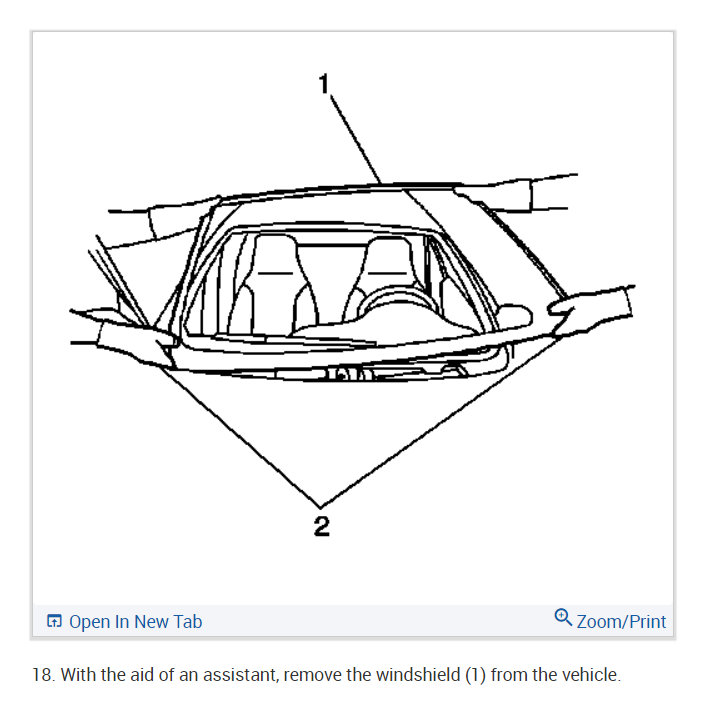

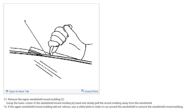

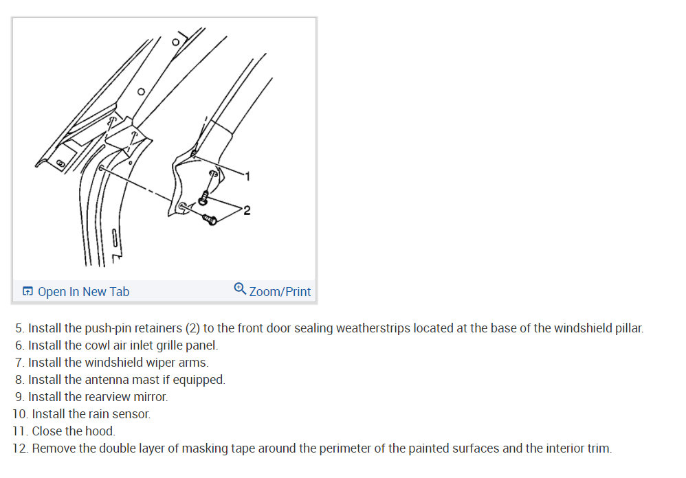

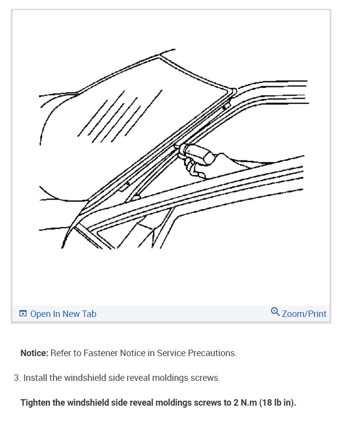

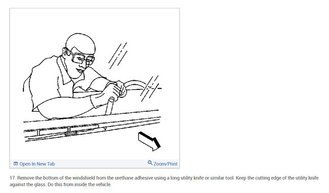

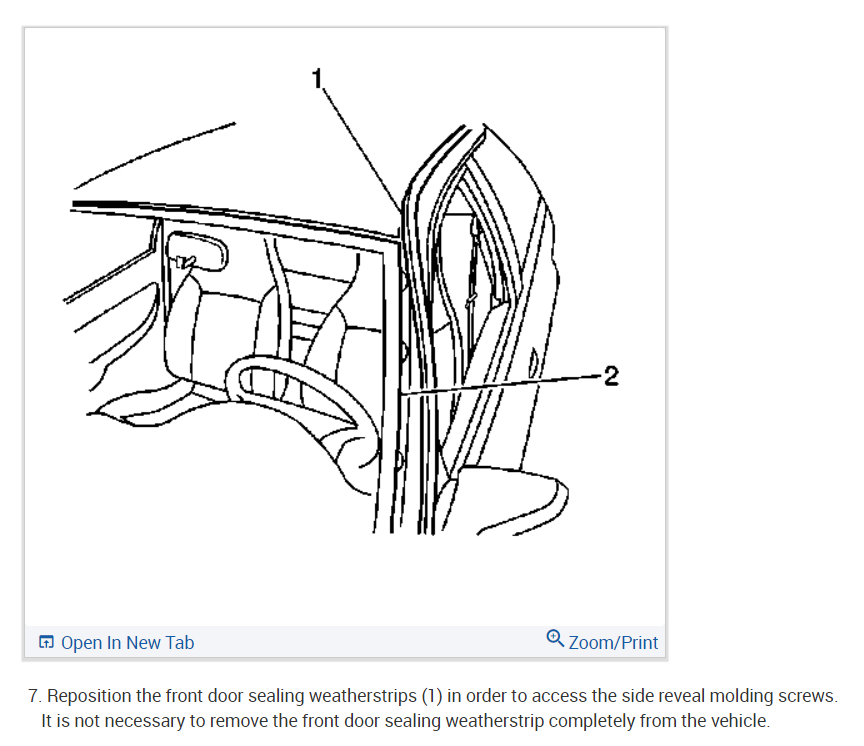

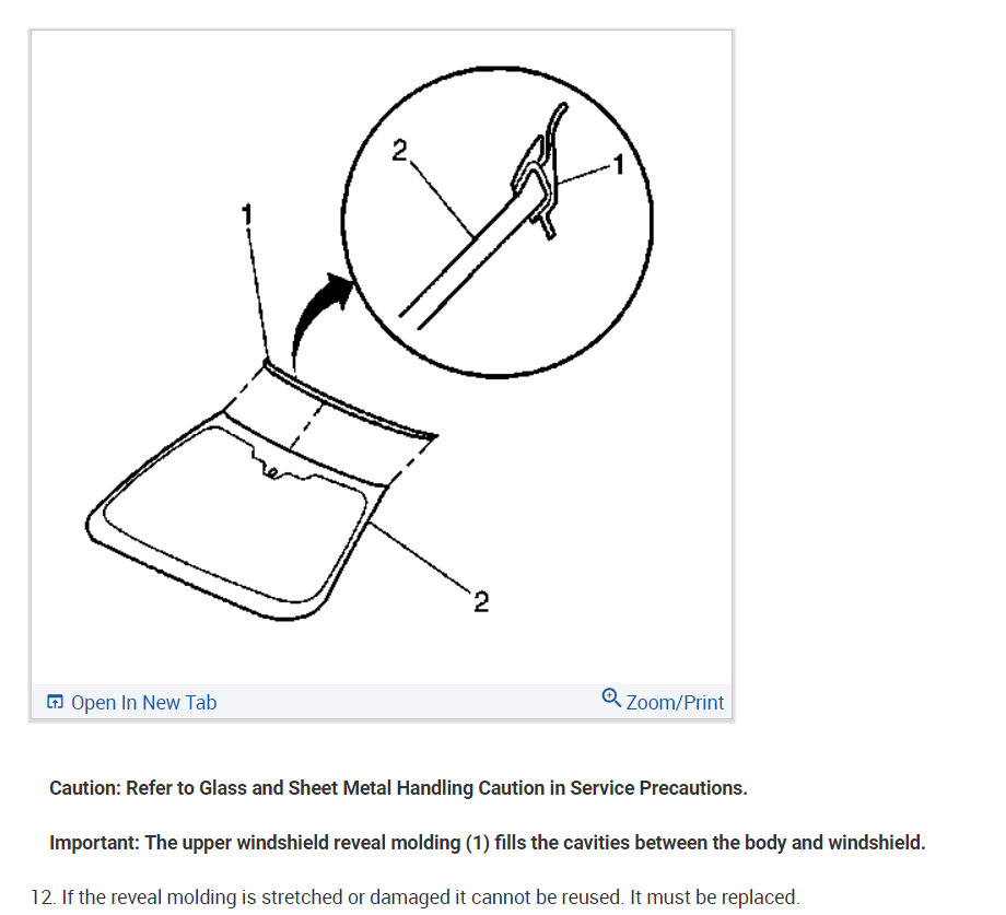

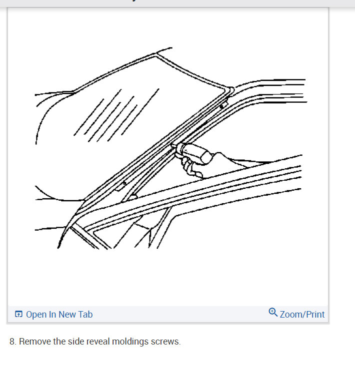

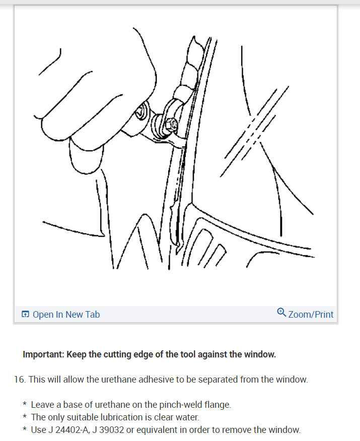

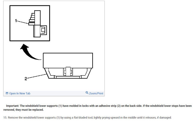

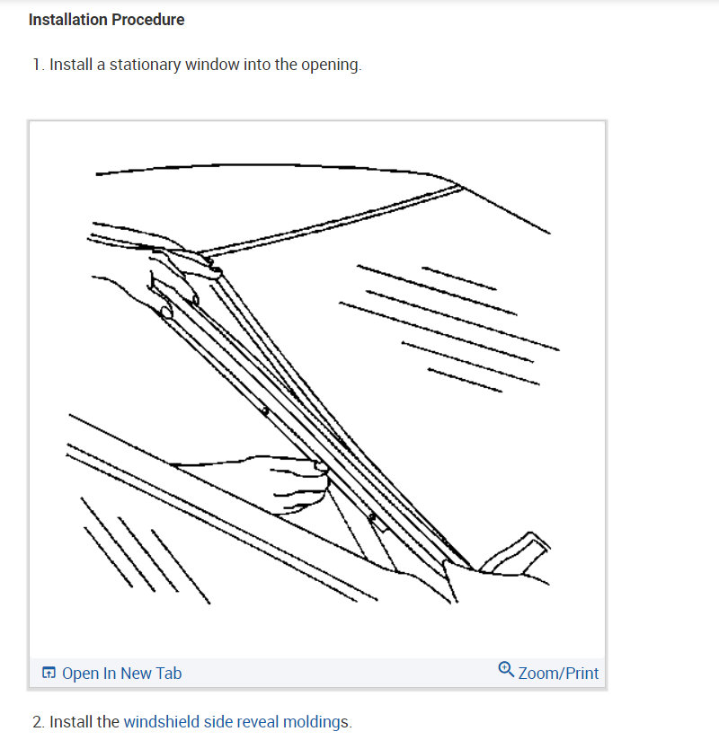

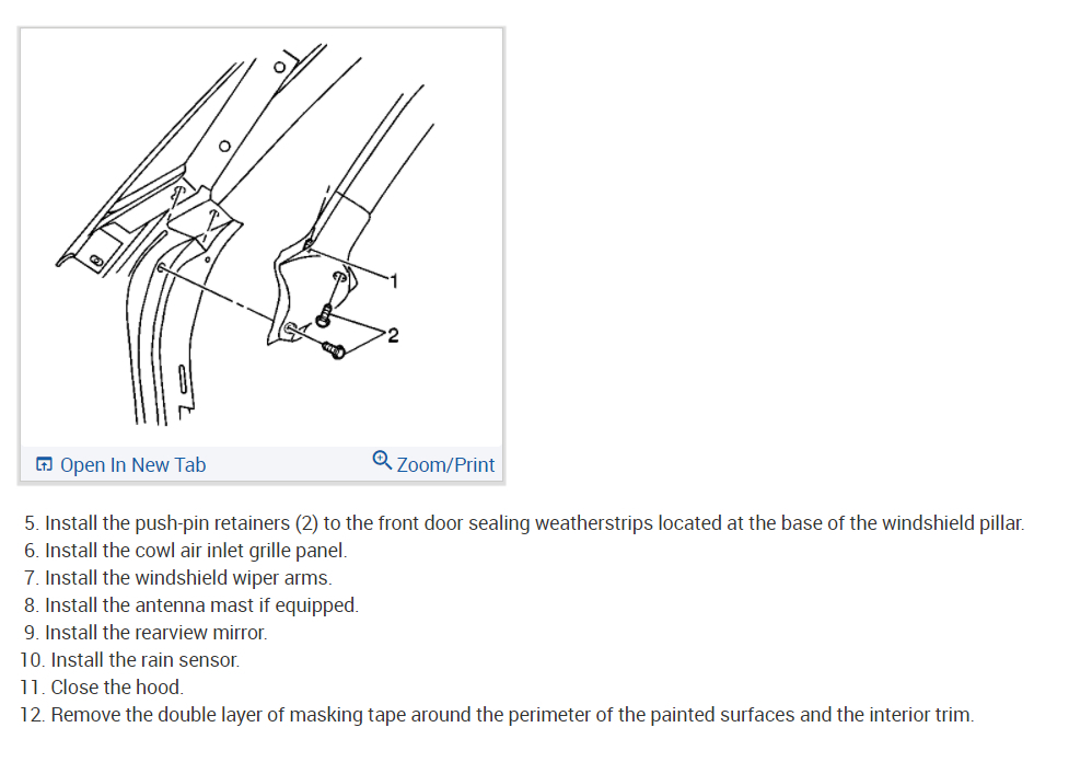

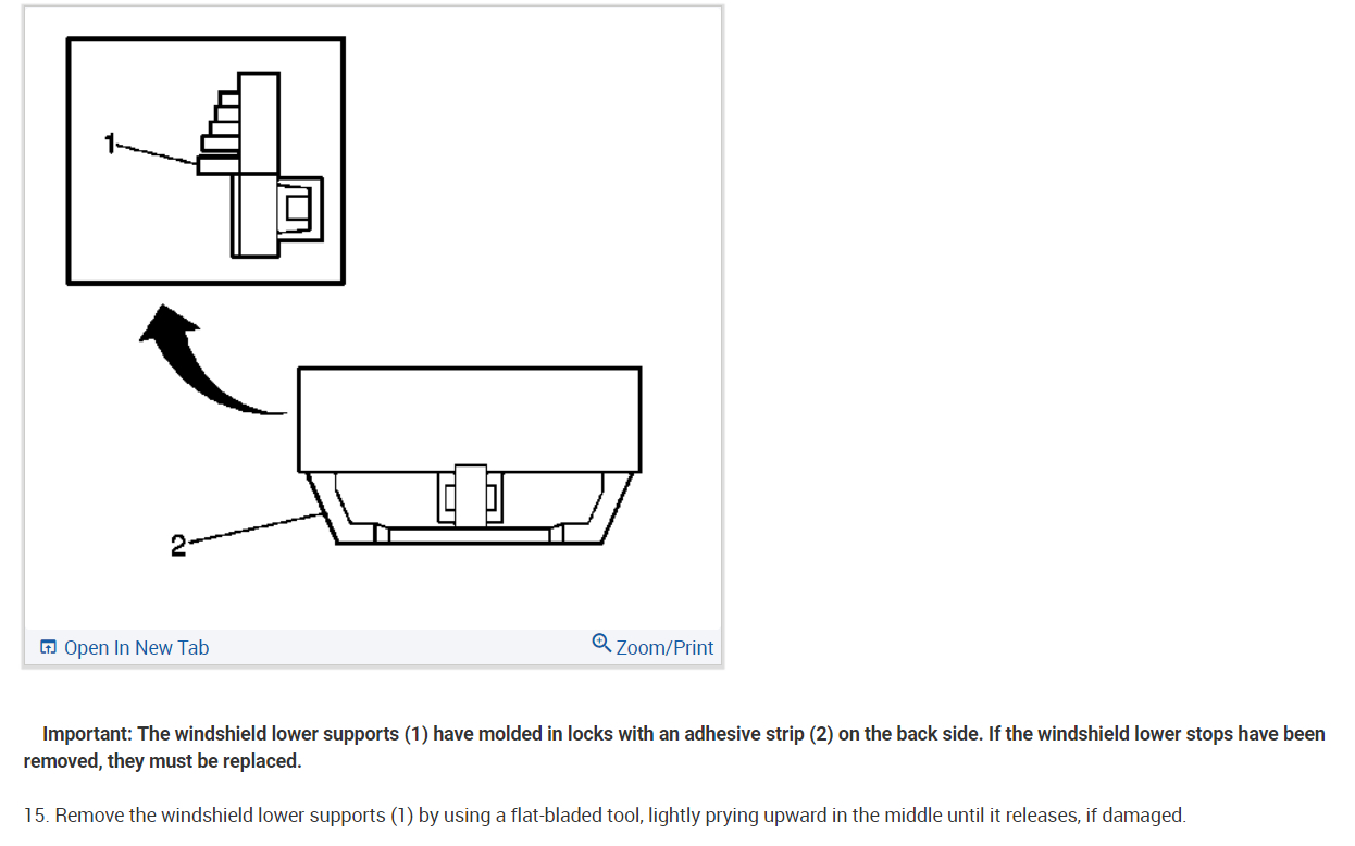

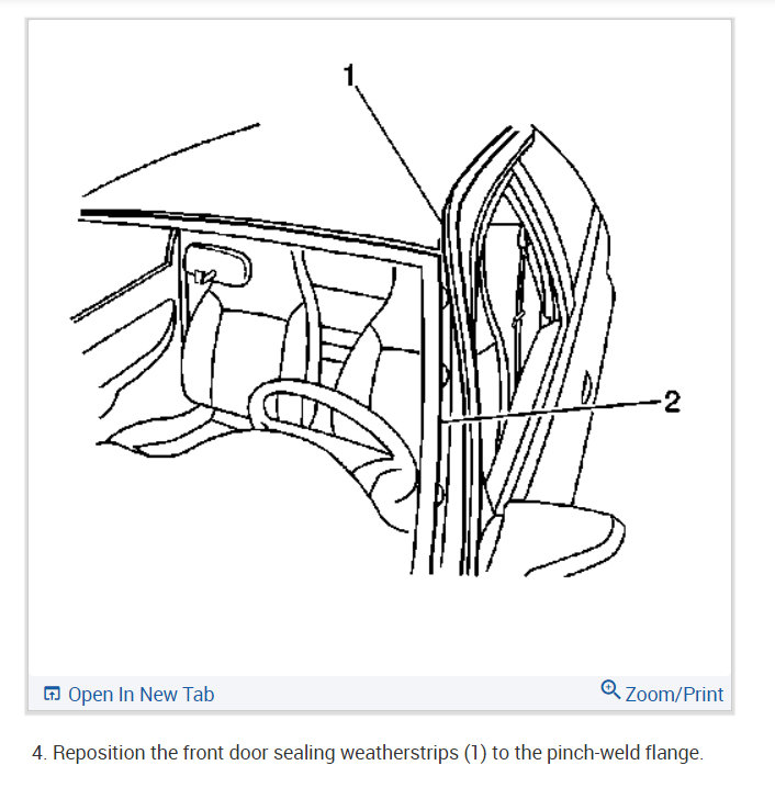

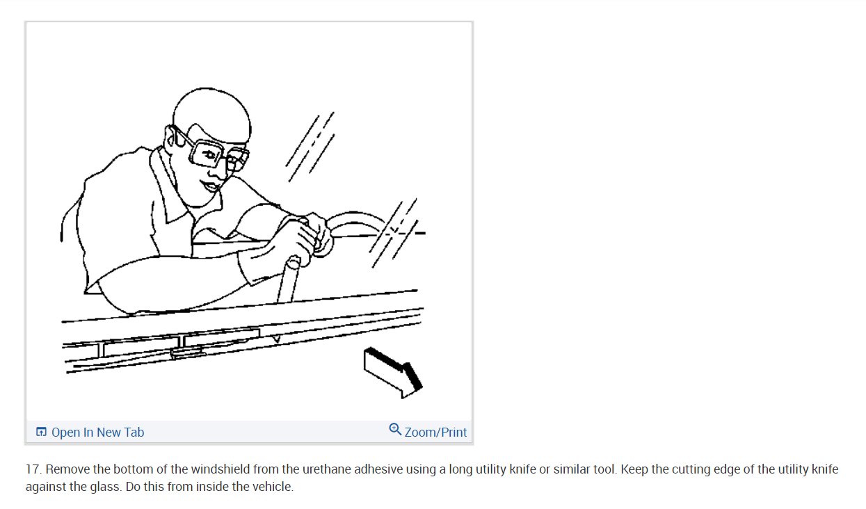

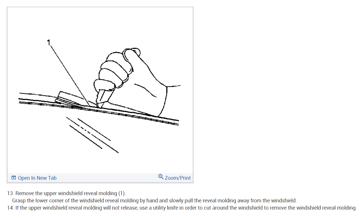

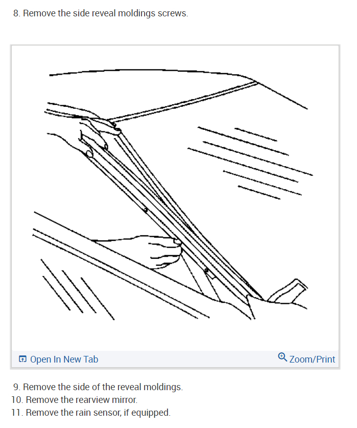

Yep, that is made for max defrost for the HVAC controls it is not aftermarket. There are not wires in the windshield like the rear. Here is how you can replace the windshield in the diagrams below. Check out the diagrams (below). Please let us know if you need anything else to get the problem fixed.

Hello, I'm Danny.

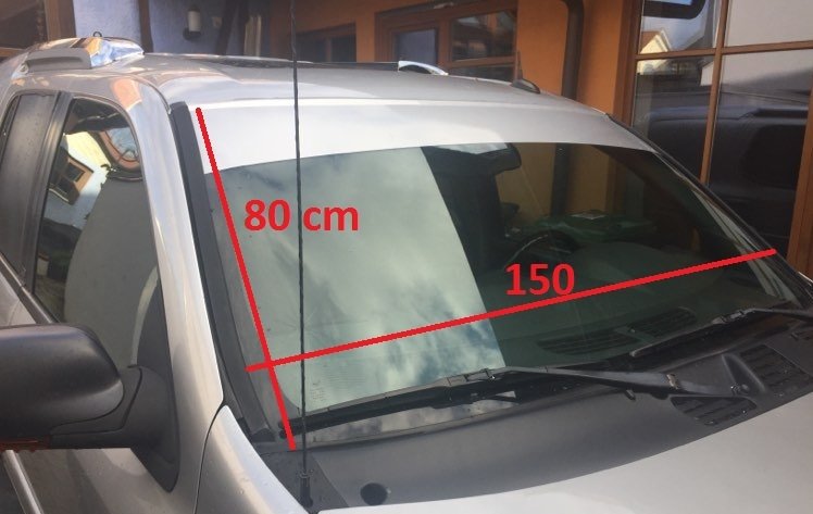

To answer your question, no, you do not have a heated front windshield. Some cars and trucks will come with heated rear windows and side mirrors but not the front. In the picture you provided that is the defrost button which will blow air onto the windshield when it gets fogged over in the cold season. That function is from yours cars heater and A/C controls.The only time you will see wires in a front windshield is if it comes with a built in antenna . Cars that have that feature will not have an antenna mast like yours. I've attached the picture you provided and circled in blue an external antenna mast. Hope this helps and thanks for using 2CarPros.
