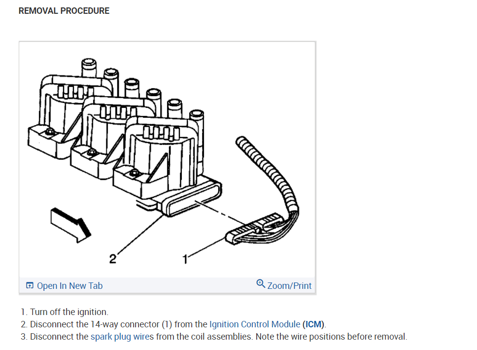

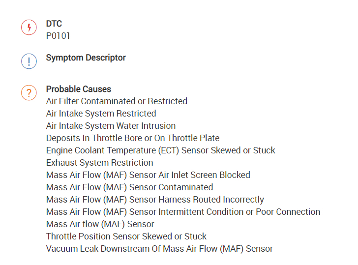

Car runs perfect, but about every 4 or 5 days, will drive down the road and shut off, try to crank it back up and it will runs for about 3 seconds and quit again.

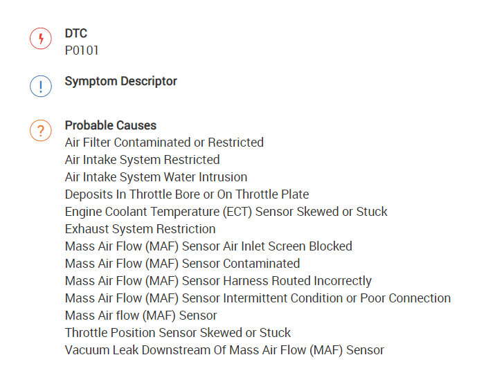

Ran a code scanner on it, said bad MAF. so changed it, cleared codes, ran great for 3 days, then quit going down the road, towed it home, code scanner again, again says MAF (even after new one put in) cleared codes, ran great again for 3 days then same thing, been doing this like this (every 3 days) for a month now, but whenever you clear the code, runs great, no miss, nothing...
have replaced the MAF 3 times now, also put in new ignition switch , fuel filter,
Im at a loss as what is causing as code scanner only ever shows bad MAF sensor (even when it's a new one).
As mentioned, car runs great, no misses or engine lights , for 3 days, then quits while driving, when quits, will crank and run for 3 seconds and shuts off. clear codes runs great again for 3 days...
Any suggestions on where to look next ???

Good afternoon,
First, codes rarely identify bad parts, they just identify failed systems. Diagnostics need to be done to verify the failure.
https://www.2carpros.com/articles/check-engine-light-top-ten-reasons
When it will not start, do you hear the fuel pump run for 2 seconds with the key on?
https://www.2carpros.com/articles/engine-stalls

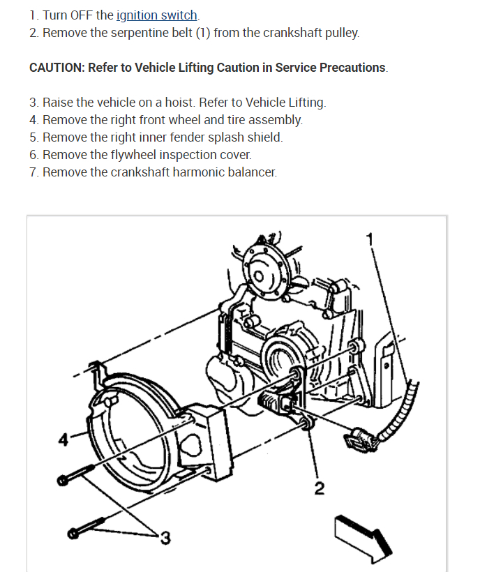

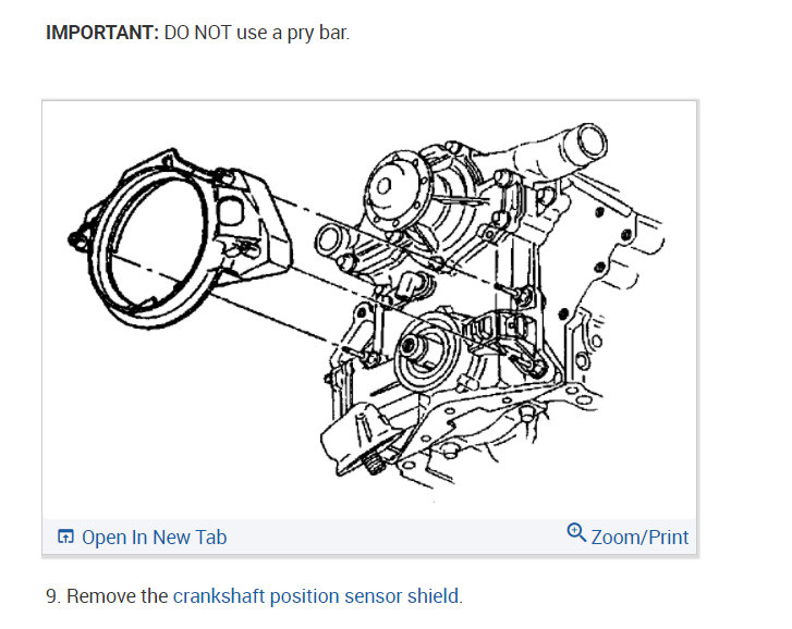

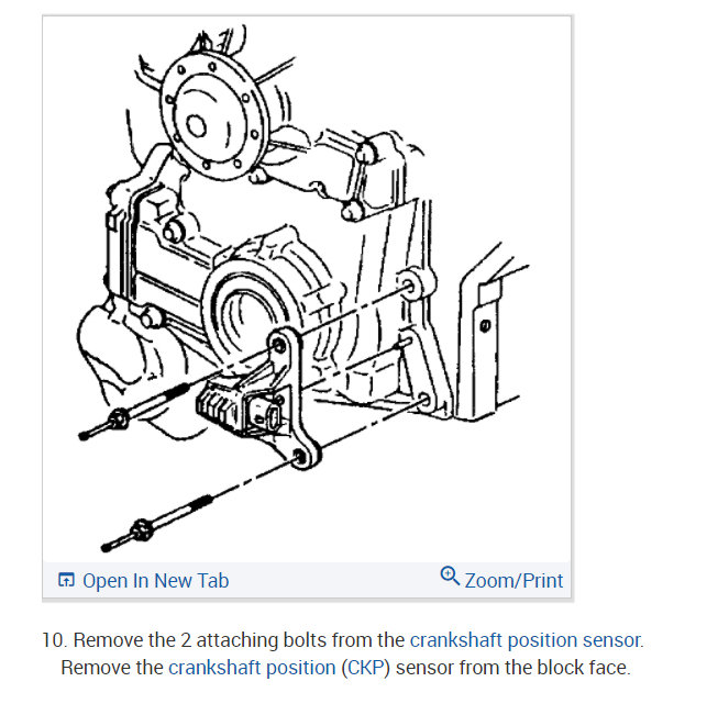

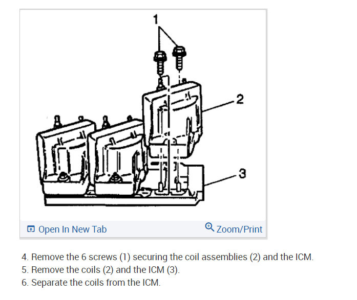

Can you check and see if it has a spark when it does not start? It could be the ignition module or a crank sensor.

No check engine light comes on when it shuts off. when it does shuts off, it will crank and run for 3 seconds then shuts off again. so getting spark, fuel pump runs and tested fuel pressure, it holds good at 51 PSI, other than MAF, it pops no codes (and 3 new MAF sensors have been put on it since this began).
May 27, 2021 at 2:52 PM
It does not have to have a check engine light for the module to be bad. It can still be an issue.
I would remove it and take it to a parts store and have them test it several times. This is a free service.
Did you test the pressure when it stopped running? Testing it when it is running well will not tell you if the pump is locking up.
