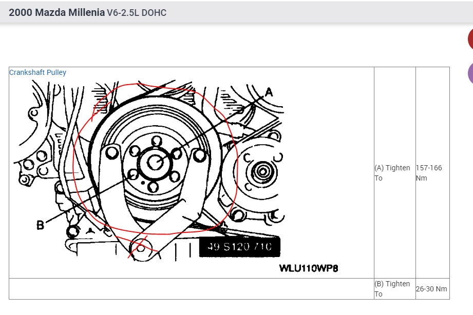

Can you tell approximately where the sound is coming from? The harmonic balancer/crank pulley is at the lowest point of the engine. It is what turns the serpentine belt.
Do me a favor. Open the hood and start the engine. See if you hear the noise coming from the serpentine belt area. I attached a pic of the part below for you. The pic has a tool attached. Something may be touching it or another component as it turns.
Also, if it is loud enough, record it and upload it for me to hear. If you are hearing a squeak as well, it certainly sounds like it could be related to the serpentine belt. If they didn't fully seat the harmonic balancer, the pulley may not be fully aligned with the other pullies.
See pic below.

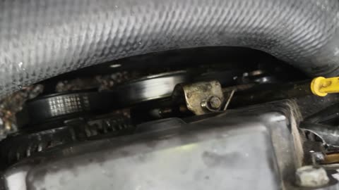

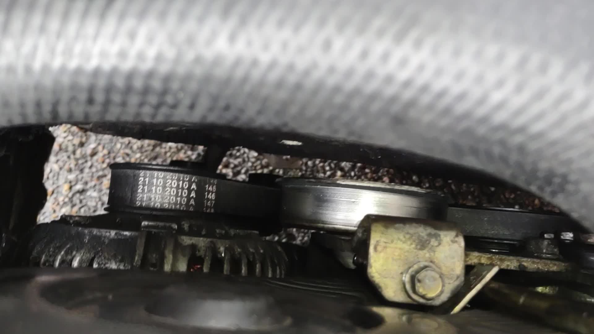

KBEHRENS89
Here's the video but I believe I see the wabble. I'm pretty sure they're not aligned properly. I hope that's what it is anyways.

The belt is making noise for sure. Also, I didn't realize the engine light was flashing. When that happens, it indicates a misfire is occurring.
The crankshaft position sensor is located at the harmonic balancer. That is what I have a feeling is causing the light and noise.
You really should take it back and have them look at it. Let them know about the engine light flashing and that you feel something has happened with the crankshaft position sensor.
