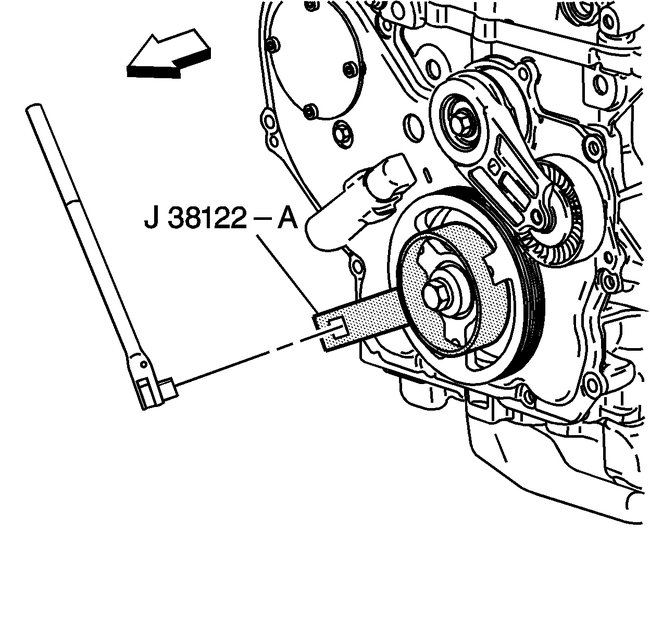

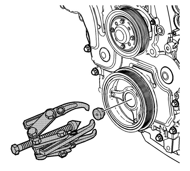

Harmonic balancer is hoping up and down and can here it rattle somewhat outside of car and vibrates bad at idling .do I need to replace it or is something else wrong? just bought car.

Usually, they will even make a knocking sound. The outside pulley is actually mounted on rubber, so it if is moving around, it needs replaced.
Here are the directions for replacing it. I don't know if you have a 4 or 6 cylinder, so I will add the directions for both. The attached pics correlate with the directions and you will need a puller to remove it. Most parts stores will lend or rent one to you.

* J 38122-A Harmonic Balancer Holder
* J 45059 Angle Meter
Removal Procedure
pic 1
1. Remove the drive belt. Refer to Drive Belt Replacement (LE5) (See: Drive Belt > Removal and Replacement).
2. Use J 38122-A to prevent the crankshaft from rotating while loosening the crankshaft balancer bolt.

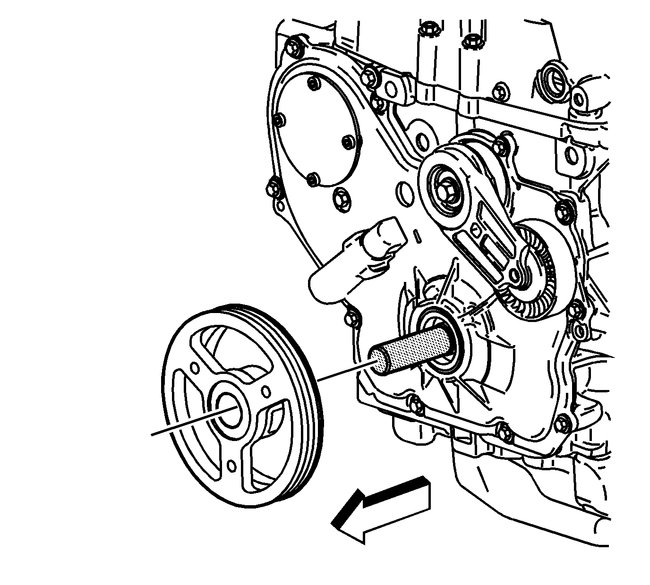

pic 2
4. Remove the crankshaft balancer.

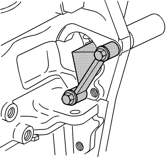

pic 3
1. Position the crankshaft balancer.
2. Install a NEW crankshaft balancer bolt.

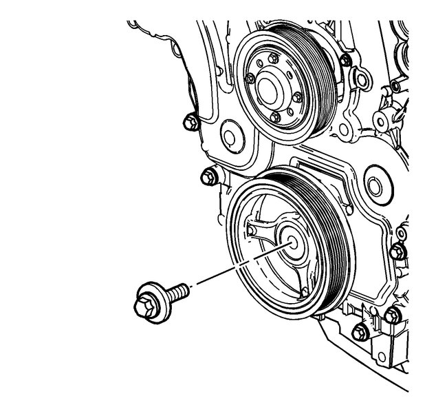

pic 4
3. Use the J 38122-A to hold the crankshaft balancer in order to prevent the balancer from rotating while tightening the bolt.
Caution: Refer to Fastener Caution (See: Vehicle > Vehicle Damage Warnings > Fastener Caution).
4. Tighten the crankshaft balancer bolt to 100 Nm (74 lb ft) plus an additional 125 degrees using the J 45059 .
5. Install the drive belt. Refer to Drive Belt Replacement (LE5) (See: Drive Belt > Removal and Replacement).

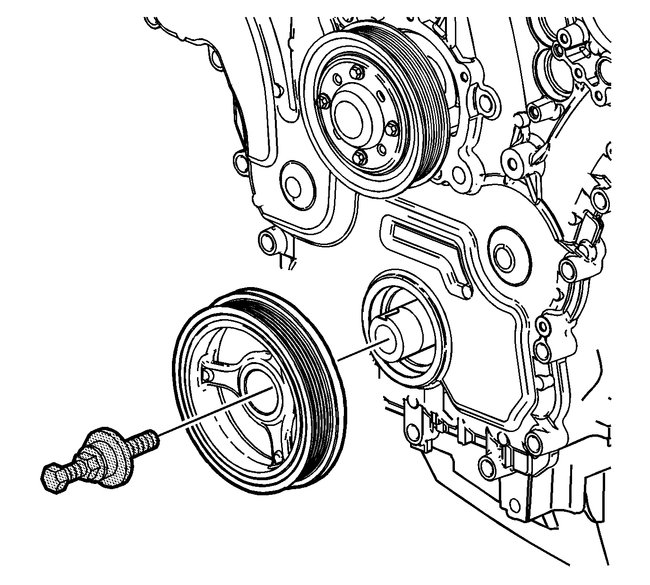

pic 5
5. Install the EN-46106 - tool through the starter mounting hole.

8. Install the J-38416-2 - button in the nose of the crankshaft.
9. Install the J-41816 - remover in order to remove the crankshaft balancer.
10. Tighten the center bolt of the J-41816 - remover in order to pull the crankshaft balancer off of the crankshaft.

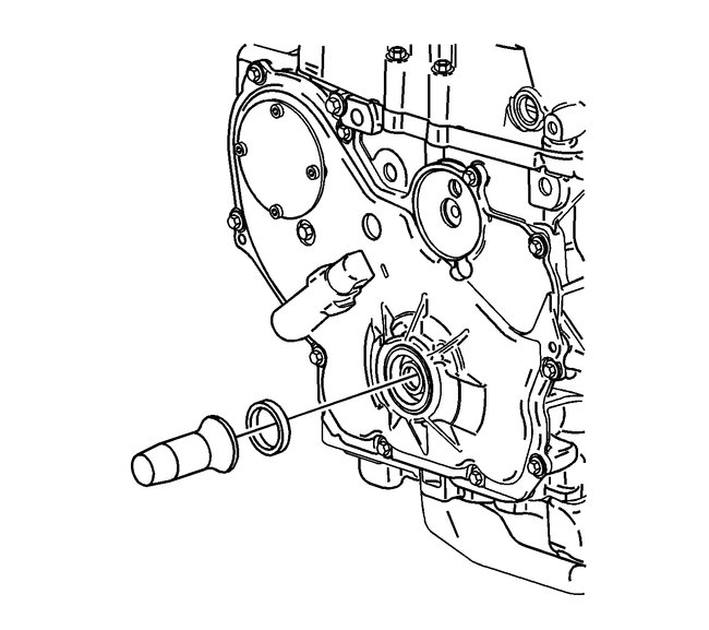

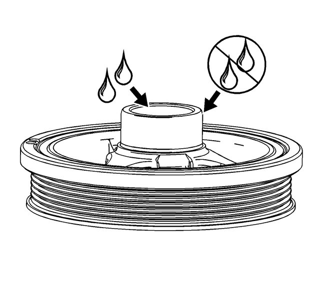

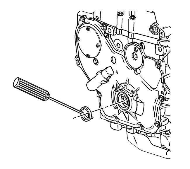

Here are the directions for replacing the seal. If it isn't leaking, you can let it go, but make sure there are no nicks or damage done to it when removing the balancer. If it is leaking, replace it. The directions indicate using a special seal installation tool. Most any nationally recognized parts store will lend or rent that to you. Also, before you install the new balancer, make sure to put some motor oil all around the seal and the portion of the balancer that which goes into the seal to prevent damage to the seal (new or old).

Crankshaft Front Oil Seal Replacement
Tools Required
J 35268-A Camshaft/Front Main Seal Installer
Removal Procedure
pic 1
1. Remove the crankshaft balancer. Refer to Crankshaft Balancer Replacement (LE5) (See: Harmonic Balancer - Crankshaft Pulley > Removal and Replacement).
2. Use a flat-bladed tool to remove the seal from the front cover.
Installation Procedure
pic 2
1. Use the J 35268-A in order to install the crankshaft front oil seal to the engine front cover.
2. Install the crankshaft balancer. Refer to Crankshaft Balancer Replacement (LE5) (See: Harmonic Balancer - Crankshaft Pulley > Removal and Replacement).
And there is a specific way it goes on. There is a key way (shear key) and if I recall, there are flat spots on the oil pump (which it goes through). Use care to properly align the key way and flats on the balancer with the oil pump drive.
If you have questions, concerns, or need help, let me know. Also, let me know how it works out for you. Honestly, take your time and pay attention to how the parts come apart and it will help when you reinstall everything.
