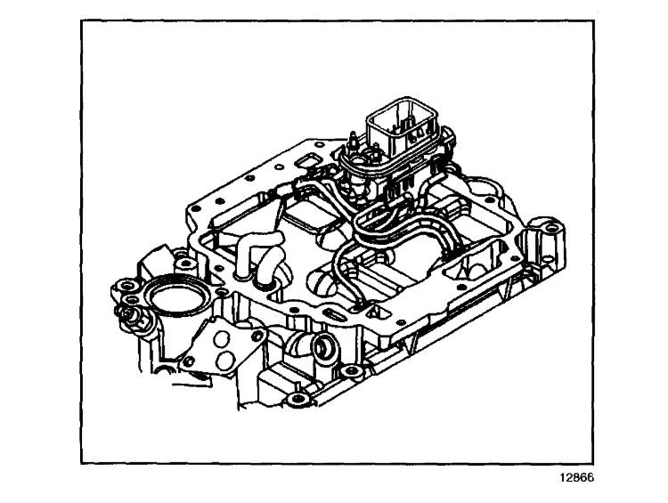

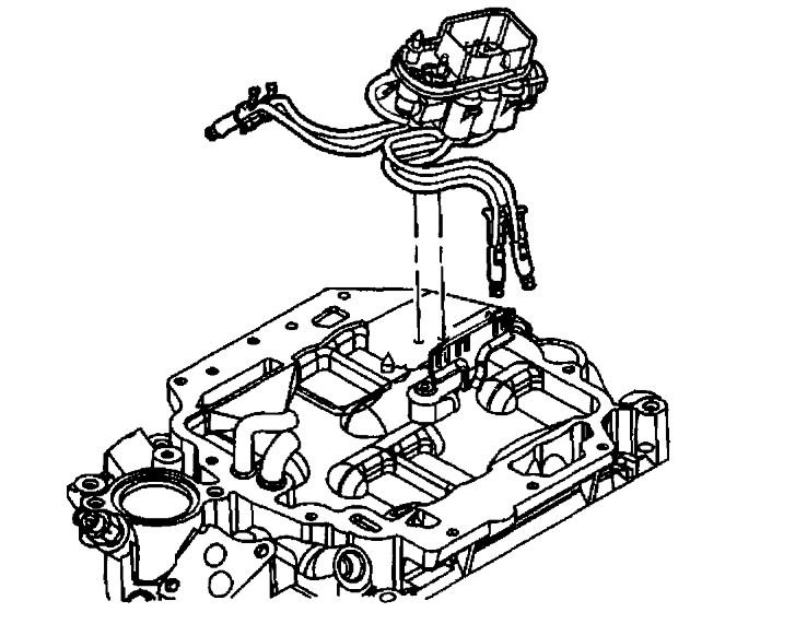

As far as the hard start, there is a spider assembly that contains the injectors and the regulator. The regulator is common for leaking raw fuel into the intake causing a flooding condition.
I would start with a fuel pressure test to verify fuel pressure especially when it sits overnight.
It sounds like you will possibly need the spider assembly.
1. Disconnect the negative battery cable.
2. Relieve the fuel system pressure. Refer to Fuel Pressure Relief Procedure.
3. Remove the upper intake manifold assembly.
NOTE: Do not use any solvent that contains Methyl Ethyl Ketone (MEK). This solvent may damage fuel system components.
4. Before removal, clean the fuel meter body assembly with a spray type engine cleaner, GM X-30A or the equivalent, if necessary. Follow the package instructions. Do not soak fuel meter body assemblies in liquid cleaning solvent.
NOTE: Cover the injector sockets in order to prevent dirt and other contaminants from entering the open fuel passages.
IMPORTANT: When disconnecting the poppet nozzles, remember the sequence in order to ensure correct poppet nozzle placement to each cylinder.
5. Squeeze the poppet nozzle locking tabs together while lifting the nozzle out of the casting socket.
6. Remove the fuel meter body from the bracket by releasing the lock tabs on the bracket.

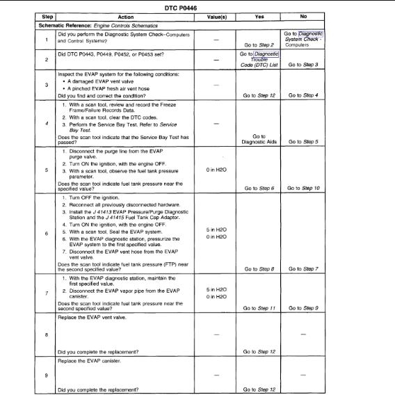

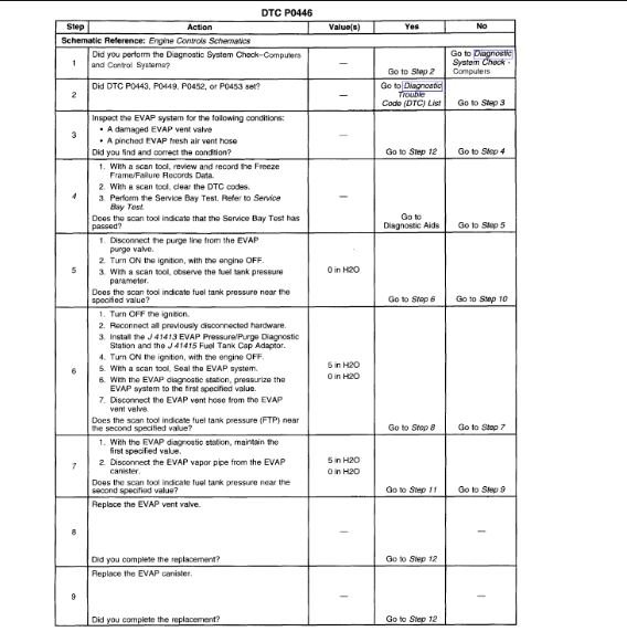

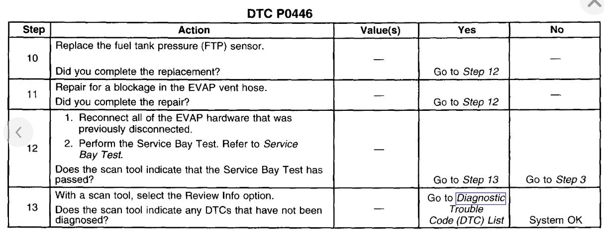

Okay, clearing a code does nothing. It needs to be diagnosed and repaired. Besides, it has no effect on your current issue.
Again, what parts have been changed?
CIRCUIT DESCRIPTION
The Power-train Control Module (PCM) monitors the performance of the Evaporative Emission (EVAP) system by applying a predetermined level of vacuum to the EVAP system then monitors the vacuum decay rate. The PCM sets this Diagnostic Trouble Code (DTC) if the vacuum decay rate is more than a predetermined value.

Perform a physical inspection of the EVAP system. Inspect for the following conditions:
^ A loose, missing, defective, or incorrect fuel tank cap
^ Incorrectly routed or defective EVAP system vacuum and vapor lines
^ A malfunctioning or damaged vapor canister
^ Charcoal release from the vapor canister-Refer to Evaporative Emission (EVAP) System Cleaning. See: Evaporative Emissions System > Procedures > Evaporative Emission (EVAP) System Cleaning
The vacuum and pressure in the EVAP system is measured in inches of water (H2O). Most gauges measure vacuum in inches of mercury (Hg) and pressure in pounds per square inch (psi). The table shows how the values compare.

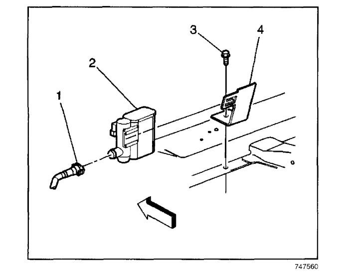

I would check the vent valve for the fuel tank. It may be stuck open causing this code.
You need a scan tool to work the valve and see if it opens and closes on command.
. Turn OFF the ignition.
2. Raise the vehicle.
3. Remove the spare tire (underbody mounted spare tire only).
4. Disconnect the EVAP canister vent valve harness connector.
5. Disconnect the vent hose (1) from the EVAP canister vent valve (2).
6. Release the tang on the vent bracket (4).
7. Remove the vent valve (2) from the bracket (4).
Oct 22, 2018 at 8:11 AM
