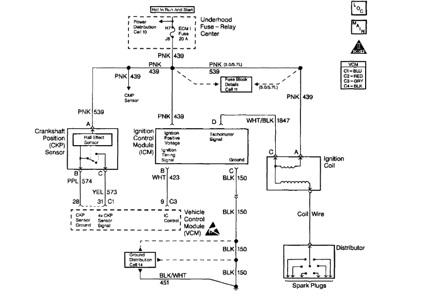

Worm or cold engine will eventually start .Oil pressure gauge reads 0 .After several attempts the oil pressure starts to climb and it then will start to run. The next attempt it will start. I get a P1351 code and replaced the ignition control sensor,fuel pump and relay oil/fuel sender and distributor Any advise will be welcomed.
The van also has a miss fire condition at about 45MPH and very poor gas millage (8 MPG). Fuel trim is at 25 percent.

I would check the oil pressure with a manual gauge to be sure there is oil pressure. If the pressure is not there, you have a issue with possibly the oil pump, pick up screen or main and rod bearing damage.
That needs to be checked right away. Otherwise it may be just the sensor that is the issue for the incorrect reading.

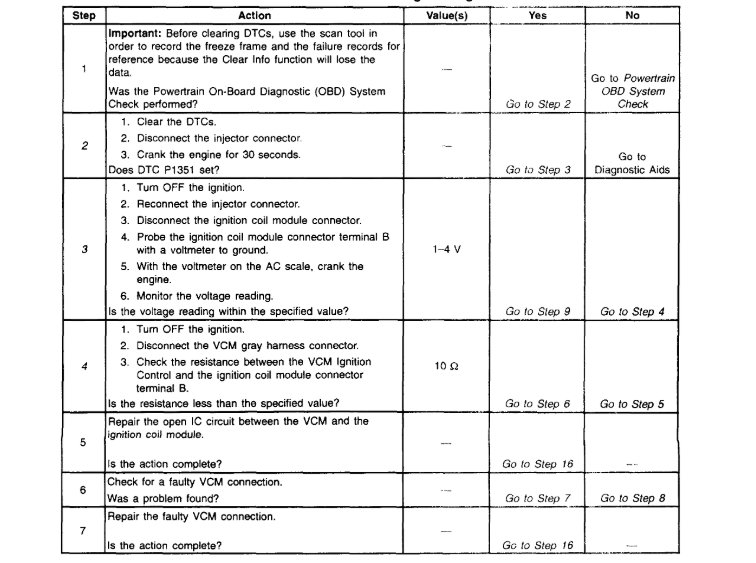

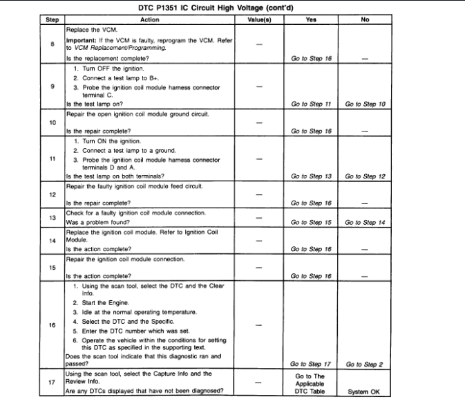

I posted the flow chart and wiring diagram below for the code for you.
CIRCUIT DESCRIPTION
The enhanced ignition system provides the timing input to the VCM with a crank sensor. The VCM uses this reference pulse in order to determine the individual ignition spark timing for each cylinder.
Once the VCM calculates the ignition timing, the ignition coil module on the IC circuit receives the timing signal. Each timing pulse received by the ignition coil module, on the IC circuit, triggers the coil module in order to operate the ignition coil. The secondary ignition voltage is induced, and then the secondary ignition voltage is sent to the distributor for distribution to each spark plug. This DTC is a type A DTC.
The IC signal voltage ranges from about 0.5 volt to 4.5 volts.

TEST DESCRIPTION
The numbers below refer to the step numbers in the diagnostic table.
2. This determines if the DTC is an intermittent.
3. This check determines if the IC signal from the VCM is available at the ignition coil driver.
4. The remaining tests begin to check that the coil driver circuitry is OK.
