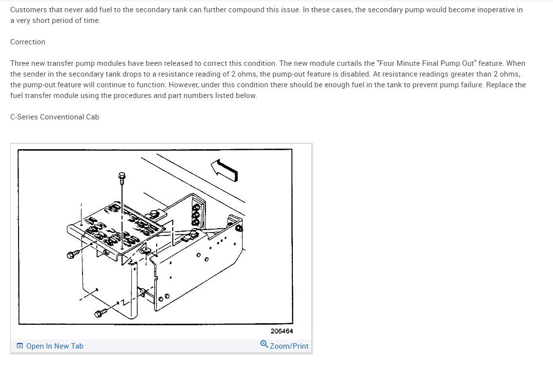

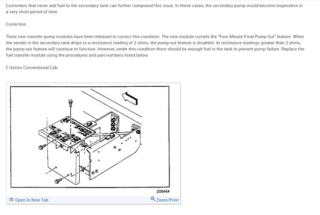

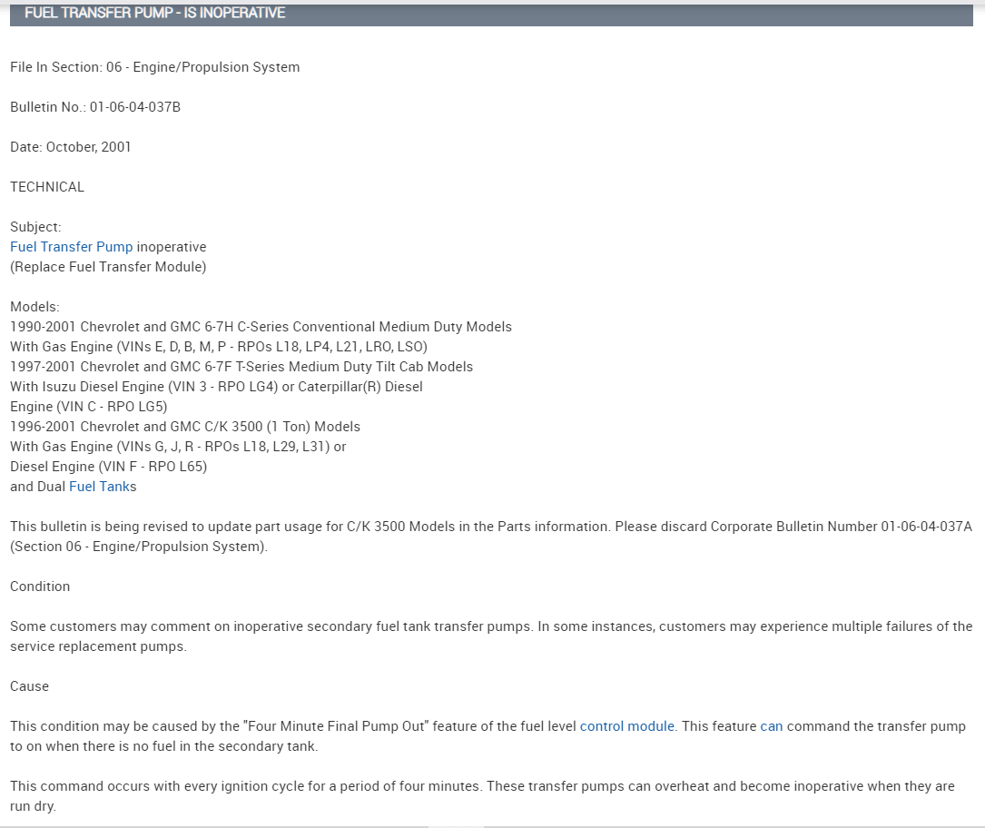

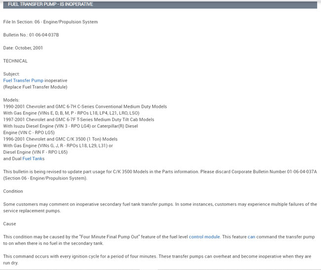

Hello, it sounds like you have a good idea of what you are doing. Do you have a scan tool that can monitor live data PIDs? Also, this truck has 2 fuel pumps, the one in the fuel tank and then there's a balance fuel pump on the inside of the left frame rail. Fuel pressure spec is 56-62, you might be having a fuel volume issue. Have you done a fuel filter in the last 20k miles or so? With this size engine and at a cold start, one concern might be fuel volume, I know your pressure is staying okay.

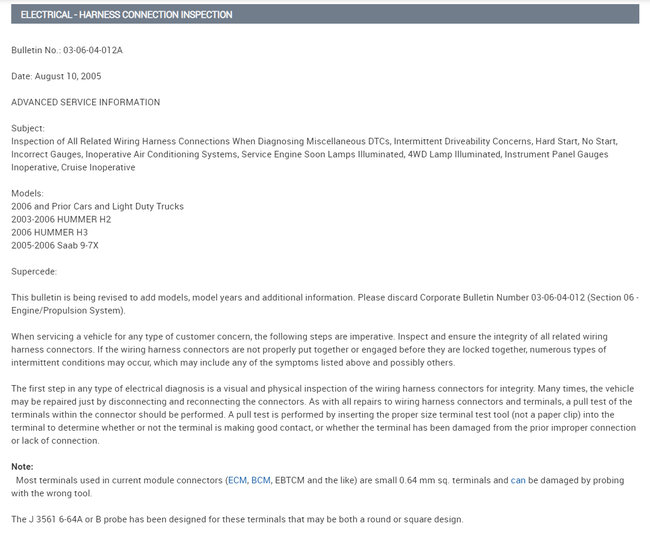

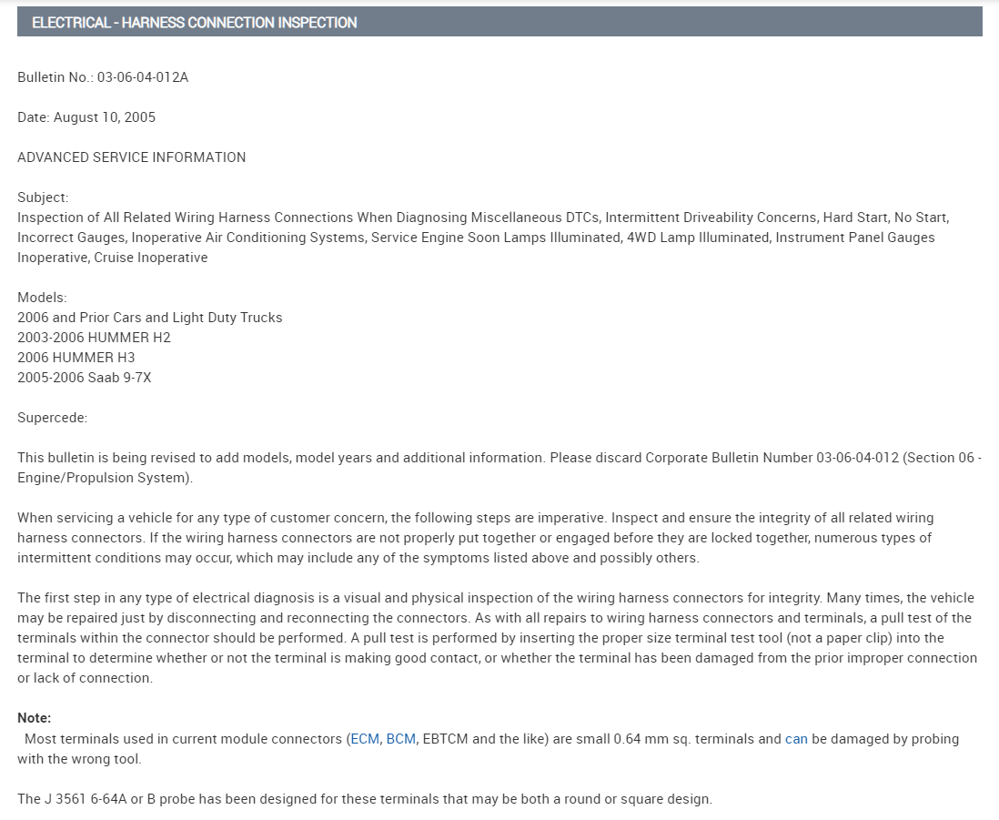

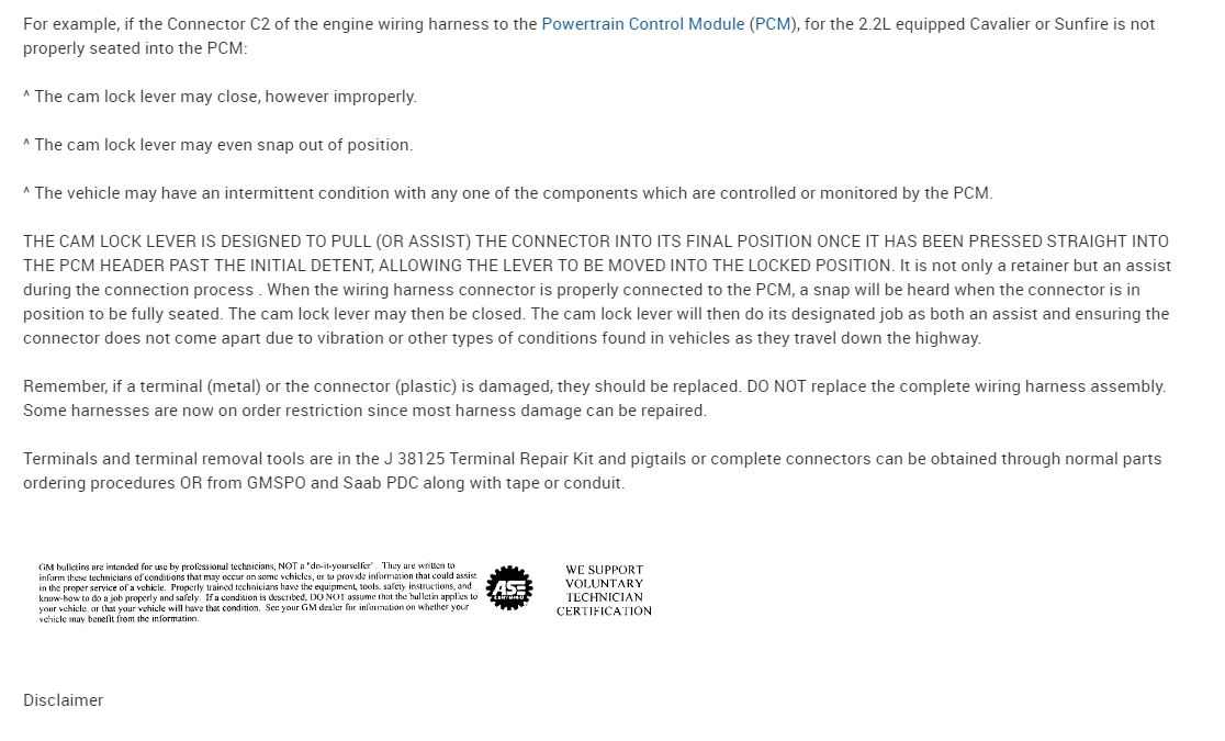

Here's a couple TSBs I came across as well:
https://www.2carpros.com/articles/engine-cranks-excessively-before-starting
