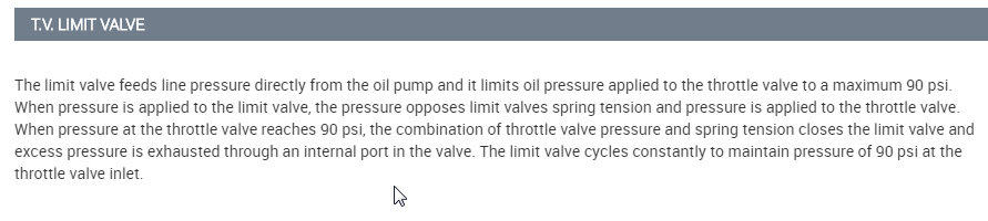

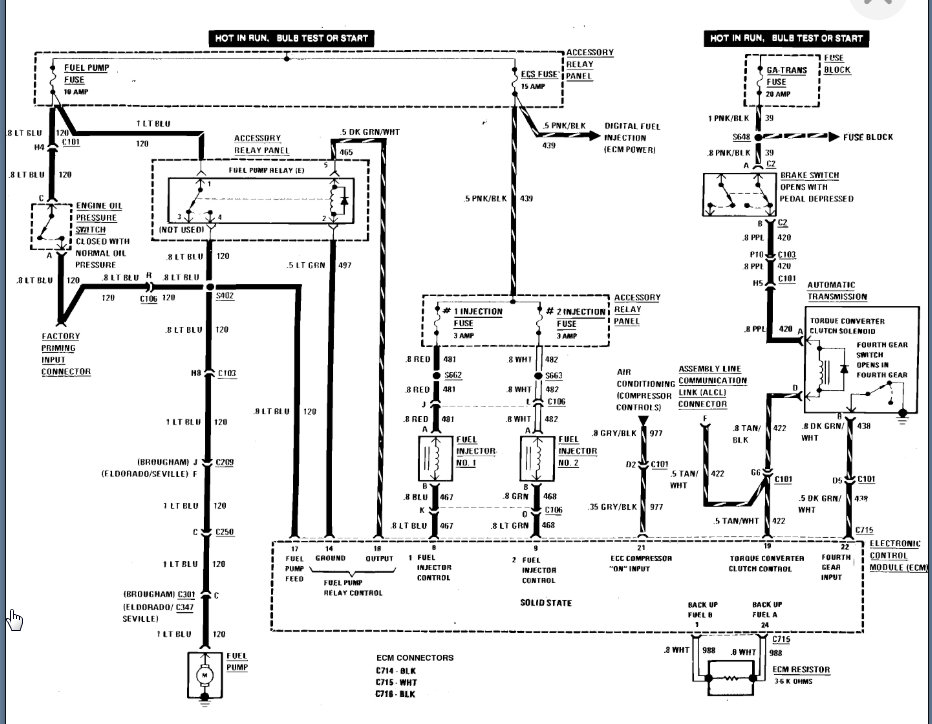

Okay, I was in the process of running test and I took off the sensor on top of transmission pan and cleaned it good and let it dry then plugged it back in. I then drove it and it would shift but it was shifting way too late; it's almost like making it shift when it does it shifts hard! But the other gears shift easy expect overdrive. I haven't gotten a chance to go that fast for long enough now my ECC is completely out and the mileage info. any ideas on where to start? I checked the fuses are all good. thanks so much.
Jul 13, 2020 at 8:28 AM
Was this doing the same thing before you cleaned the sensor or did the issue change when you cleaned it?
Just based on this info I would think the throttle valve is the issue causing a potential pressure issue. Depending on what we find with the line pressure and if this issue was changed, we can go in different directions.
I attached some info for your review and let me know about this info and we can go from there.
Jul 13, 2020 at 12:26 PM

Before I cleaned the sensor and changed the transmission filter it wouldn't shift at all. now it's hard shifting out of first and and I have no power to the ECC display no of it works at all checked fuses wiring nothing jumped out expect may a small bulb and I replaced it and still no power. I understand what you were saying in the first pic the diagram. however was hard for me to get. thanks do much.
Jul 14, 2020 at 3:40 AM
With that info, what was the condition of the fluid when you changed the filter? I suspect you are going to need an overhaul of the transmission due to it not shifting and now it is better. However, hard shifting indicates internal clutch/fluid issues, or control issues.
This is why we need to know the condition of the fluid. Was it dark and smell burnt?
Jul 14, 2020 at 12:36 PM
