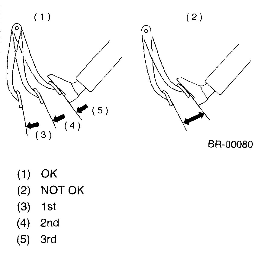

Start the engine, and run it for 1 to 2 minutes, then turn it off. Depress the brake pedal several times applying the same pedal force as that used in ordinary braking operations. The pedal stroke should be greatest on the 1st depression, and it should become smaller with each successive depression. If no change occurs in the pedal height while in a depressed state, the brake booster is faulty.

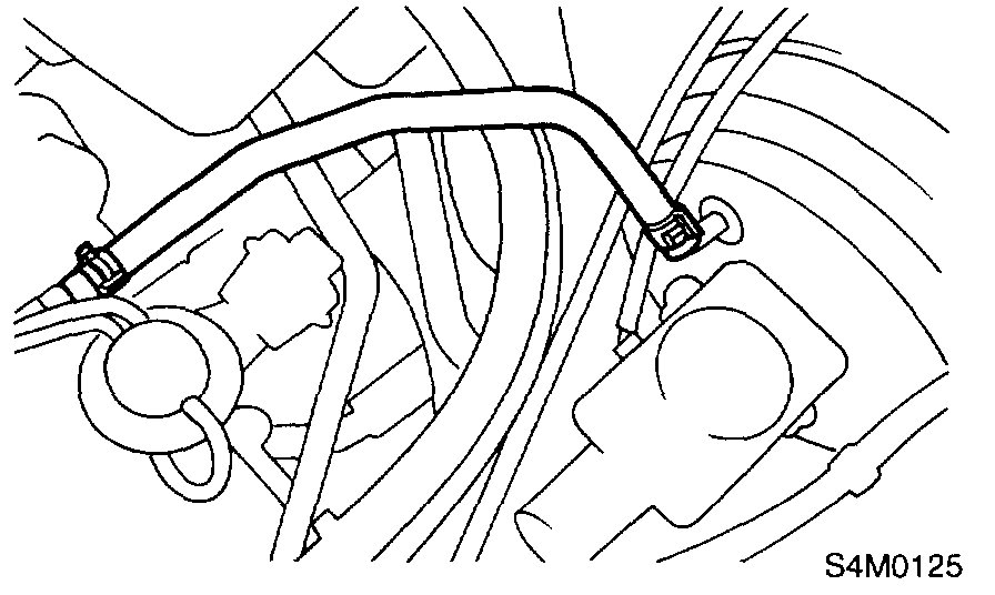

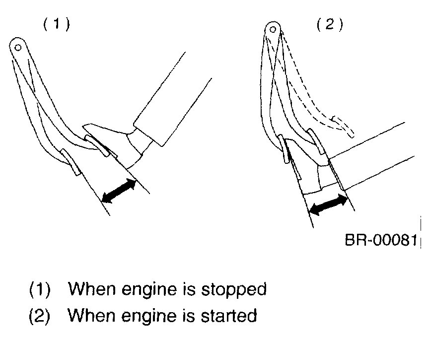

^ Operation check
pic 2
1) With the engine off, depress the brake pedal several times applying the same pedal force and make sure that the pedal height does not vary with each depression of the pedal.
2) With the brake pedal depressed, start the engine.
3) As engine starts, the brake pedal should move slightly toward the floor. If no change occurs in the pedal height, the brake booster is faulty.
NOTE: If faulty, check precisely with gauges.

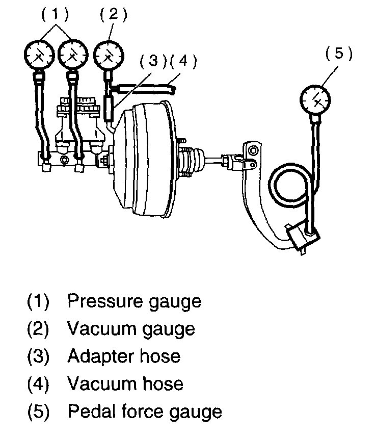

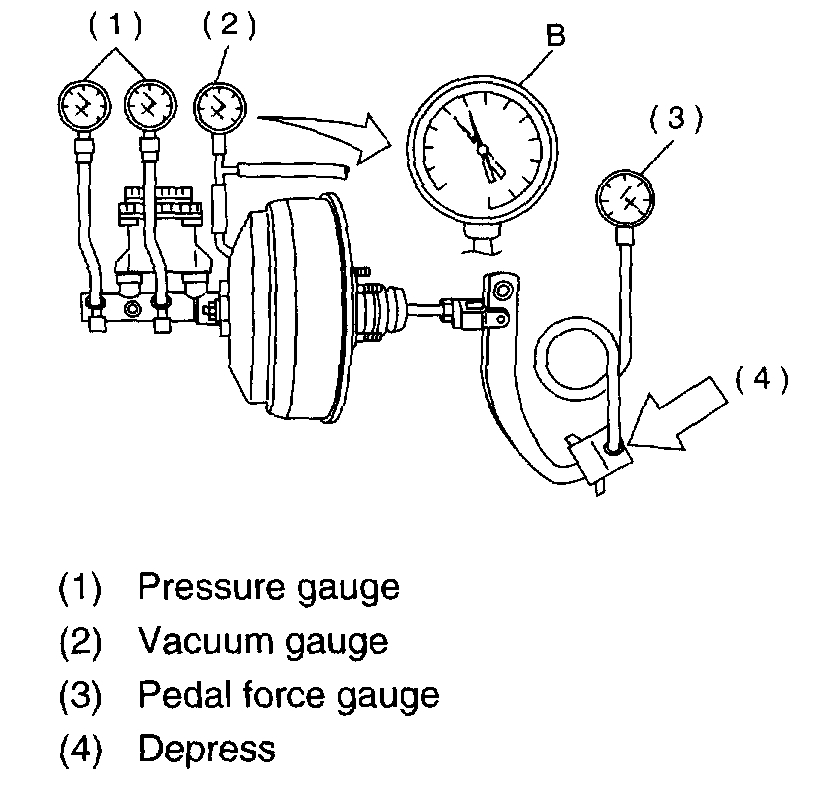

OPERATION CHECK (WITH GAUGES)
CAUTION: When checking operation, be sure to securely apply the hand brake.

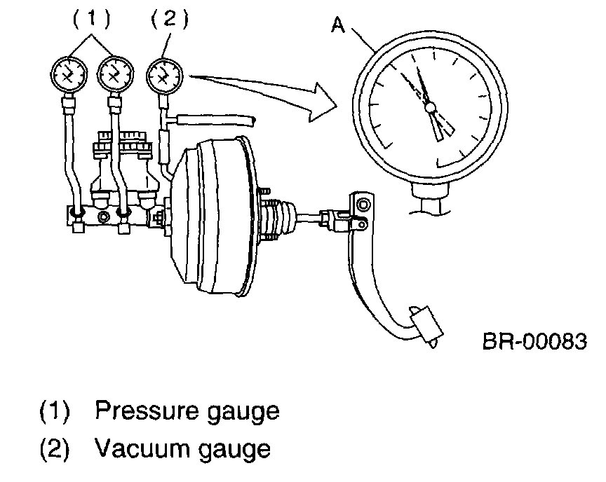

^ Checking with gauges

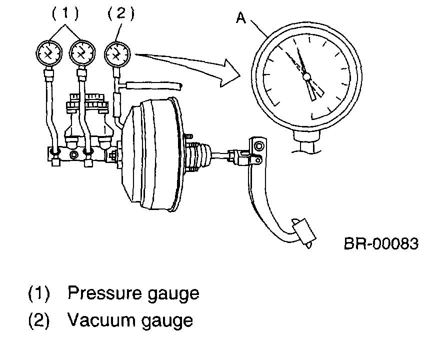

pic 3
Connect gauges as shown in the figure. After bleeding air from pressure gauges, proceed to each check.
^ Air tightness check
pic 4
1) Start the engine and keep it running until a vacuum of 66.7 kPa (500 mmHg, 19.69 inHg) = point A is indicated on vacuum gauge Do not depress the brake pedal.
2) Stop the engine and watch the gauge. If the vacuum drop range is less than 3.3 kPa (25 mmHg, 0.98 inHg) within 15 seconds after stopping the engine, the brake booster is functioning properly.

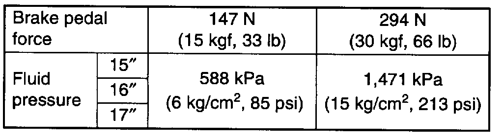

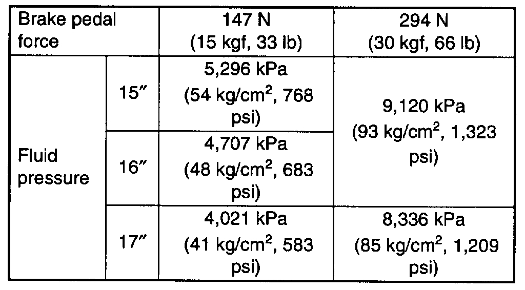

^ Lack of boosting action check
Turn off the engine, and set the vacuum gauge reading at "0". Then, check the fluid pressure when brake pedal is depressed. The pressure must be greater than the standard value listed.
pic 6
^ Boosting action check
pic 7
Set the vacuum gauge reading at 66.7 kPa (500 mmHg, 19.69 inHg) by running engine. Then, check the fluid pressure when brake pedal is depressed. The pressure must be greater than the standard value listed.

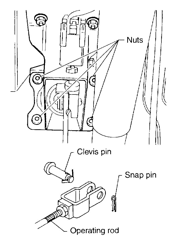

REMOVAL
1) Remove or disconnect the following parts at engine compartment.
1) Disconnect the connector for brake fluid level indicator.
2) Remove the brake pipes from master cylinder.
3) Remove the master cylinder installing nuts.
4) Disconnect the vacuum hose from brake booster.
2) Remove the following parts from the pedal bracket.
1) Snap pin and clevis pin
2) Four brake booster installing nuts
3) Remove the brake booster while shunning brake pipes.

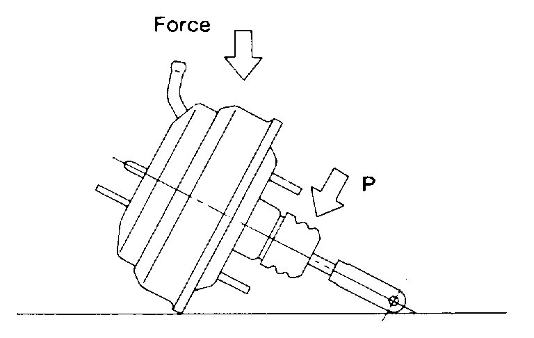

NOTE:
^ Be careful not to drop the brake booster. Brake booster should be discarded if it has been dropped.
^ Use special care when handling the operating rod.
If excessive force is applied to operating rod, sufficient to cause a change in the angle in excess of ±3°, it may result in damage to the power piston cylinder.
^ Use care when placing the brake booster on the floor.

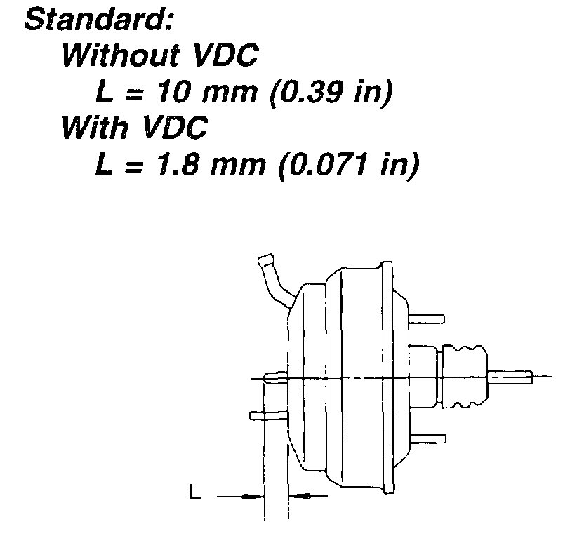

^ Do not change the push rod length. If it has been changed, reset the projected length "L" to the standard length.
pic 8
Standard:
L = 10.05 mm (0.40 inch)
pic 9
CAUTION: If external force is applied from above when brake booster is placed in this position, the resin portion as indicated byes", may be damaged.

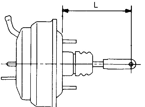

7) Adjust the operating rod of brake booster.
Standard:
L 144.6 mm (5.69 inch)
If it is not within specified value, adjust it by adjusting the brake booster operating rod.

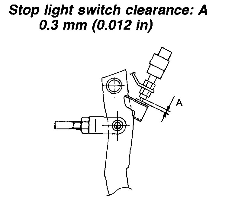

8) Measure the clearance between threaded end of stop light switch and stopper. If it is not within specified value, adjust it by adjusting the position of stop light switch.
CAUTION: Be careful not to rotate the stop light switch.
Stop light switch clearance:
A 0.3 mm (0.012 inch)
