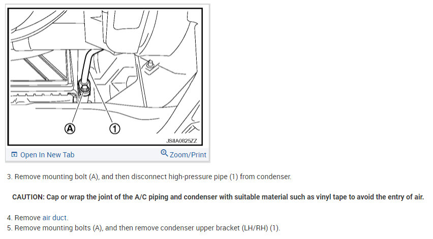

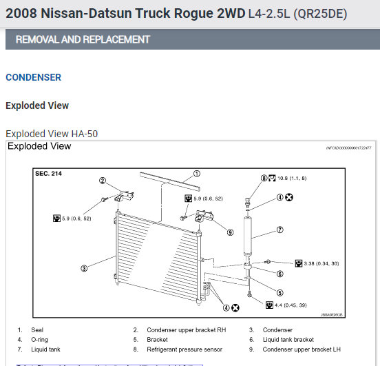

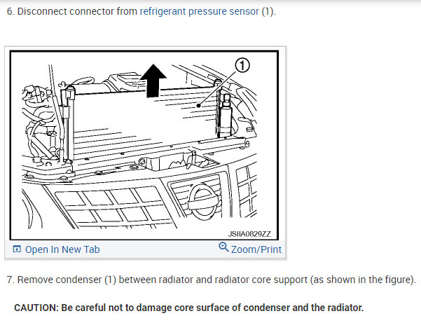

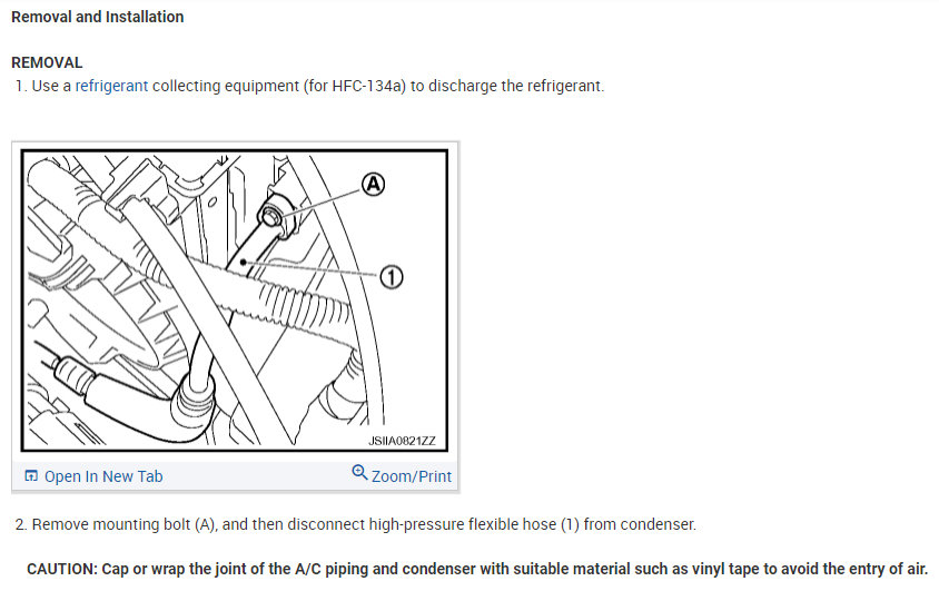

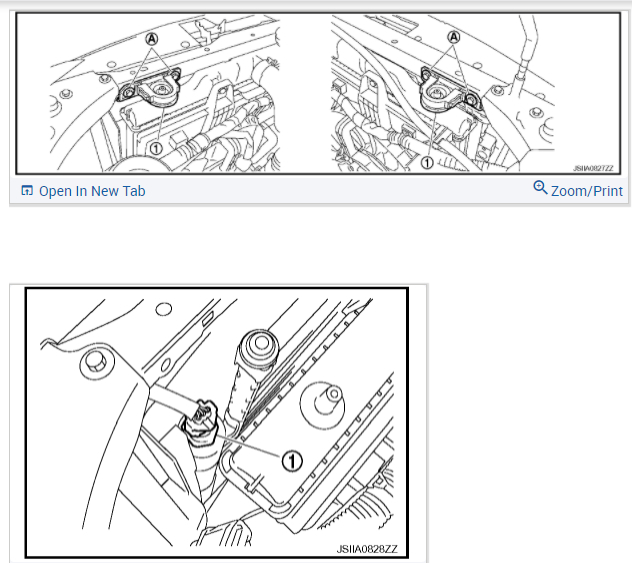

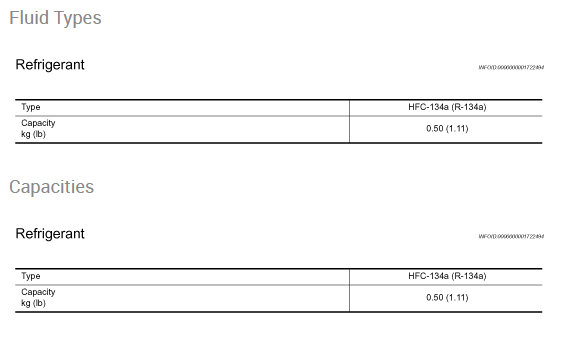

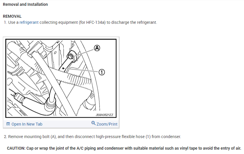

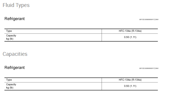

Here is the information you requested. Once you replace the A/C condenser you will need to vacuum and charge the system. Here are the tutorials showing what is involved:
https://www.2carpros.com/articles/air-conditioner-how-to-add-freon
I've attached picture steps below on how to remove and replace the A/C condenser on your vehicle. I've also attached a picture showing the type and capacity of the refrigerant. Hope this helps and thanks for using 2CarPros.
