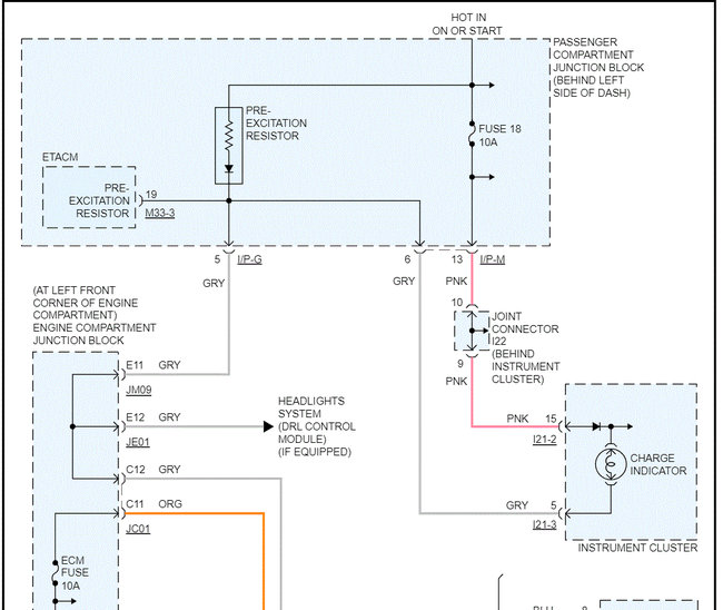

Based on your description, it sounds like the alternator isn't keeping up with the demand. I need you to check something for me. We need to confirm the alternator is performing at a rate that will keep things alive.
It's really simple to test. All you need is a voltmeter or a multimeter. Follow the directions in this link.
Let me know the results. I would like to start with this before we try finding a poor connection (which I don't feel is).

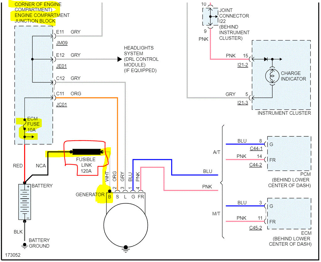

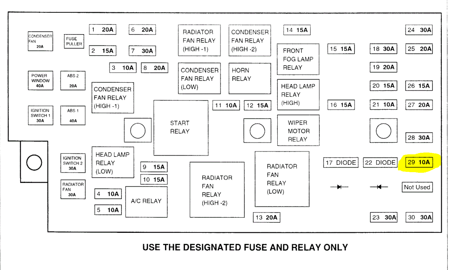

If the alternator fails the test above, I need you to check two more things. First, in the under-hood fuse box, there is a 10-amp ECM fuse. Confirm it is good and has power to and from it.
If that checks good, I need you to locate the white wire on the alternator. That wire which sends a charge to the battery has a fusible link. A fusible link is similar to a fuse but can look like a wire. So, what you will need to do is disconnect the negative battery terminal. Then, check the white wire for continuity to the positive battery terminal. If there is no continuity, it is likely the link has failed.
Here is a link that explains how to test wiring.
Take care and I'll watch for your reply.

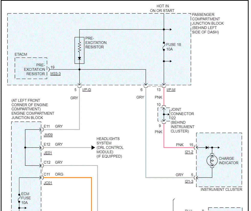

Note: I attached the wiring schematic below of the circuit. I had to cut it in half to make it readable for you. I thought this may be helpful for you. Also, the last pic shows the fuse I'm referring to in the fuse box. It's fuse 26

When you disconnected the battery and the fusible link, there wouldn't have been any power. If you did get power when you reconnected it, the fusible link is good.
The fusible link is the 120-amp fuse, so it appears good.
When you checked alternator output at the battery, you indicated there was no change in voltage between the engine being off and running. If everything electrical is good, the alternator isn't producing. You may have gotten a bad one.
One last thing. I need you to connect your voltmeter to the S terminal (orange wire) at the alternator (with the battery connected). Place the red connector to terminal S and the black wire on the meter to the battery ground. Note, you can disconnect the connector at the alternator to do this. Also, one more time, confirm there is power (battery connected) to the B terminal (white wire) at the alternator using the same technique.
If they both have power, replace the alternator.
