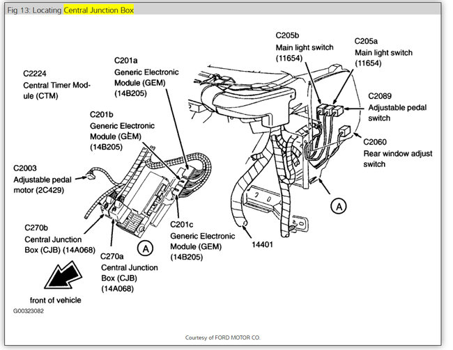

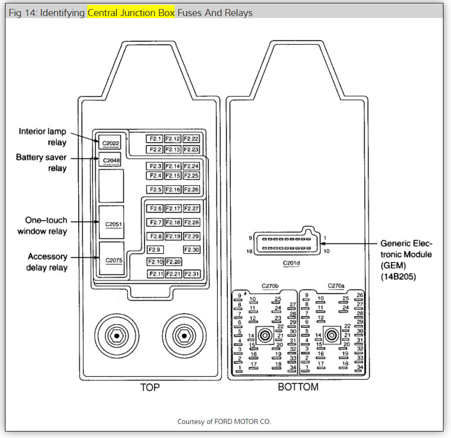

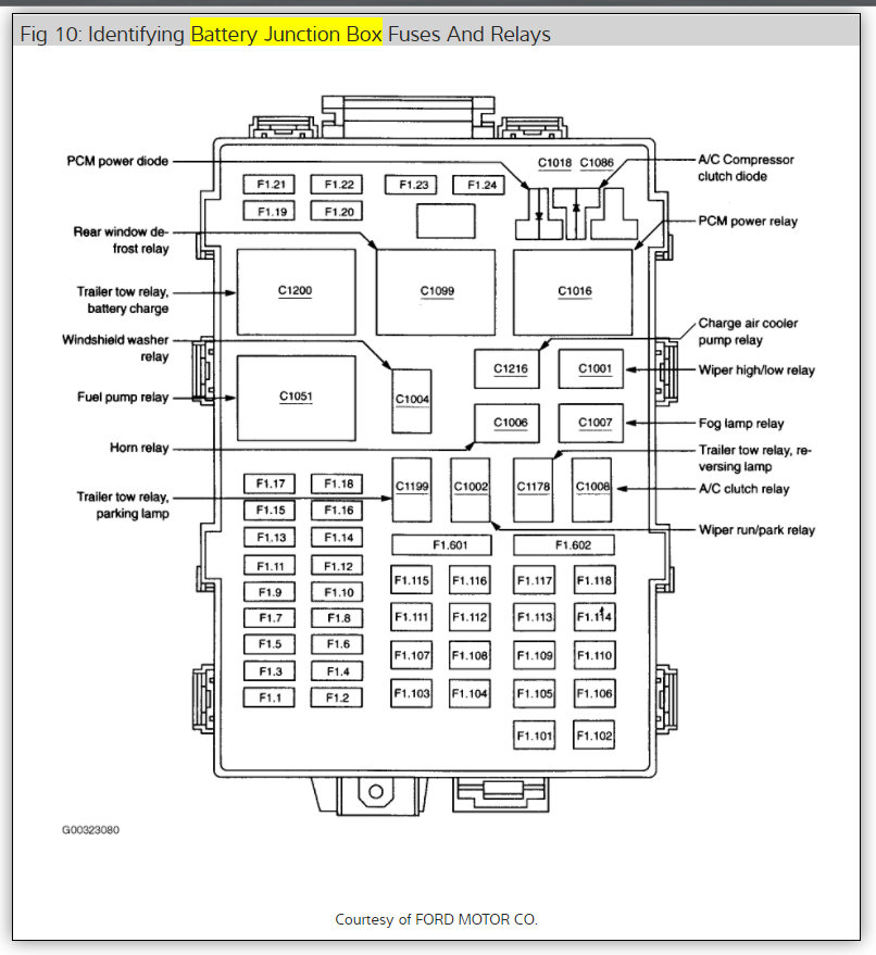

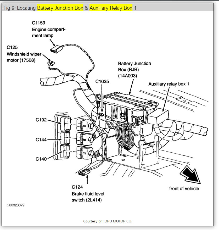

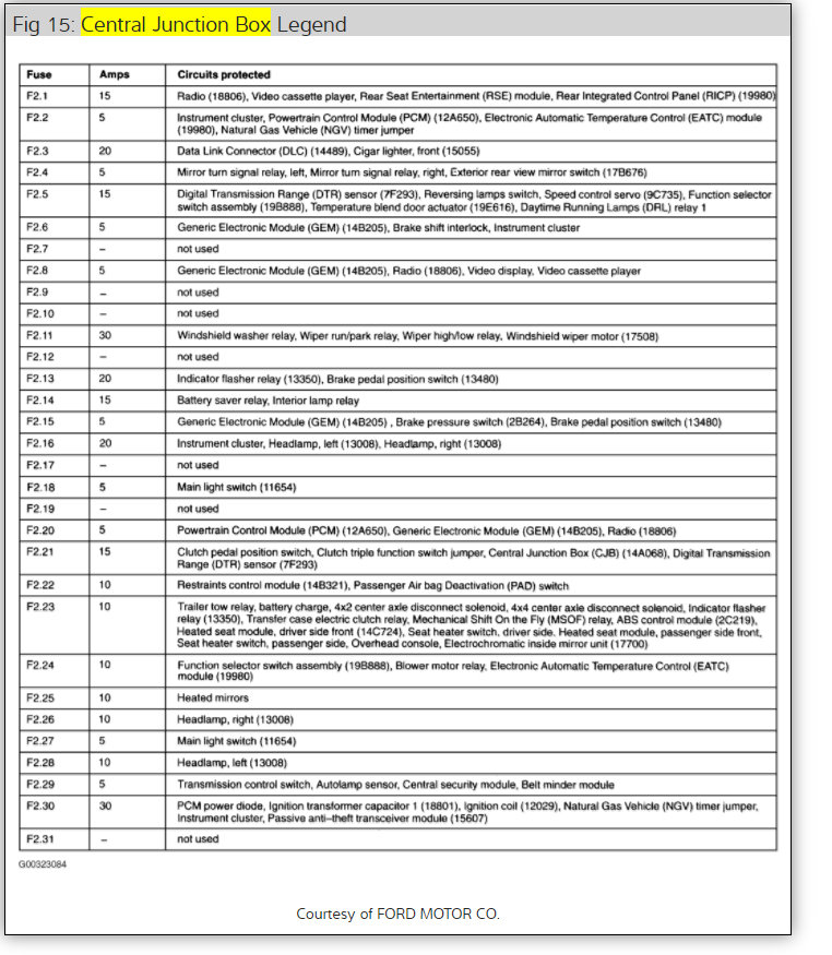

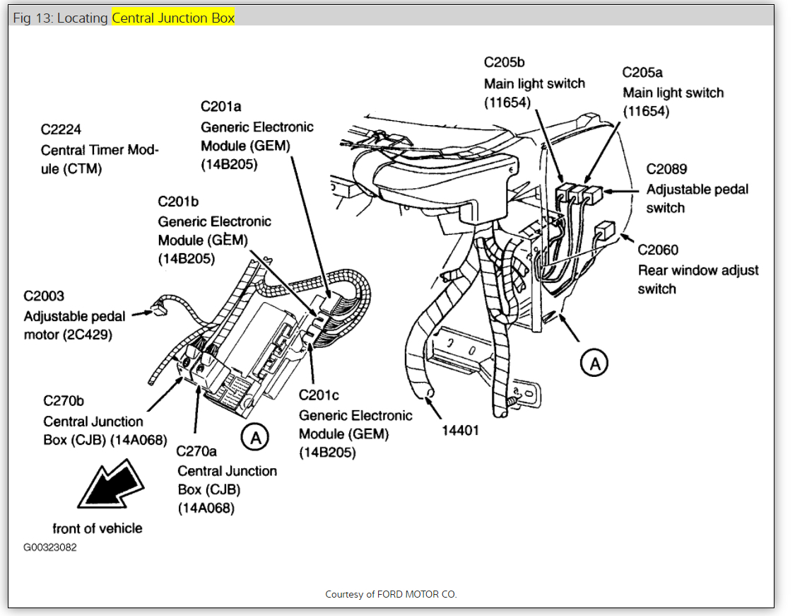

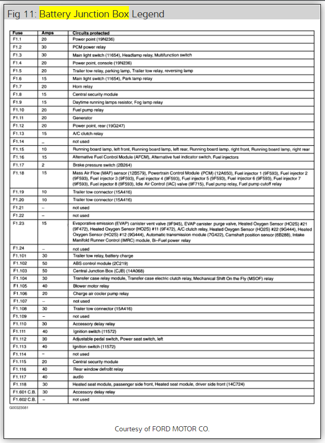

I was installing an LED light bar today when I accidentally touched the positive terminal on the battery while the wrench was on the ground screw. now my gauge cluster is showing the e-brake light thesis light and the maintenance now light and the check engine light are on and the truck is running like it is missing.
Feb 18, 2018 at 1:28 PM
  • 55,721 POSTS
Start by checking all fuses here is a guide to help you see what you are in for
Here are the fuse panel locations and identifications
Also run the codes to see what comes up

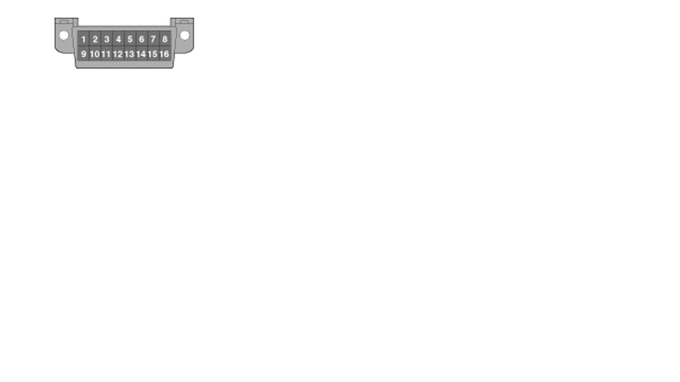

I have a check engine light comes on once in a while, mostly in cold weather. I have been able to read then erase with my scanner. Now my scanner won't work on my truck. It works on others. Could I have a bad pcm that isn't sending out the codes?
Thanks for your help.
Sep 9, 2020 at 10:31 AM (Merged)
JDL
  • 16,098 POSTS
Pin 16 at the datalink connector, does it have voltage? Hot all the time.
GSLRIDER
I'll have to check. What should I read, 12volts?
JDL
  • 16,098 POSTS
close to battery voltage.

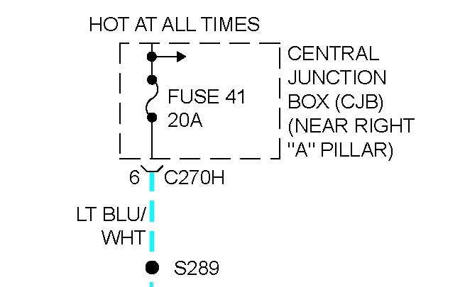

PADA4140
  • 8 POSTS
No OBD on my 2004 F150,Tritron 4.6. Truck has 55000 miles on it.When you hook up the OBD it reads not reading data,please try again. I have had several attempts to bring this Truck to repair places but they cannot help. The Check Engine Lite is on but I cannot read the Computer????? Any help???? It was at the Dealer last year for an EGR valve and came on again just recently. I cannot get it smogged . Thanks.....
MIKE H R
  • 3,094 POSTS
Has the battery been disconnected lately?
PADA4140
  • 8 POSTS
No the battery is the original, the Truck sits most of the time....Thanks
MIKE H R
  • 3,094 POSTS
if the battery went dead or the battery has been disconnected, the computer will not completly reset until the vehicle has been driven appox 50 miles. disconnect the battery and let it sit for about 10 minutes. then reconnect the battery and drive the vehicle. it does not have to be done all at once. the computer should reset itself thenafter it has been driven, if the battery is disconnected and then tried to scan sometimes it will come up not ready or can not read .
PADA4140
  • 8 POSTS
The battery never has gone dead. I disconnected it for 15 minutes and them drove it to work and back (60) miles. I still cannot read the OBD, it says not communicating when we hook it up.......Thanks
MIKE H R
  • 3,094 POSTS
check the connecting pins for the obd to see if one is bent.
Sep 9, 2020 at 10:32 AM (Merged)
PADA4140
  • 8 POSTS
I CHECKED THE PINS AND THE FUSES UNDER THE HOOD, EVERYTHING SEEMS TO BE OK, I GUESS MY NEXT STEP IS THE DEALER, SEEMS NO ONE HAS THE ANSWER THIS ONE....Thanks....Paul Anania
MERLIN2021
  • 17,250 POSTS
I can't find the diagram right now but google obdII and get the diagram that shows the connector and the pins...check for the power and ground pins and check them both!
NOS
  • 320 POSTS
well there is a fella that is dicourged. Have you check the main body ground at the battery? just a question grounds are real important on fords 8) NOS
PADA4140
  • 8 POSTS
I am at my wits end on this Truck, the pin has power the grounds seem good, the check engine lite remains on and this Truck has been to the dealer 3x for check engine lite, every time it cost me at least $300 for repairs. Last time the EGR valve went bad. I bought an OBD to do the work myself and its possible that the last time ity was at the dealer, they did something to the pin???? In any case its going to a different Ford dealer....Thanks for the help.ps do you want to buy a cheap 2004????? just kiddin
NOS
  • 320 POSTS
it is possible that the computer went south on the diagnosis part. i have run across some of thoes trucks the still have both ports on them the one under the hood and the OBD II when the OBDII wouldn't work the other one would.( just a thought )darn things can get agervating.and on a deal like this one not being there makes it harder to figure out. does the truck run poorly? i have seen a simple thing like a vaccum leak bring on a check engine light.well anyway good luck and sorry we couldn't help with this one 8) NOS
https://images.2carpros.com/forum/automotive_pictures/10147_tri_3.jpg
PADA4140
  • 8 POSTS
No truck runs great other than the check engine lite, I will keep you in the loop after the dealer repairs....Thanks Again........
PADA4140
  • 8 POSTS
Ok, took my truck to the dealer,he said that the 04 and 05 F150 has a (KAN)? TYPE READER for the computer that wont read the OBD11?????They said they read the codes fine. The check engine lite was a fuel pressure sensor (line) ? THAT cost $348 bucks. I tried my OBD11 again after I picked up the truck and it still wont read. Is there a OBD that works on my 04????? Thanks....Paul Anania
PADA4140
  • 8 POSTS
Thanks for everyones help in solving my OBD 11 reader,please inforn your readers that the current OBD 11 will not read correct on the 04 and 05 F 150 Pick Up Trucks. But a Can reader will do the job.......Thanks again....Paul Anania
